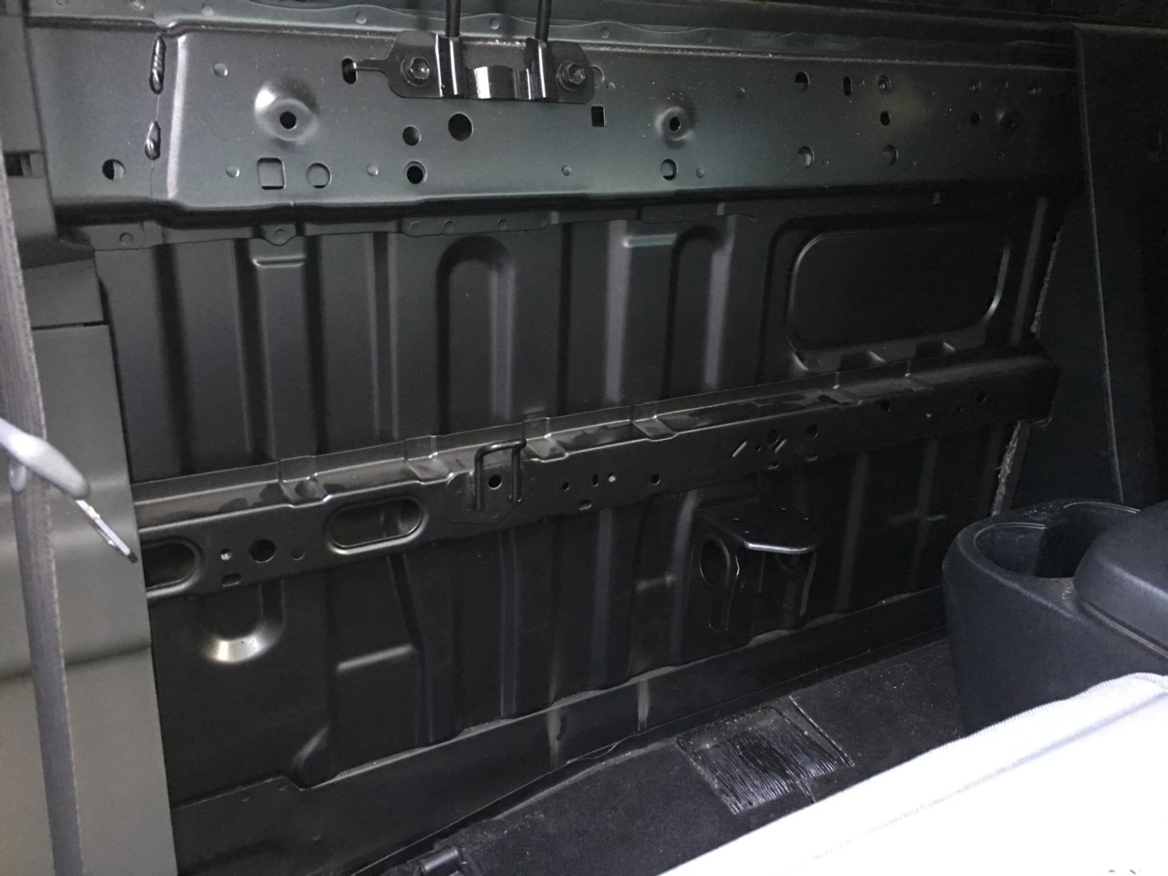

    Hey TW,
    Looking for any advice on storage solution for behind the seat on a regular cab. I understand that it may limit the amount I can slide the seat back, but Im only 5'10 with short legs so I have it decently forward...
    I really like something like the image below, but cant seem to find anything.
    Please advise/ Thanks!
    **** UPDATE 3/11/18***
    I successfuly purchased the rear pannels from a 2009 DCSB from offer up for 35 bucks and installed them into my 2011 regular cab.
    Some Notes because I could not find this information in a search:
    • This is nearly a direct fit.
    • The clips on the pannels snap into the existing holes in the sheetmetal.
    • The holes for the M6x1 fasteners line right up.
    • The seat still slides back all the way without any interference from the panels.
    • There are no panel gaps EXCPT near the top corners of the cubby pannels.
      • I expect this to be resolved with some light trimming.
    • YOU MUST REMOVE:
      • Middle seatbelt
      • Child seat restriants
      • Bottle Jack Mount
      • Tool Kit with rubber strap
    I have only taken one picture so far, but I will take more when I remove them to install some sound deading materials behind it...

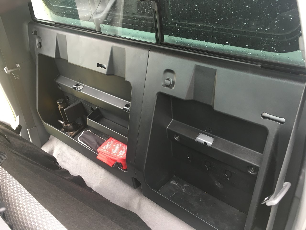

    Update, I successfuly purchased the rear pannels from a 2009 DCSB from offer up for 35 bucks and installed them into my 2011 regular cab.
    • YOU MUST REMOVE:
      • Middle seatbelt
      • Bottle Jack Mount

    How did you remove the bottle jack mount? It seems to be welded on.
  13. Aug 31, 2018 at 11:44 PM
    nosfanatic2006
    nosfanatic2006 Well-Known Member
    May 17, 2015
    #155471
    203
    Jeff
    2004 Xtracab 3.4 5speed
    A few posts up someone mentioned drilling out the rivets
    greymac[QUOTED] likes this.

    You can wrangle the jack bracket off with some prying and pulling, no drilling required. It is just a few spot welds, easy to break them free.
