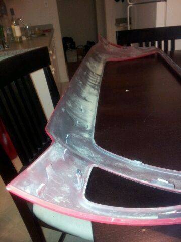

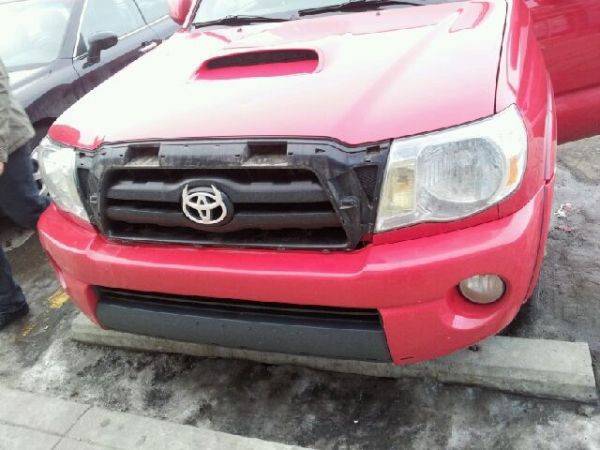

    Alrighty, so I've discovered a problem structurally with the stock grills, looking for your input on how to reinforce the grill, mostly because I don't want the same thing happening to zee sexy custom one.
    What Happened: My Tacoma frequents speeds slightly higher then your average Tacoma, Always on closed course roads in Mexico, and hypothetically speaking usually in the 200+km/h range. So the wind forces cause such a beating on the front that it actually peeled off the front colour surround from the back structural plastic section. (I think there's like 25ish connection spots)
    At said hypothetical speeds, the top left (passenger side) started to peel, I heard a loud snap and as I started to slow I heard SNAP SNAP SNAP like a dozen times in a row, until finally I came to a stop, and the grill colour surround was only being held on by about 4 support points on the lower right (drivers side)
    I've heard of this happening a couple times over on X-Ru.com as well. As you can see in the pic below all the snapped bracing points. I was thinking using a little bit of hot glue on all the points since I'll never have to actually seperate the grill and surround piece. Just wondering what your idea on this would be, I don't want to accidently ruin the good one.

    you are pretty much spot on though.
    I'm not sure about additional epoxy being of help but if our OP of this thread had expressed these "high speed" concerns with me PRIOR to the build I could have made some custom reinforcements that would have eliminated the possibility of this ever happening again... :cool:
    I doubt it will as the heat welds I perform are more thorough than the OEM assembly line ones. :D
    You would notice if you look carefully at the back of one of my grills that there are only two places where i do not melt the tabs back. On the OEM grills I have found some are only partially melted. ;)

    BTW - It looks like someone punched your truck in the nose... :laughing:

    Wait, you mean the front colour surround is already plastic welded in place??
    And If had broke earlier then I could've warned you :( I myself just learned of this issue on saturday

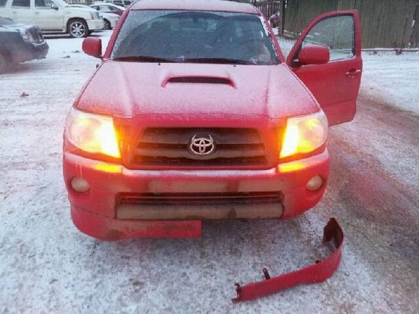

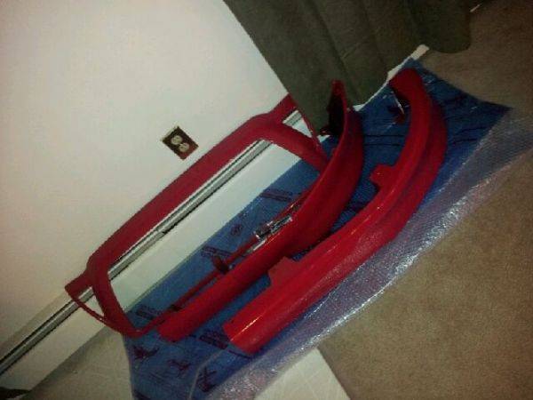

    I hit a tree a month ago hidden in the snow drift on the road, caused this:
    But new parts are on my living room floor, just waiting on the clips toyota forgot to order :rolleyes:
