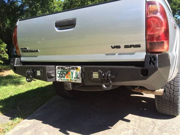

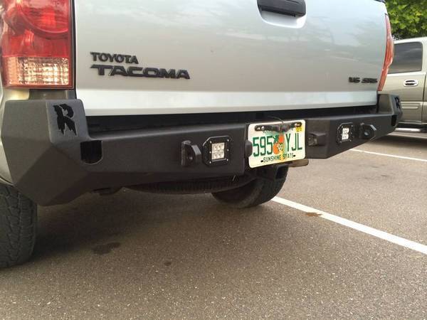

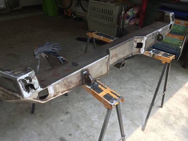

    Wanted to post some Pics of my bumper now that it's done.
    I chose the weld it yourself kit (it helps when you have a buddy who is a retired welder).
