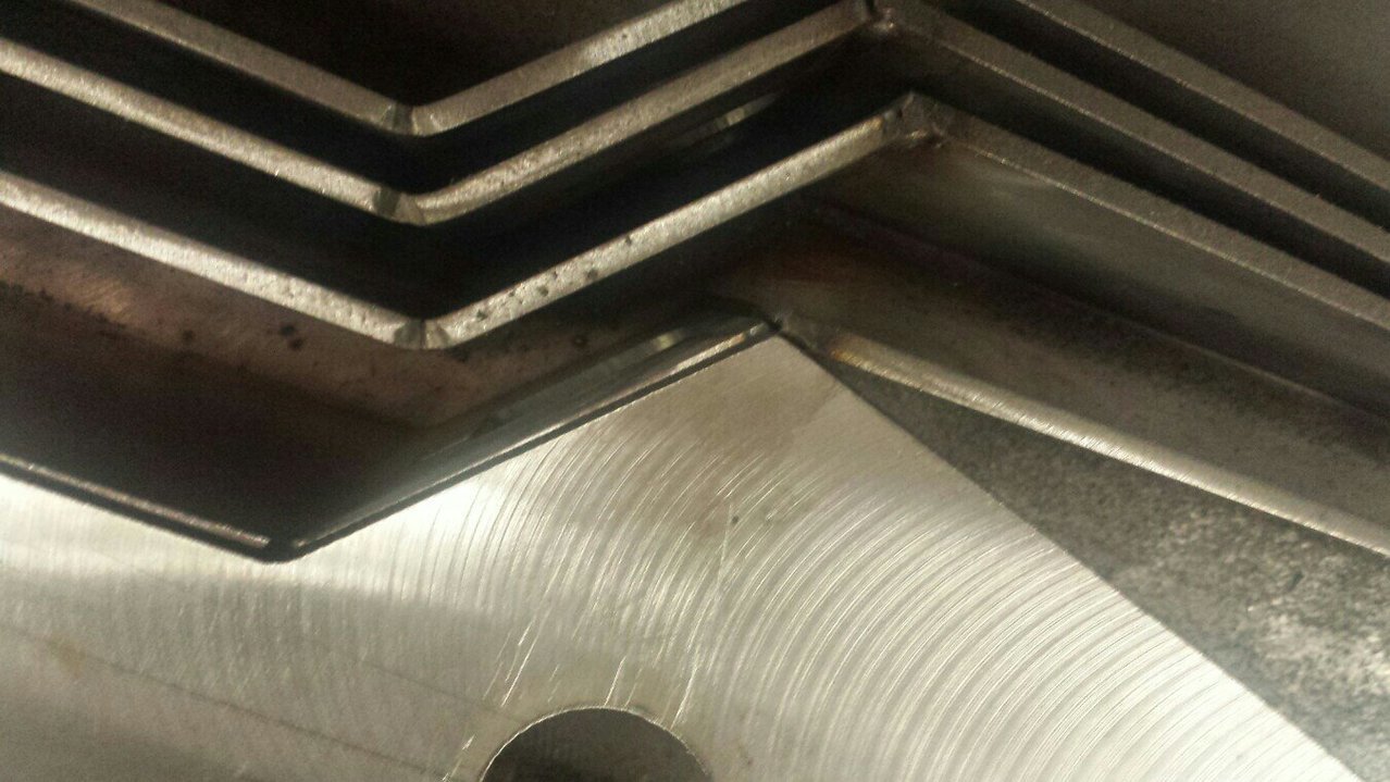

    ok. so I have had the kit here for a while and am finally looking at getting it assembled. I have one question, as it is the first step that is key. When taking the large bottom plate and lining it up for welding, does it go BEHIND the main structure, or does it lay on top of it? This makes for a full 3/16" difference in how it goes together, thus the reason I am asking.

    The 'corners' of the bottom plate where they wrap around the license recess portion meet the main face of the bumper should sit even with the back edge of the main plate. That allows room for the large bottom triangles to meet the 2 pieces without lapping over the edge of the main plate or sitting on top of that large bottom plate. Hope that makes sense Bill. I can snap a pic if needed

    EXACTLY what I was wanting to know! Thank you Eric!
