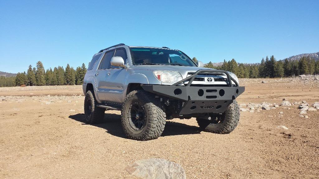

    I already have a 3rd gen 'runner! (it's currently stripped of its' bumpers and skids though :spy:
    And we've got a 4th gen as my GF's Daily

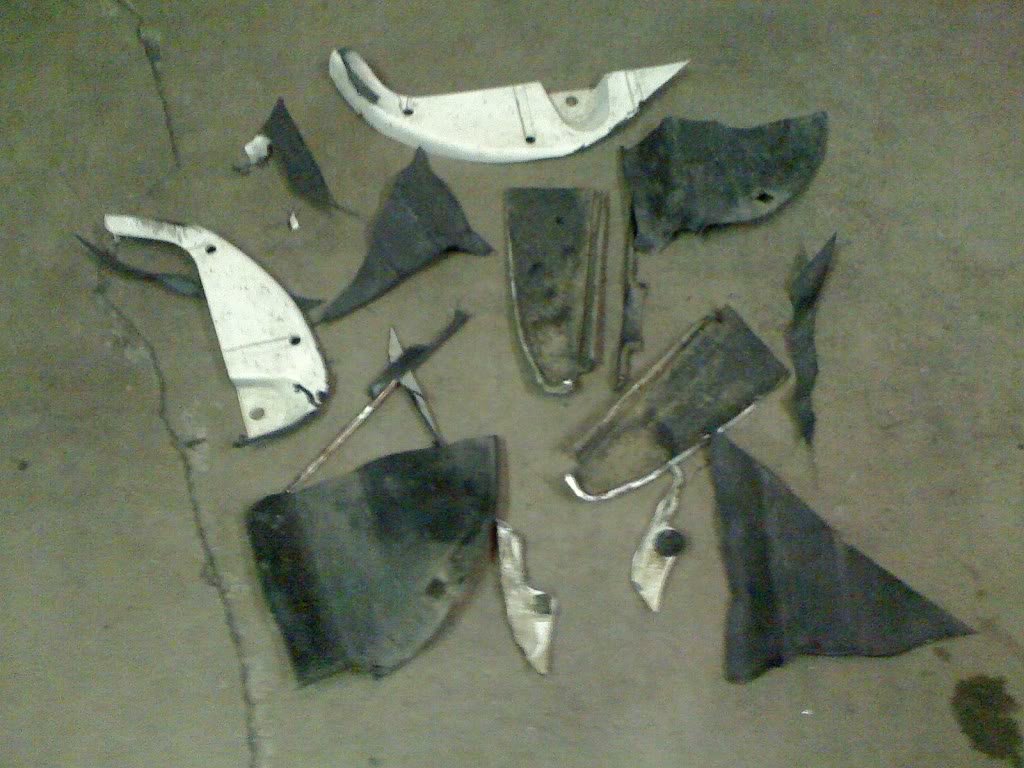

    relentless taco, im wondering if after you cut off the sheet metal if you have to redrill all the mounting holes in the fender or what you did there?

    factory clips were left on the flares, and the factory holes in the sheetmetal which correspond were left in the sheetmetal were left as well. Within the inside of the fender flares, the metal strips that were cut and bent in were redrilled for the couple of mounting holes on the lip of the flare. I've seen flares cut and then just attached with just the clips rather than have the lip bonded back to the flare and screwed into the sheetmetal but the clips break rather easily without the support of the screws into the sheetmetal
