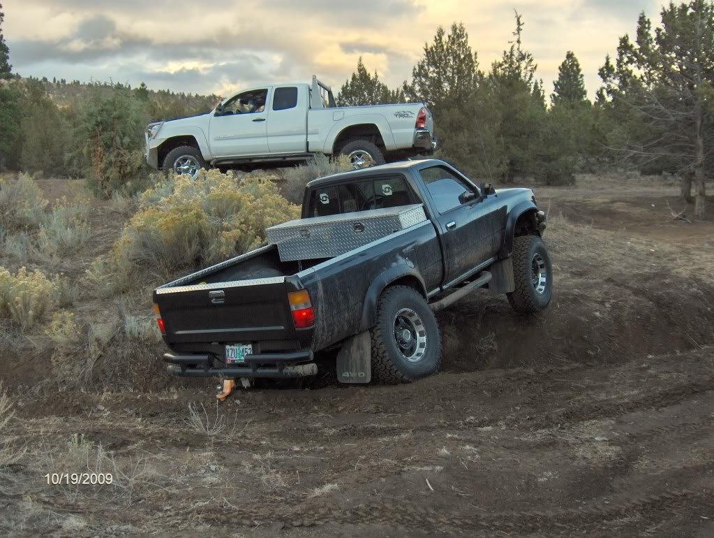

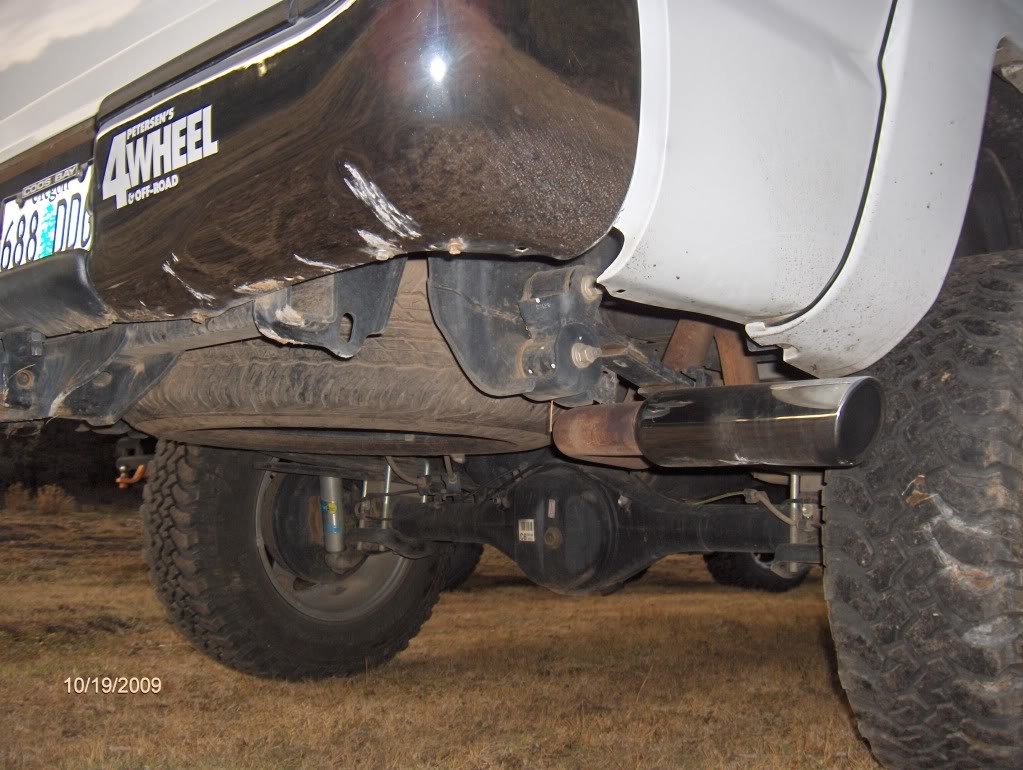

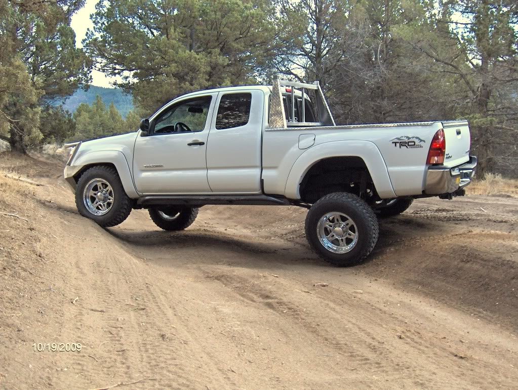

    Here are just a few pics from 'wheelin the other day when I got an unexpected mod...... Managed to get some rock rash from a dry creek bed! :eek:

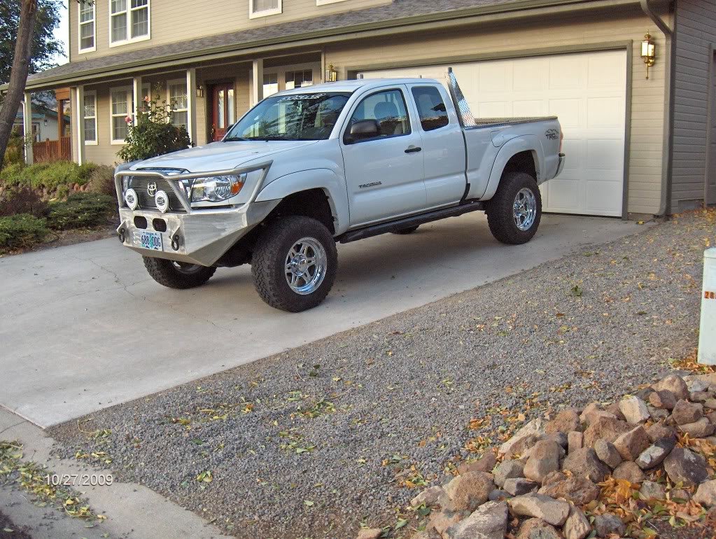

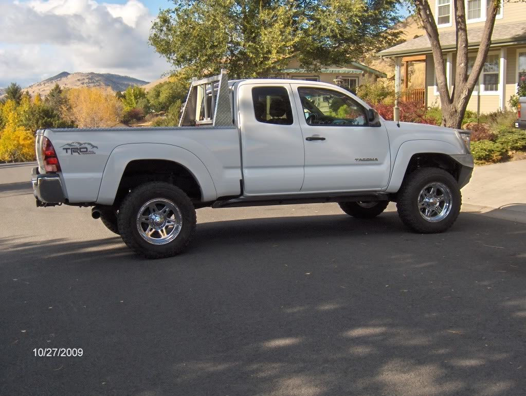

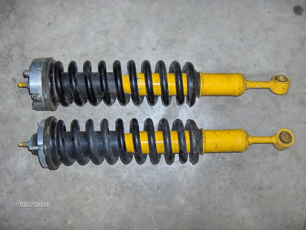

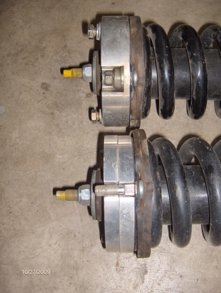

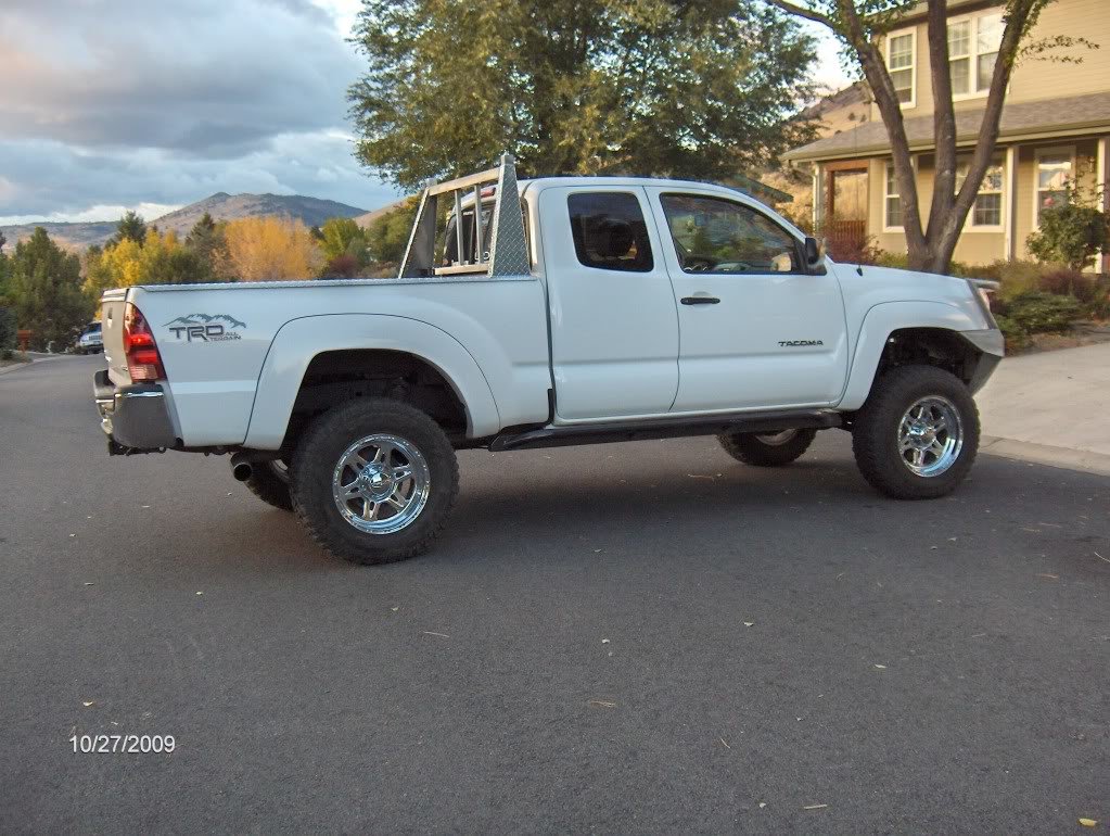

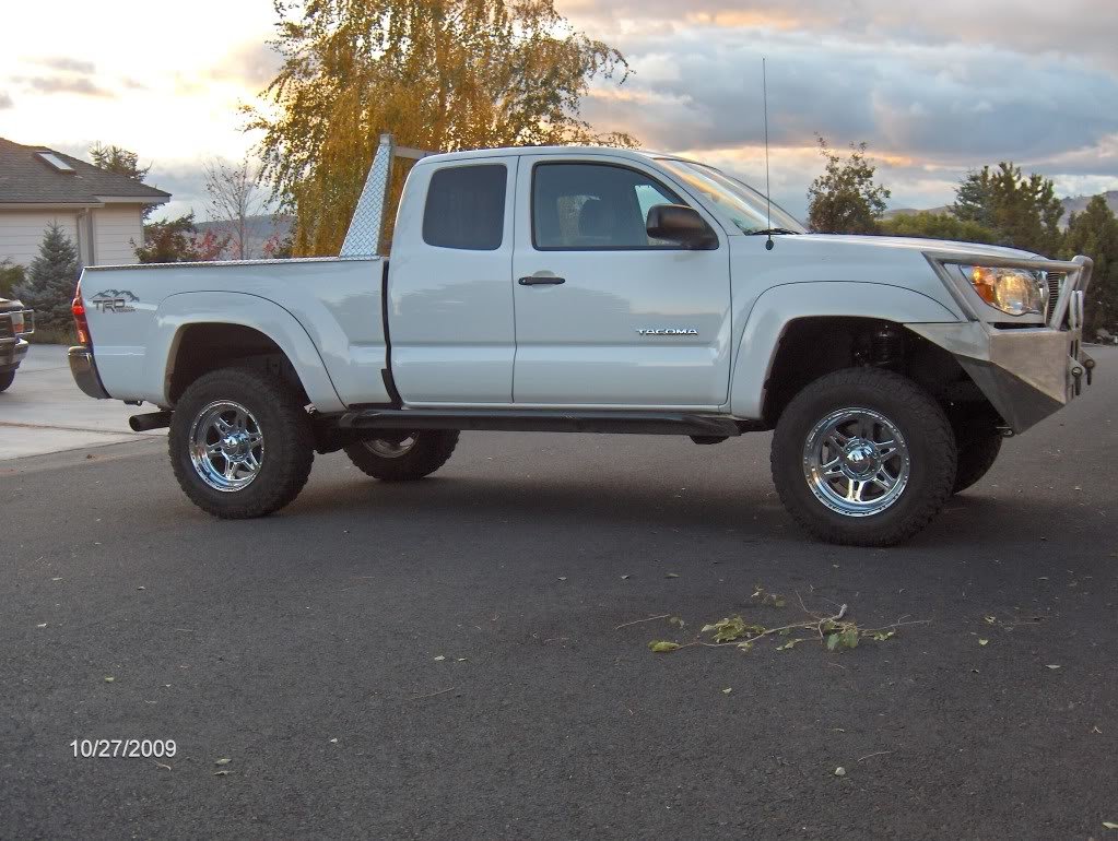

    Well, since the OME885's I got ended up saggin about an inch, my truck only sat a 2.25" lift with the OME top spacer and that wasnt high enough compared to the rear of my truck. So, today I finally remedied it until I can afford some adjustable Coil overs. What I came up with was taking the 3" lift billet aluminum top plate spacers from my old lift, and machining them down to give around 1.25-1.5" of lift and swapping them with the 1/2" OME spacers. Turned out pretty good, though maybe just a tad too high(sittin at about 3.25-3.5" lift without the winch on). Looks awesome though.
    Here is a pic showing the comparison of the strut with the OME spacer, and then the other with my custom spacer on top.
    This pic shows the size of the custom spacer compared to the 2 toytec's stacked. About the same, maybe an 1/8th inch larger.
    Heres a before pic in front of the house:
    Heres the after pics in front of the house:
    Now I just need to get it realigned at les schwabs. Got an appt set up for friday morning.

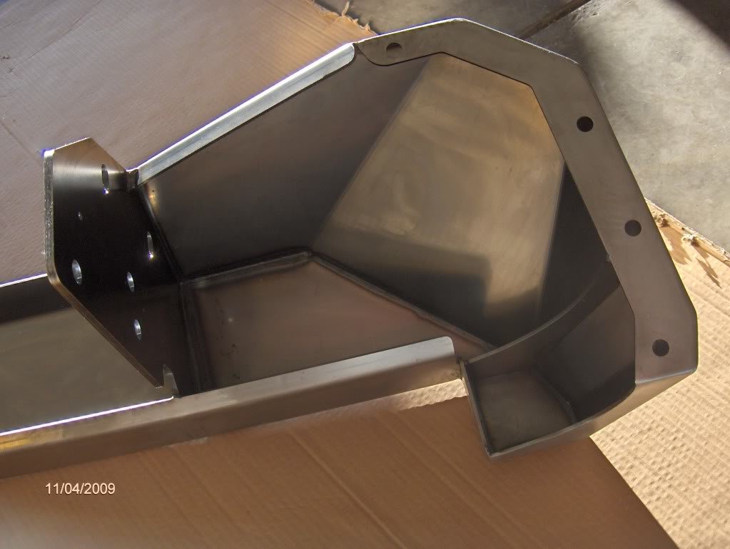

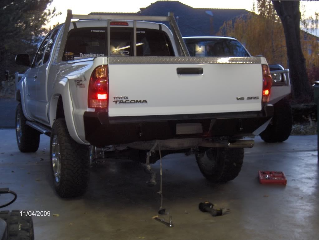

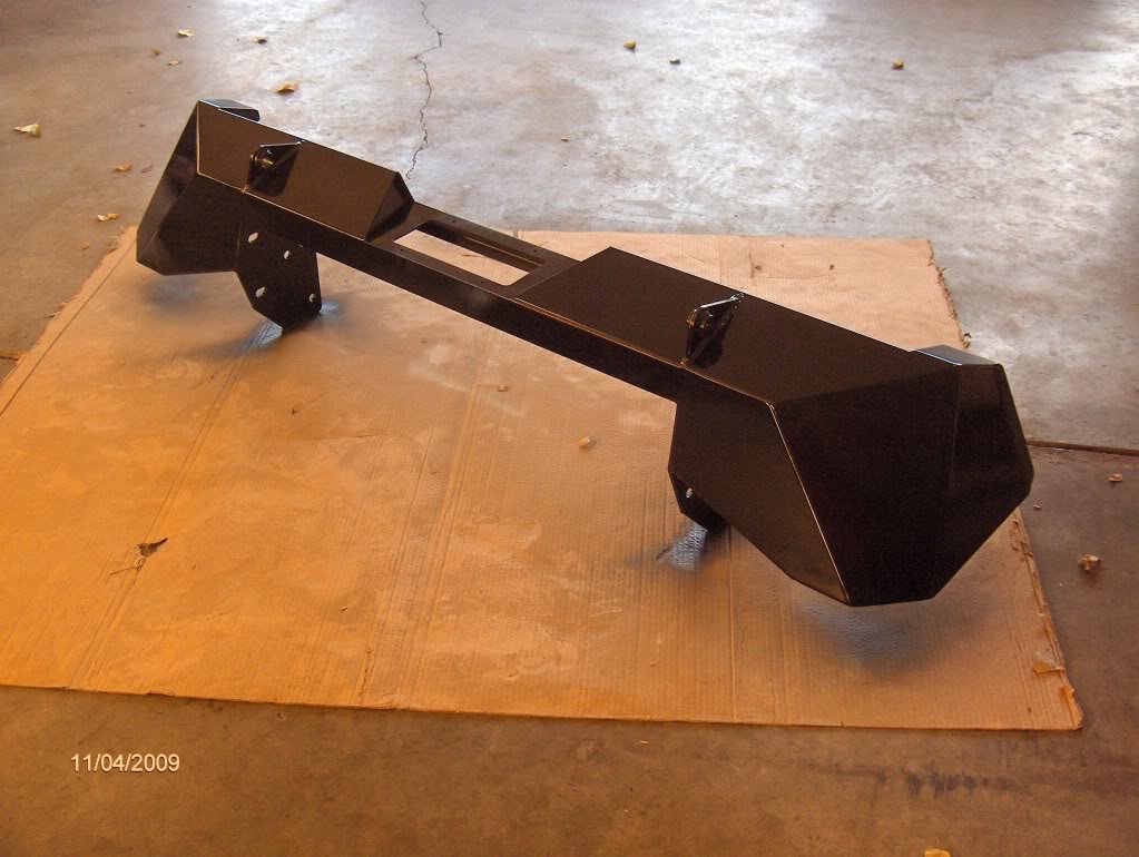

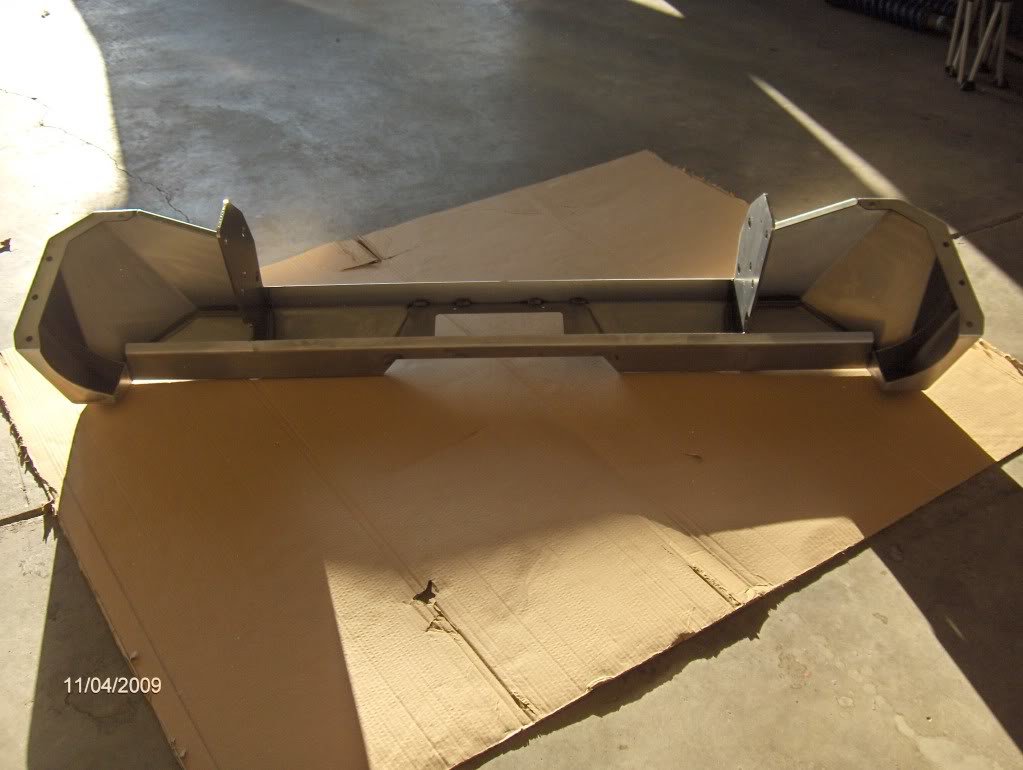

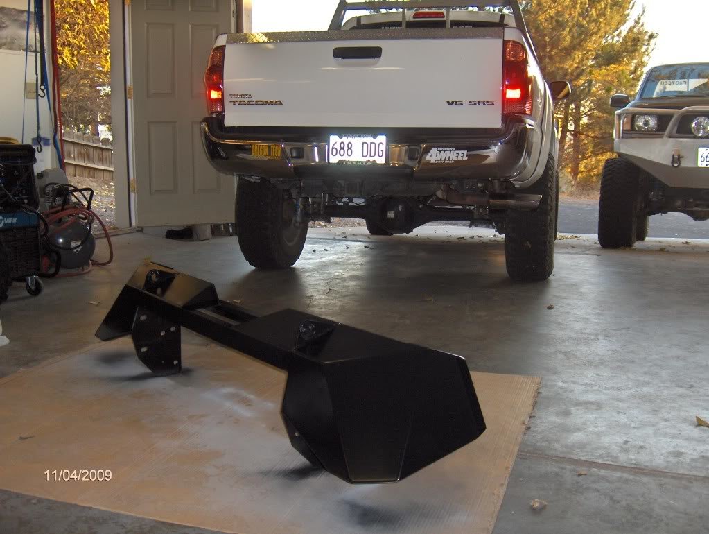

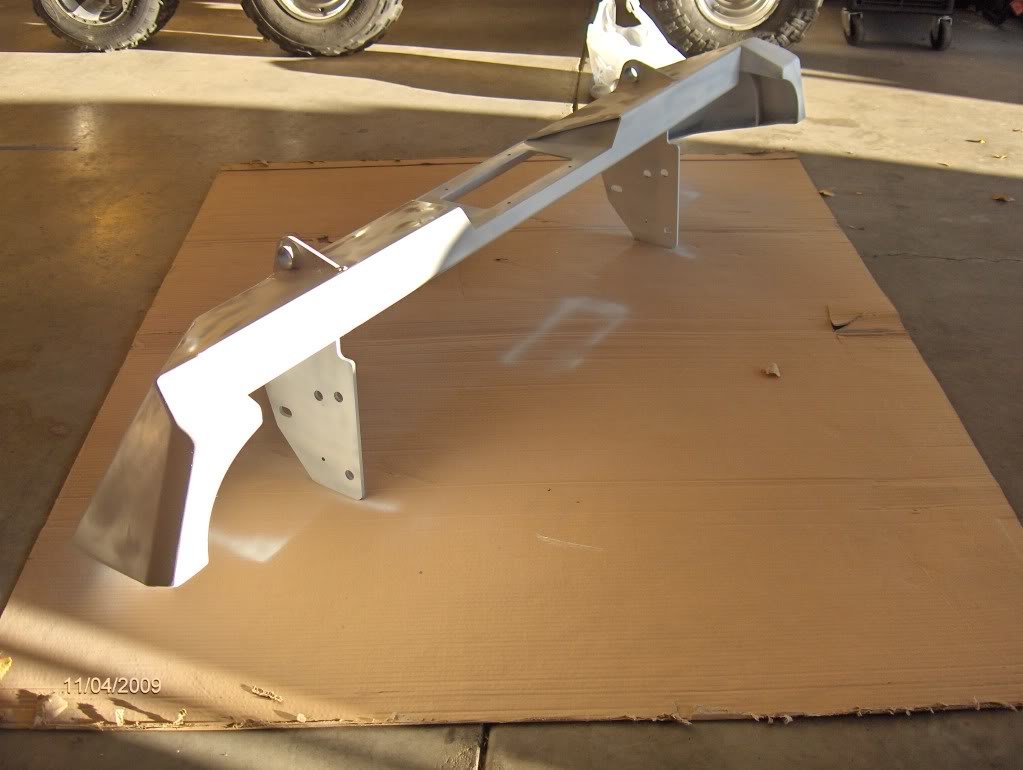

    got my All Pro rear plate bumper this afternoon:
    A few raw metal detail pics after prepping for primer:
    Primed:
    Painted:
    Finally on the truck:
    I mounted my licence plate after that pic, and now im just waiting on my side wraps to come and im in business :)

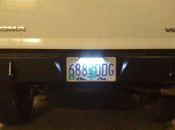

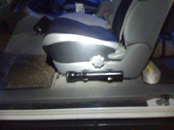

    did some more this afternoon: (sorry for the low res, snapped these a few minutes ago w/ my iPhone.
    LED license plate light
    blue LED interior light
    mounted my 2 LED maglites on the front seats
