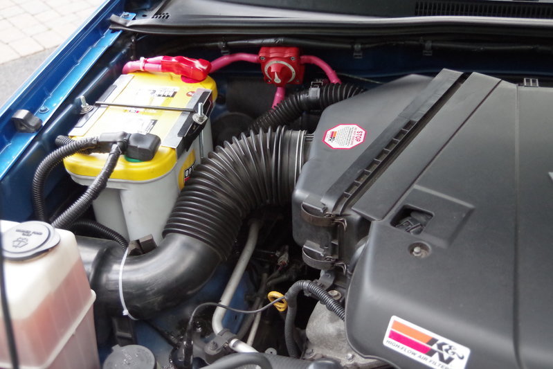

    Thanks! I am wanting to get around the braking system. I like the look of the one mounted up front, looks like they used factory air duct

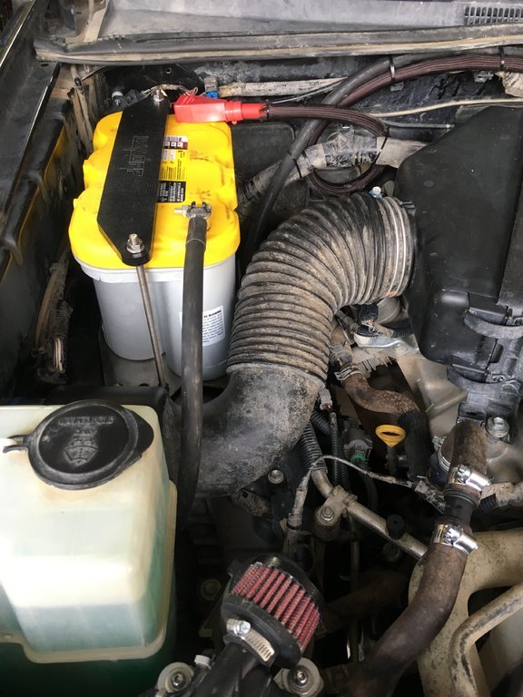

    There is no reason to love the stock location. I'd argue that putting it inside the cab isn't ideal (but doable for sure). In any case, moving it from the front left is a good idea. At least flip the layout to balance the weight. Moving it to the firewall, bed, under the body, all great options. The one and only reason the stock location is OK is it's easy to get to if you have an emergency disconnect at the terminals.
    I put dual batteries in the stock location because I'm lazy and didn't want to try and rewire it or move the my ABS actuator. But it's a terrible location and for some reason Toyota for decades insisted on putting the battery way out there.

    Yes, but you have to relocate the PS pump, and, I believe, replace one or both hoses with longer ones. On the upside, I believe the metal below is sturdier than the battery on top of the wheel well. I found it much easier replacing the OEM air duct.

    It mounts in the factory location and that's where the OP is looking to move the battery from.

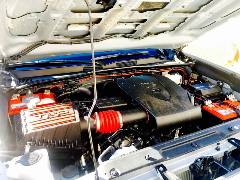

    All the metal under my stock battery location broke up, so I moved it to the passenger side near the firewall. Had to relocate the damn smog pump. Group 27.

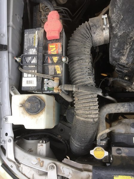

    I've got the camburg battery tray mounted in the stock location right now.
