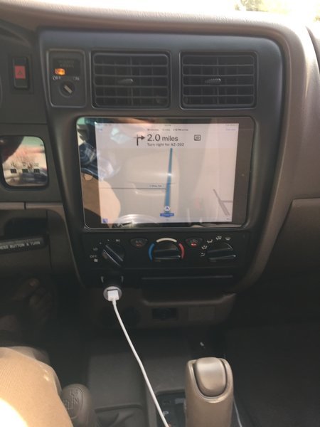

    Would you be willing to share your 3D file?

    To anyone interested in this, look at the thread I created. I made a similar bezel that uses a double din media player instead of an IPad. I am beginning to gauge if anyone would like to purchase one. I will make a limited supply when I get a count on how many people would be interested.

    i would be interested, but it seems like a standard double din may not fit depth wise, would need the low profile like the alpine?

    correct you need a double din that is maximum 5.5”. Because of the anti sway/support pipe running through the dash. The Alpine unit I got is very shallow at 2-13/16” deep. But there are other brands that make shallow mount units. Look for a multimedia player, they do not have the ability to play CDs but I don’t know the last time I used a CD so didn’t matter to me.

    yeah, i do have a pioneer avh4200 but have not once used the cd player lol. I guess i could sell it and get a new unit.
    How much would you sell them for?
