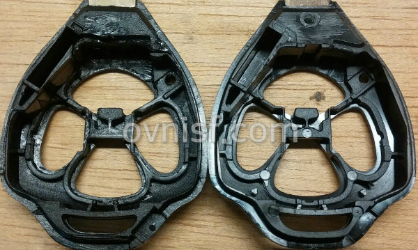

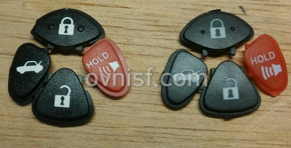

    Here are pictures of the cheaper shells and the newly engineered(no logo) shells I have.
    Right is new design
    Left is new designed buttons
