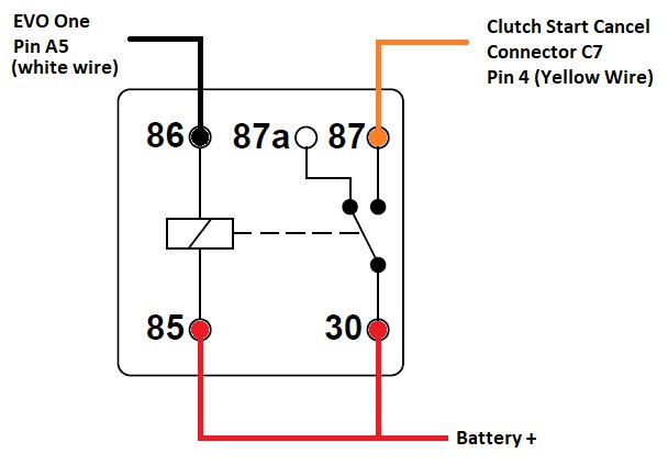

    I’ll make up a diagram this evening and post it up with more details. I had to figure it out myself but this is the basic description. First is don’t cut the yellow loop, that tells the evo one manual trans. mode. Then you’ll need to program the ready mode option (prevents starting in gear), then there is a wire on the evo one that provides a ground output at startup which needs a relay to change it to positive and then that connects to the clutch start system, I connected at the harness on the clutch start cancel switch.

    Apparently you know Fortin's system better than they do. Can you give us some more direction on your working setup?
    Is the ground wire you're talking about in the main power connector or on the red bypass relay connector with the TPMS wires?
    What kind of relay did you use?
    Can you give us the pin location to the wire you tapped into on the Clutch Start Cancel button?

  11. Nov 28, 2017 at 3:38 PM
    #31
    Pickupman2007
    Pickupman2007 Well-Known Member
    Mar 27, 2016
    #182547
    586
    Kenneth
    Murfreesboro, TN
    2022 Rivian R1T
    2020 Tacoma: Morimoto xB LED Headlights & fogs, MESO Total Tail S1, Fortin Evo One Remote Start, OEM Audio Plus System 500Q,, Redarc trailer brake controller, Carplay2Air wireless adapter, Custom shift knob, Electric tailgate lock, Chrome tailgate inserts, Limited fog light bezels, 2018 TRDOR Grill, Chrome door handle covers
    OK, here it is:
    To install the Fortin EVO One on a MT Tacoma, follow Fortin's directions except for don't cut the yellow loop wire on the EVO One, that tells the EVO One it's a manual transmission. Then you need to pick a ready mode activation method, Fortin describes both options in the users manual. The default option 33.1 requires a remote with a start button, so if your using the 3x lock on the OEM remote you need to change the ready mode option to 33.2, this can be done with the Fortin Flash Link. With option 33.2 automatic activation of ready mode, you have to park in neutral, apply the hand brake, release the foot brake, remove the key (engine will keep running) and exit the vehicle, the engine will stop when you close the door. Your truck is now ready to remote start, if you open a door or the hood ready mode will cancel, this is so you can't start the truck in gear. What Fortin left out of the directions is that you must use a relay to bypass the clutch start system or it will not crank. To do this the EVO One has a starter output wire in the 20 pin white connector pin A5, I used a 5 pin relay since I had some, but a 4 pin is all you need. Battery power connects to the relay coil and pin 30, then white wire from EVO One pin A5 goes to the other side of the relay coil and relay pin 87 goes to clutch start cancel switch connector C7 pin 4. Like this:
    That way when the EVO One turns on the ignition, it also sends a pulse via your relay that tells the truck the clutch pedal or the clutch start cancel button was pressed and it will crank on command from the EVO One.

    With @Pickupman2007's relay method, I believe this is a solid option. Install takes some time to do it on your own but can be super clean. I plan on making an install guide with all the information needed to successfully install the Evo One on a Manual 3rd Gen. I made the mistake of thinking Fortin's 3x Lock feature worked on all 3rd Gen's but that's a push-to-start feature only for our automatic friends. We require purchasing an extra RF kit. Select all brands to list non-Fortin ones too...https://fortin.ca/en/technology/rf_kits.html
