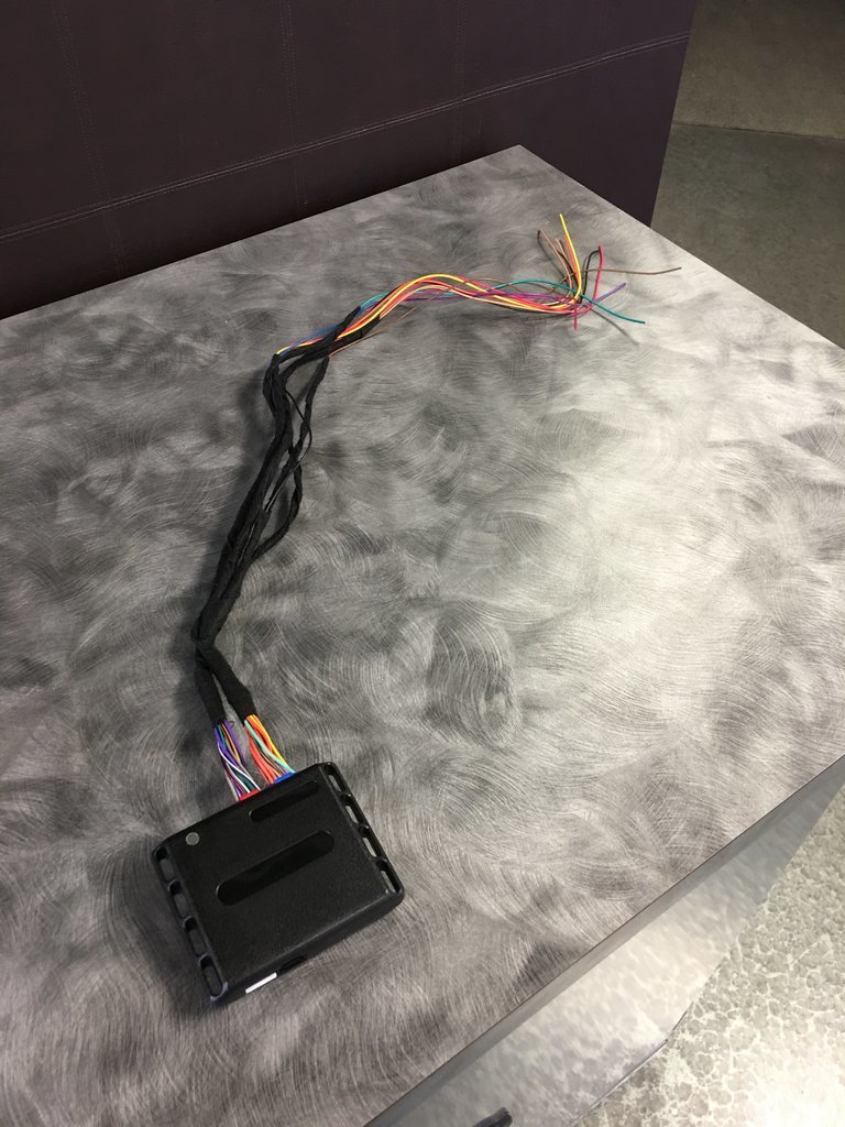

    I used a DEI DBALL2 for RSR (3x lock on the factory remote). Took 20 minutes to do (I install these for a living so for someone with less experience I would say 45-60minutes. It's not plug and play but it's about 10 wires to connect. Hardest part was to get to the PTS connector lol

    That looks exactly like the 12 volt one. It's totally plug in. No cutting or splicing.
