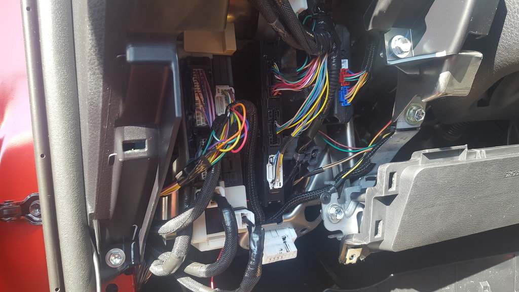

    Ha, I'm actually from down that way, well technically Leland so just across the bridge and my parents still live out near Riegelwood. Heading down that way Friday-Monday for New Years and usually get down a couple times a month. Below is mine. Ended up tidying things up a big more after that picture.

    Is the steering lock connector the wire the instructions have us removing the steering column for? Your saying its the same as C29 pin 23?
  10. Dec 29, 2016 at 7:08 AM
    #170
    PJnc284
    PJnc284 Well-Known Member
    Mar 6, 2012
    #74326
    690
    Garner, NC
    2016 Tacoma TRD Off Road 4x4
    Yes just like the PTS wire runs to the C29 (smart key ecu assembly) pin 16, the SLC wire runs to pin 23 on that same connector. @gpb tested and confirmed our hunch from the service manual and now both of ours are hooked up that way.

    And whats the difference between the two wires? Does the module act differently? they're obviously different wires
  12. Dec 29, 2016 at 7:20 AM
    #172
    gpb
    gpb Well-Known Member
    Aug 24, 2016
    #195408
    6,290
    Atlanta
    2017 White DCSB TRDOR 4x4
    @PJnc284 is correct. The service manual gives a wire harness test procedure that suggested the opportunity for an easier install and I did the test myself to confirm.
    The pins on the smart key ecu are where the wires from the SLC and PTS go to.
    See my post here: https://www.tacomaworld.com/threads...using-oem-remote.463996/page-32#post-13987320
    Feel free to use the original DEI locations if you want, I just figured it'd be easier to use the other end of each wire.

    It's the same wire, same color and everything. Instead of tapping the wires at the PTS or SLC connectors themselves, you're tapping where those wires run to the ecu.

    I prefer to tap the SLC (Steering Lock Control) At the steering column because your tapping directly to the module itself. You can do it either way thats just the way we were tough in school. Its the "safer" way.
