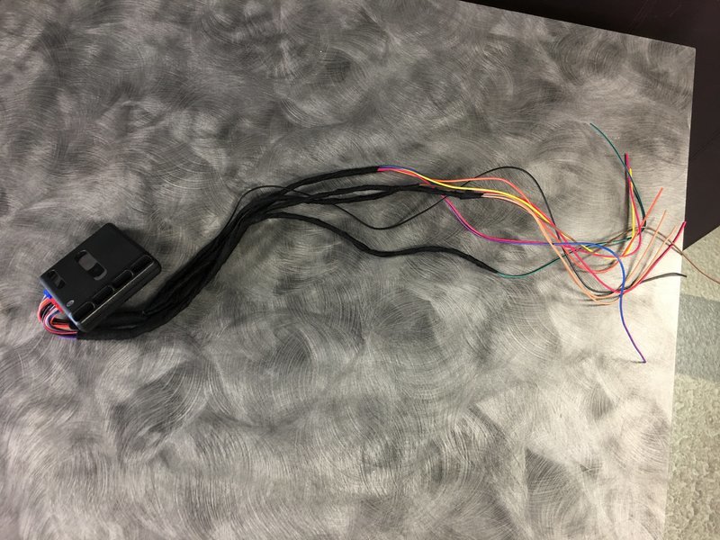

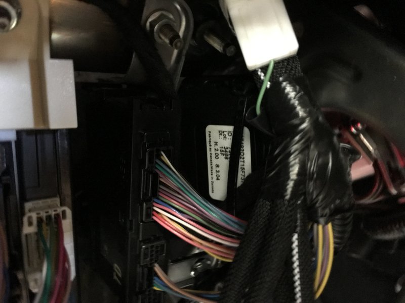

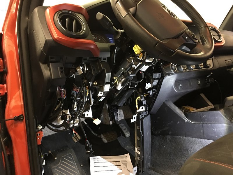

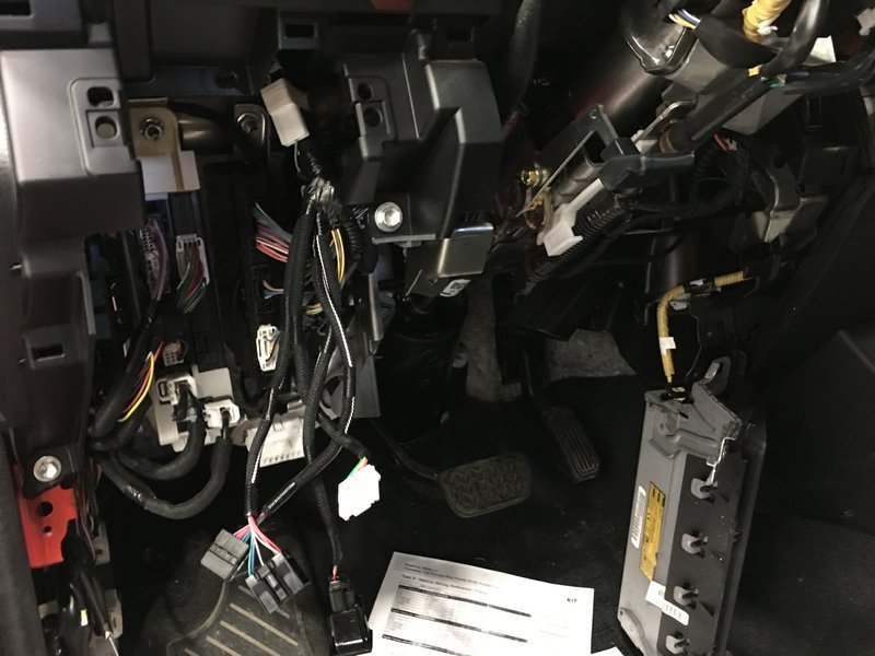

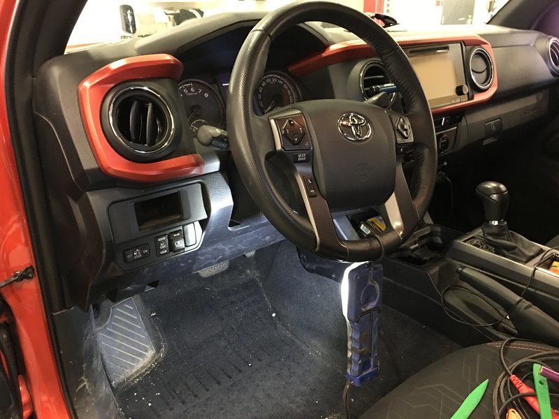

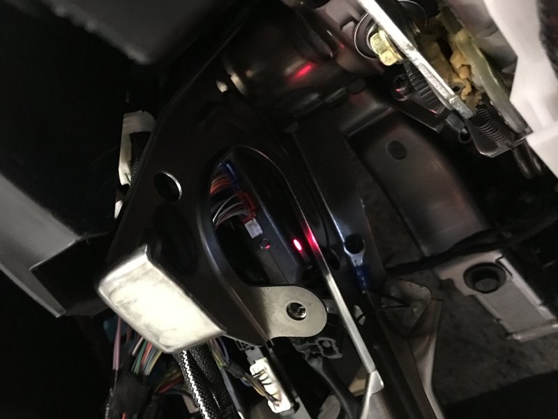

    Long story short. I got laid off from being an electrician due to lack of work. Now back at my old job doing Car Audio work, which means I have the time to install my DBALL2 that was laying around at home. DEI doesn't have the firmware for the D4S which I am waiting on getting from DEI. Super easy Install. Took me roughly 30 minutes to do (not bad considering I haven't done an install in almost a year haha) soldered all the connections and used the lovely Tesa Tape for everything blending it in to give a factory look. Only wire that required cutting was the autolights. Only using the 3X lock from the factory remote for now. Once my D4S shows up I'll be doing the long range 7756V remote add-on.
    IMG_0728.jpg IMG_0730.jpg IMG_0732.jpg IMG_0733.jpg IMG_0734.jpg IMG_0735.jpg
