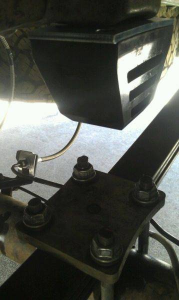

    I searched around on here and couln't find exaclty what I was looking for. My question is pretty simple; Can I mount my stock bumps on the AP expo leafs with the U-bolt flip kit? If possible, how? The plate for the flip kit wasn't drilled for the timbren bumps. So I can't just bolt up the bumps unfortunately without breaking out the drill press.

    And you can tack weld them on.
    ORRRRRRR
    You can buy some daystar bumps for cheap
    http://www.daystarweb.com/productdetail.php?productID=658
    and then do this

    You can permanently JB Weld the bump's backplate to the U-bolt plate. May have to trim the backplate to clear the U-bolt nuts on removal.

    That's what I was thinking, but I am kinda concerned if the JB weld will hold or not going down some washboard road, or if I flex the truck and the chassis hits it at an angle where it will just break it off.

    I wouldn't trust JB weld.......the daystars just bolt up and would be the better way to go for off-roading too!
    I got superbumps and drilled them out but the daystars seem to work well!

    There daystars have abolt and nut on the back connected to the bump stop.
    So i just drilled a hole through the stock bump stop plate and attached it to that

    JB weld does not work. I speak from experience. Shaved down the factory bump stops to fit the flip kit and used a generous amount of JB to hold them down. Went to recheck my U-bolts for torque and the bump stops were missing. I will be getting more and welding them on.

    They have a predrilled u bolt flip kit. You need that and to trim your stock bumps to clear the supplied bolts. That is how I did mine.

    They pre drill the plate if you order the timbren bumps with them. or tell them that you want it predrilled (which I failed to tell them)
