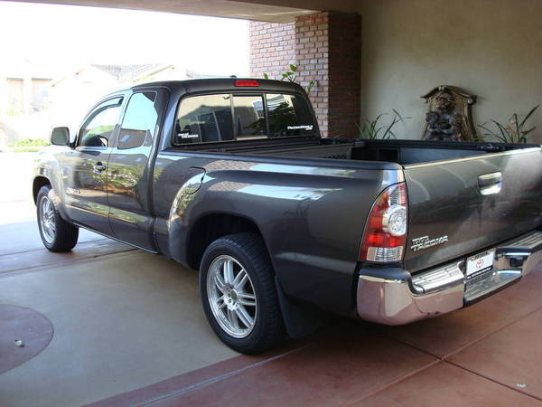

    Edrin55 / 09 Tacoma Access Cab w/ no hitch. This truck is not a PreRunner.
    Before Picture

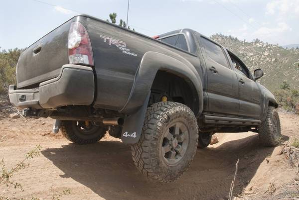

    Rpparkster / 09 Tacoma 4x4 Double Cab
    Before Picture

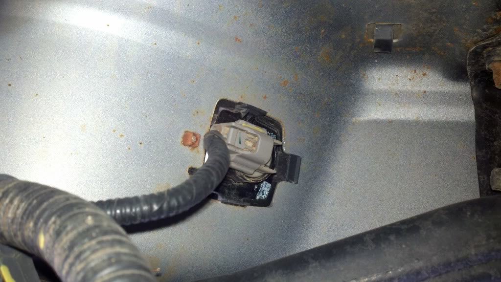

    Before you start, unplug the lights from both sides of the license plate. They should turn down and pull out.

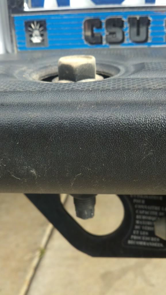

    3/4 Wrench to hold the nut from moving while using the 3/4 socket on the top. This is in the middle of the bumper above the hitch.

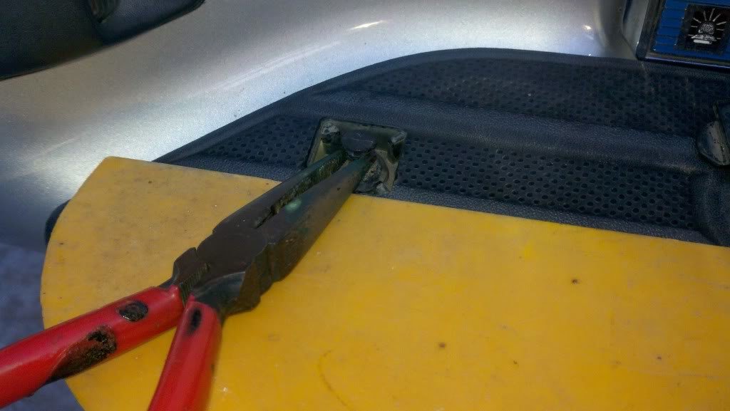

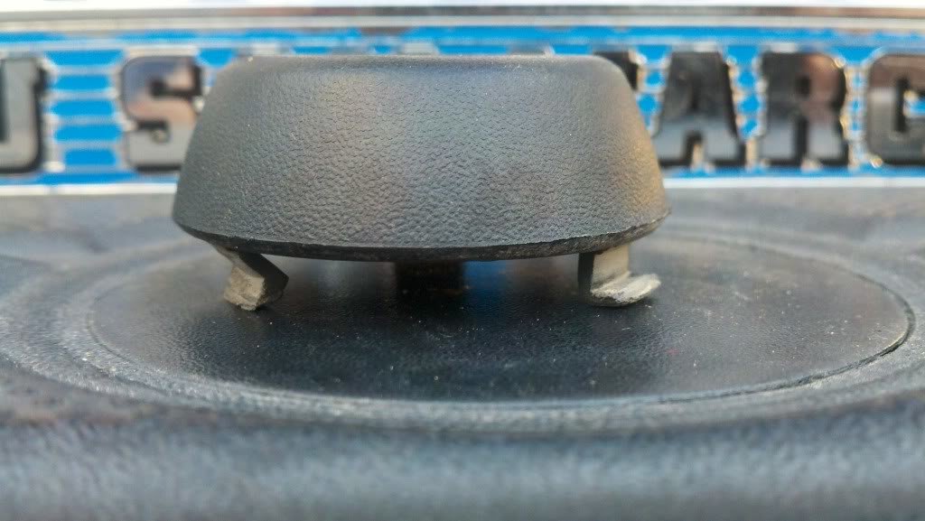

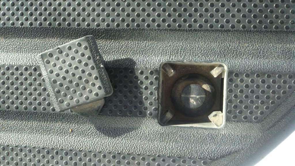

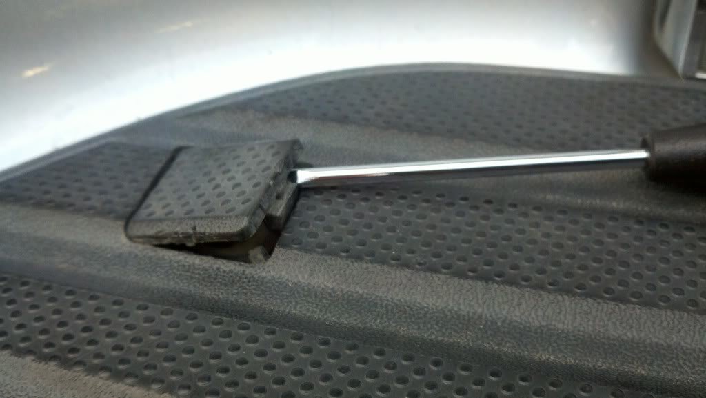

    Use a flathead screw driver to pop up those little squares up from the inside (closest to the license plate) and lift up. They do not pop straight up. Lift the center round section of that pop-in thing to pop it out.
    2012-02-12_16-50-04_681_93c7577b8cda75c4788995896296b51555906291.jpg2012-02-12_16-11-42_339_529ff31ddfc5f4b72d63adf8fc96c34074c32809.jpg

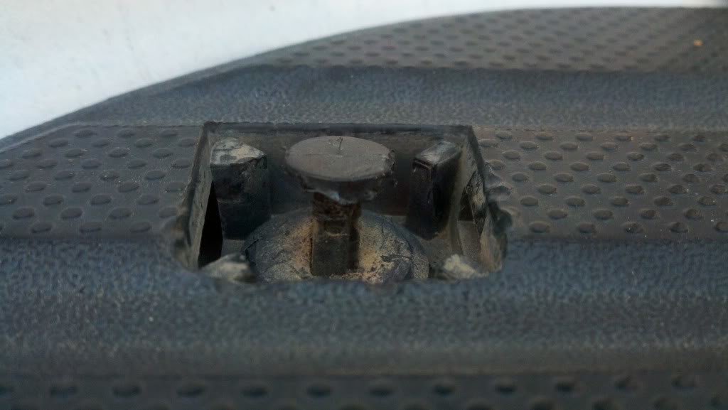

    In addition to that, there are two more small bolts under the cover (underneath). You'll need a 10mm socket to remove those two.

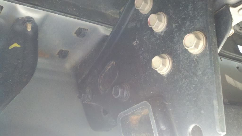

    11/16 socket for the remaining 4 bolts (2 on each side). There are a lot of bolts under there. Remove the two closest to the bumper. If yours are the same as these, they will be black in color while the other ones are in silver. Remember, this is from the Double Cab with a hitch.
    The brackets holding the rear bumper are different on that of a NON-PRERUNNER. However, the pattern (the two bolts being removed on each side) is the same. Remove the two closest to the bumper. Notice these are not black like the others.

    One thing I'll mention that might be a wise idea (even though we didn't do it), taking out the rear tails might make for a better piece of mind because when you're pulling on it that hard and trying to put it back in... more than a couple of times we came close to ramming the bumper into one of the tails.

    Good point to bring up about the lights. I remember we were close too, but we knew to keep it away and push down at the same time.
