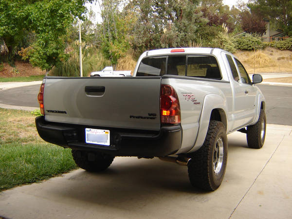

    Yes, today as in Sunday morning. Took about 45 mins to do. I didn't have it yet at the expo. I really like how it looks. Here are the pics:
    Before:
    After:

    I kinda thought the same thing, but I chalked it up to the angle. :cool:
    Looks good Daniel. Congrats on a successful swap! :D
