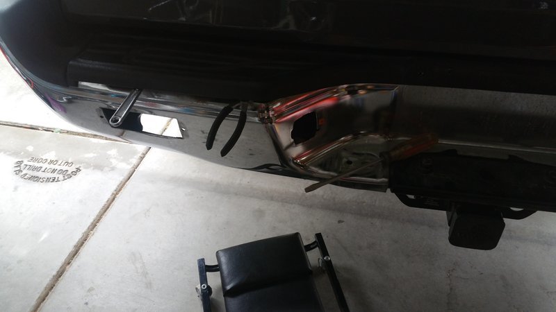

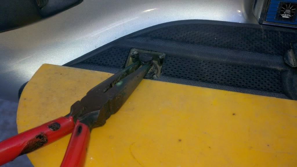

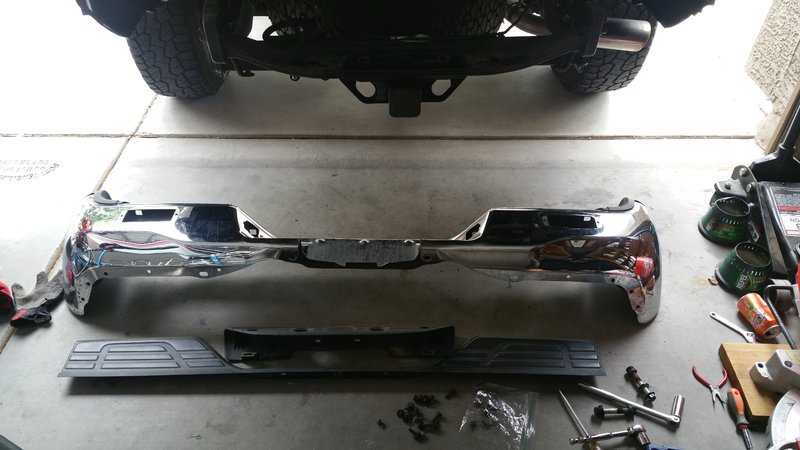

    Very helpful post and thank you guys for leading the way. I give everyone props for taking off their bumper and paint it now. Took alot longer than I thought it would take. Thought I was done when the bumper got off but the real battle for me was the plastic ends. I tore them off from frustration and will fabricate something on a later date. A few pictures for any future member who want to tackle their rear bumper.
    PM if you need alot more pictures. Didn't want to over due it. Yes, had to do whatever was necessary to get all those clips under the plastic off without them reattaching.
