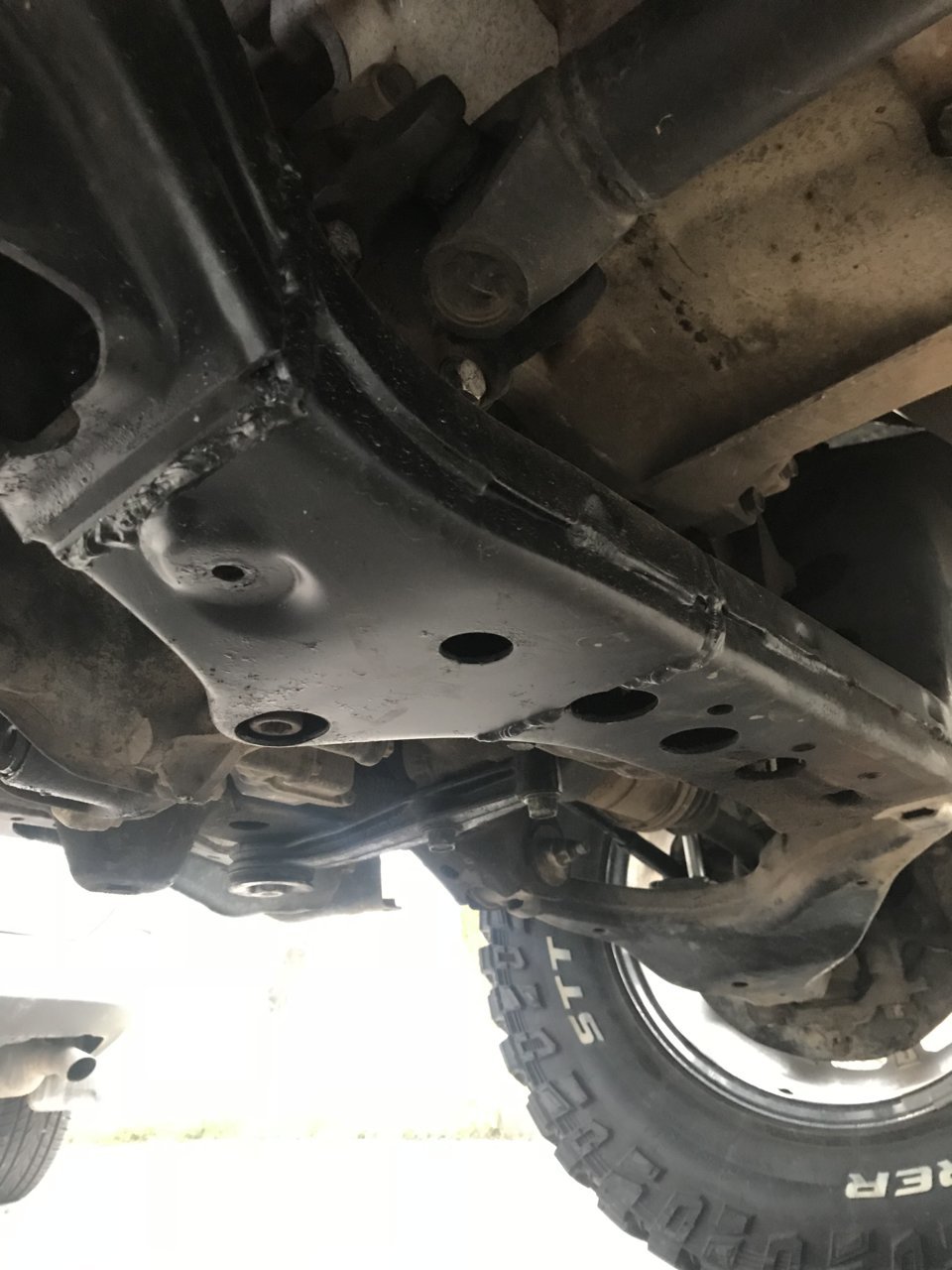

    I know, old thread. This is for anyone else like me that found this one in a google search. I was able to remove my 6 inch Pro Comp components, and reinstall the factory spindles, diff mounts, and sway bar links in about 10 hours. I bought the spindles from a salvage yard for $200 a piece and they threw in a nicely cut section of the cross member from a wrecked 2012 for free. I had a fab guy do a beautiful job cutting the new cross member piece to size and welding it in place in a few hours. Some of that time was spent cutting and cappin the cab mounts so I could keep the 295/70/r17’s. I love the truck and love the ride! So much more potential. No more issues with alignment, creaking and squeaking, or in my case getting the worthless drop brackets and compression struts hung up on obstacles while wheeling. While I had the truck up on stands I threw on Billstein 5100’s in front and Dakar 3 inch pack on rear. Get to work making your taco fully functional again!

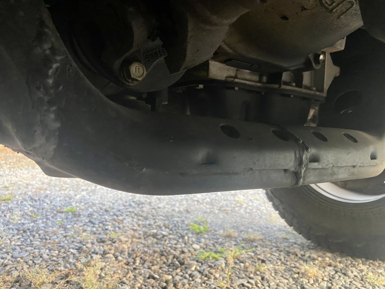

    How is your crossmember weld holding up? I'm a bit nervous about getting it done. So many sites out there recommending against frame and sub-frame welding.

    If it’s done right it’ll hold up fine. The second key thing to do is paint the inside and outside of the welded area. Or rust will form fairly quick and become a problem later

    Yeah, its the if it's done right part that worries me. I found a seemingly reputable welder who works out of his garage who will do it, but I would much prefer a fab shop. Problem is every one I call is not interested.

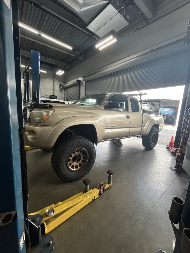

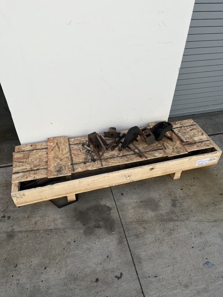

    Honestly screw procomp for making an application that needs to cut your Tacoma frame what a joke. Sorry just digging up old 6” forums and it’s upsetting me lol. Makes me want to just keep it but ugh. Dealership took out my blocks and cut my ubolts for tsb recall ( new leaf pac so it’s worth it) but I got serious bro lean and am up in the air about my options. Im thinking just get blocks again to get level and then save up for Alcan or emu and hopefully find some 6” lift coil over

    Yes it’s back to stock I think they compressed my shocks all the way.

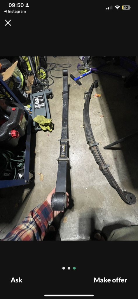

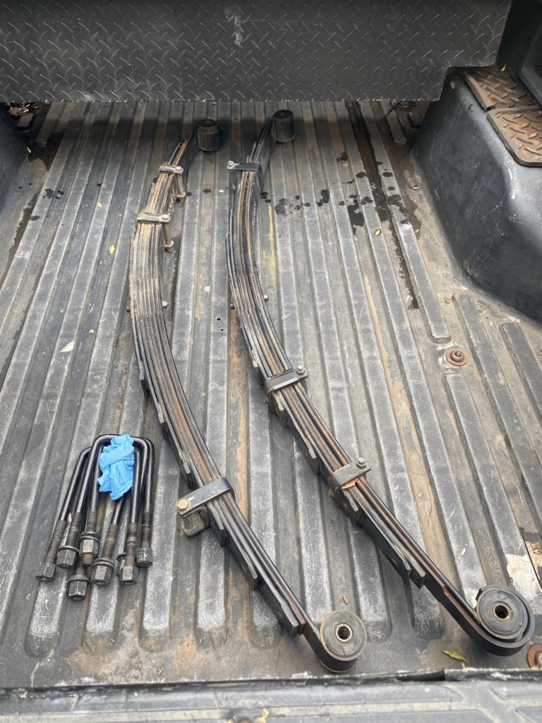

    I found a set of the icons leaf rxt i just can’t tell which set up it is. I think I counted about eight or nine leaves on it but like you said it’s a new pack so that’s why I’m kinda in the air with what I should do. Just run this stock pack, it looks silly right now but I was thinking yeah just grabbing a 2 inch block it’s cheap,this is not really gonna see the dirt here in la(Don’t get me wrong. I’m still gonna try to get icon coil overs for this or Kings and some remotes in the back.). I have my other taco for off-roading.
    I think getting this used icon pack won’t be bad, The guy said he got it for free in a trade and he’s just trying to get rid of it. He doesn’t really know the set up tho. Im afraid of getting them and I’m gonna have Axel wrap cause right now with the TSB leaf pack. It honestly isn’t wrapping anymore but I know it’s inevitable.
    Offer up pac
    Old block and ubolts
    Bro lean.
    Acquired,
