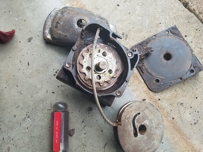

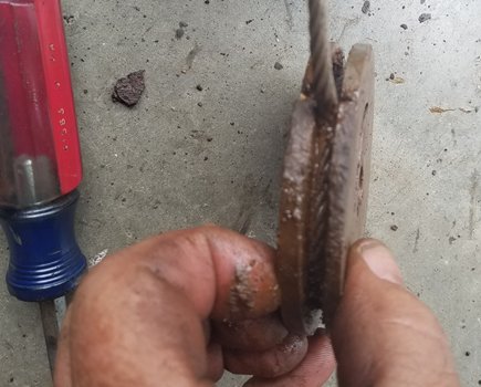

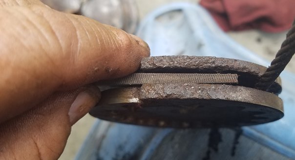

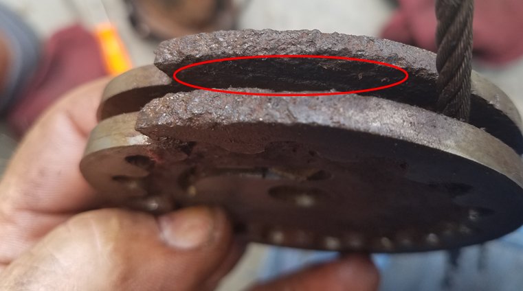

    I just rehabbed mine a little over a month ago. Cable was rusted to the spool and would only come down 6" or so.
    You have to drill out the rivets in the corners. I't's a fairly simple winch.
    I ended up welding mine back together as it was just quicker, but you could bolt is back.
    I used a small square file to remove the rust from the spool.

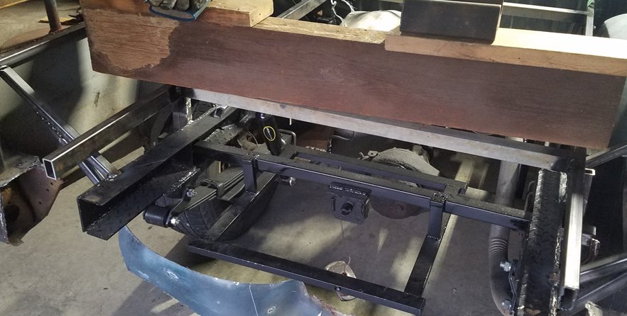

    My cross brace and the tire stabilizer arms were rusted to pieces, so I made a replacement. I was already replacing that part of the frame anyway.

    I used 3/16" tread plate steel. I don't recommend the tread type for several reasons. That's almost double the original frame thickness. Original is about 1/8". I had that plate on hand, so I used it. For my truck, it was overkill since it is not meant for anything but minor off road, and here in the Midwest, that means mud, not rock crawling.
    The raised treads become a nuisance for welding brackets, joints etc because nothing sits flat against the plate unless you grind them down at the attachment point.

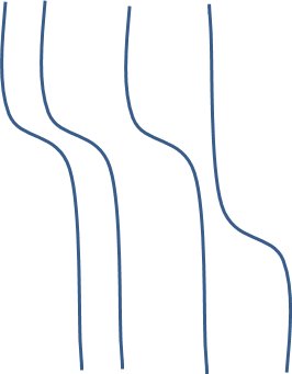

    Also, to save material in cutting out the main pieces, one side of my frame has the tread side out, the other is smooth side out. By accepting that little difference, I was able to "spoon" (left image) the parts on the layout and save about 1/3 of the sheet of metal. That put the treads facing in on one side, out on the other. Hey, it's hidden under the bed, so the savings was worth it to me.
