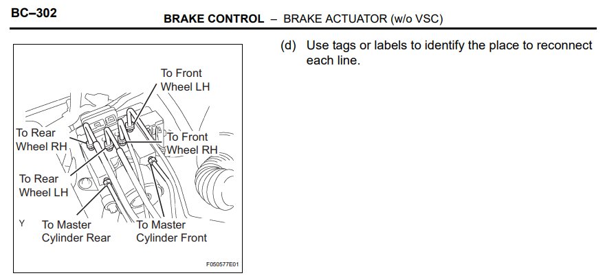

    That’s what I did, and for the same exact reason as you (squishy pedal). I don’t have any dash lights and my pedal is nice and firm again and I can actually stop my truck.

    That was my issue that all started when I replaced my calipers a few years ago. I don't remember why but the passenger one had a hiccup and I had the brake line disconnected for 24 hours, or maybe I didn't bleed it until the next day or something. Regardless, I think air worked up to the ABS module and got trapped in there and I couldn't bleed it out no matter how hard I tried. Even cycled the abs pump with a scanner. That's why I wanted to do this abs bypass and I'm glad I did.
    edit: Are your rear drums adjusted? That can lead to a squishy feeling. Assuming you even have drums in the back anymore.

    I thought I'd also add the diagram from the FSM that I referenced.
