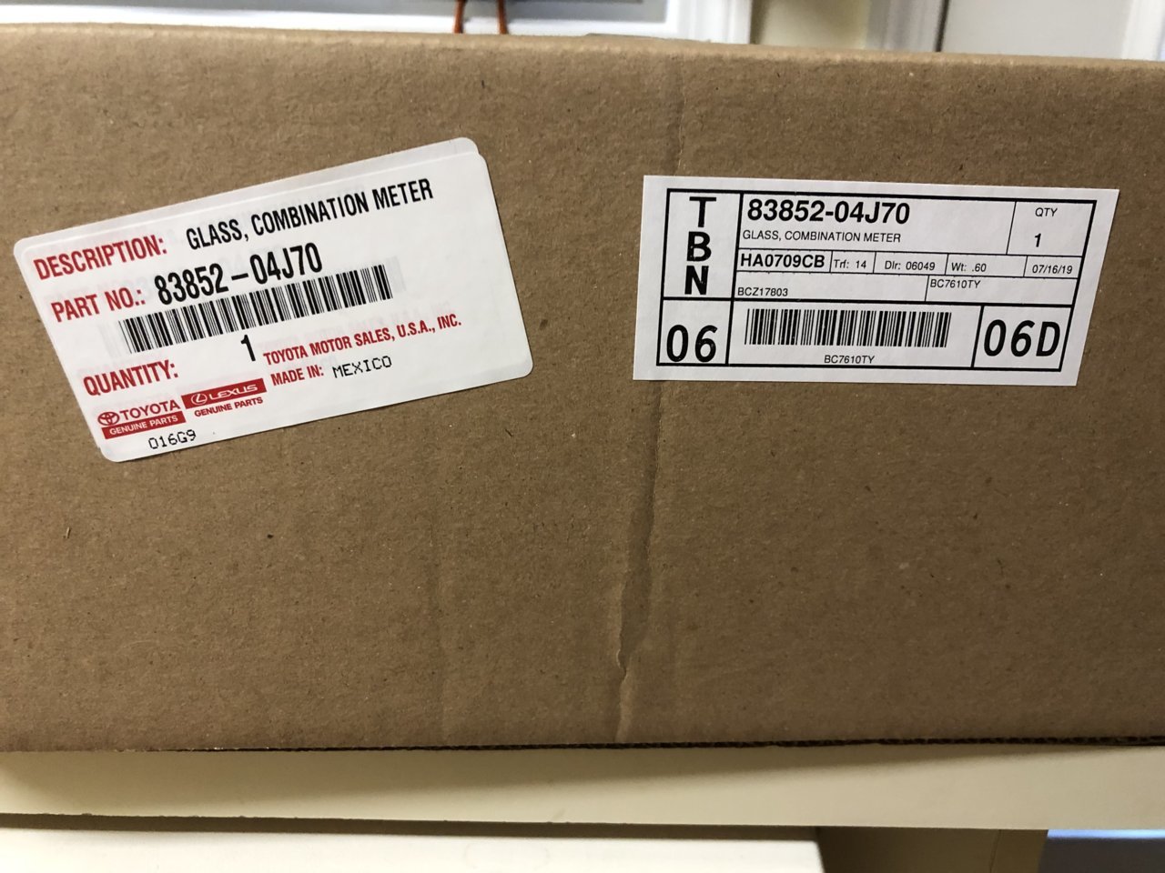

    After seeing this thread the other day I contacted my dealer on a new one as well since mine looks like it’s been through hell and back.
    $32 bucks later and I’m 46th in line to receive one. I’m told 40 ship at a time from Toyota. They have to be aware that this is a significant issue spanning 3rd gens :rolleyes: or they really like making a few extra dollars.

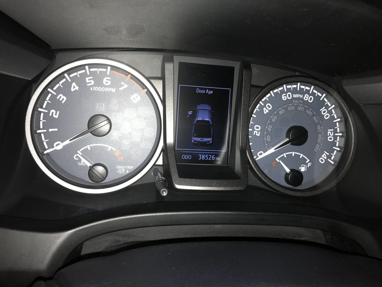

    Any recommendations on how to properly clean instrument cluster plexiglass without scratching it?

    Not all microfiber clothes are the same. I have some that seem kind of course and are very thin and others that are thicker and much softer. As someone previously mentioned regardless what you use if the wiping cloth is dry your are dragging dust across the bezel which scratches. I try to use a very lightly damped cloth to gently clean off the dust. Then a super soft lens cloth like the ones used for cameras or eye glasses for the final drying of the left over moisture from the cleaning cloth.

    Try using a vacuum with a soft brush attachment on the end. Don't wipe with it, DAB with it. Lift the dust off with the suction. The brush I have came with a Kirby vacuum cleaner and has bristles almost 2 inches long. Really soft. There is bound to be others out there that are softer. Try to find one with boar's hair bristles, not plastic bristles.

    Great thread - read it all the way through. Related question - Any ideas on how to prevent dust from getting through the hole in the Plexi? I am wondering if maybe finding a small rubber band or maybe even a piece of black Velcro cut just right could sit at the base of the little trip odometer thing to block the hole. Any thoughts?

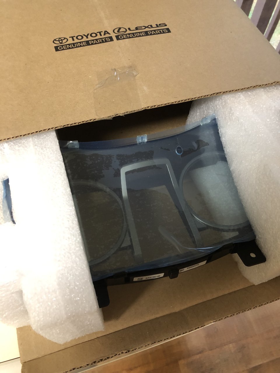

    This weekends project has arrived. So looks like expel clear bra or ceramic coating seem to be the only true fix for longevity and cleaning purposes? I’m not
    Trying to have to replace every year. Mine was cracked and badly scratched from the start. Before and afters coming soon.

    That is how I scratched mine...apparently the softest vacuum head from Rigid isn't soft enough. Holy crap, mine looks bad.
