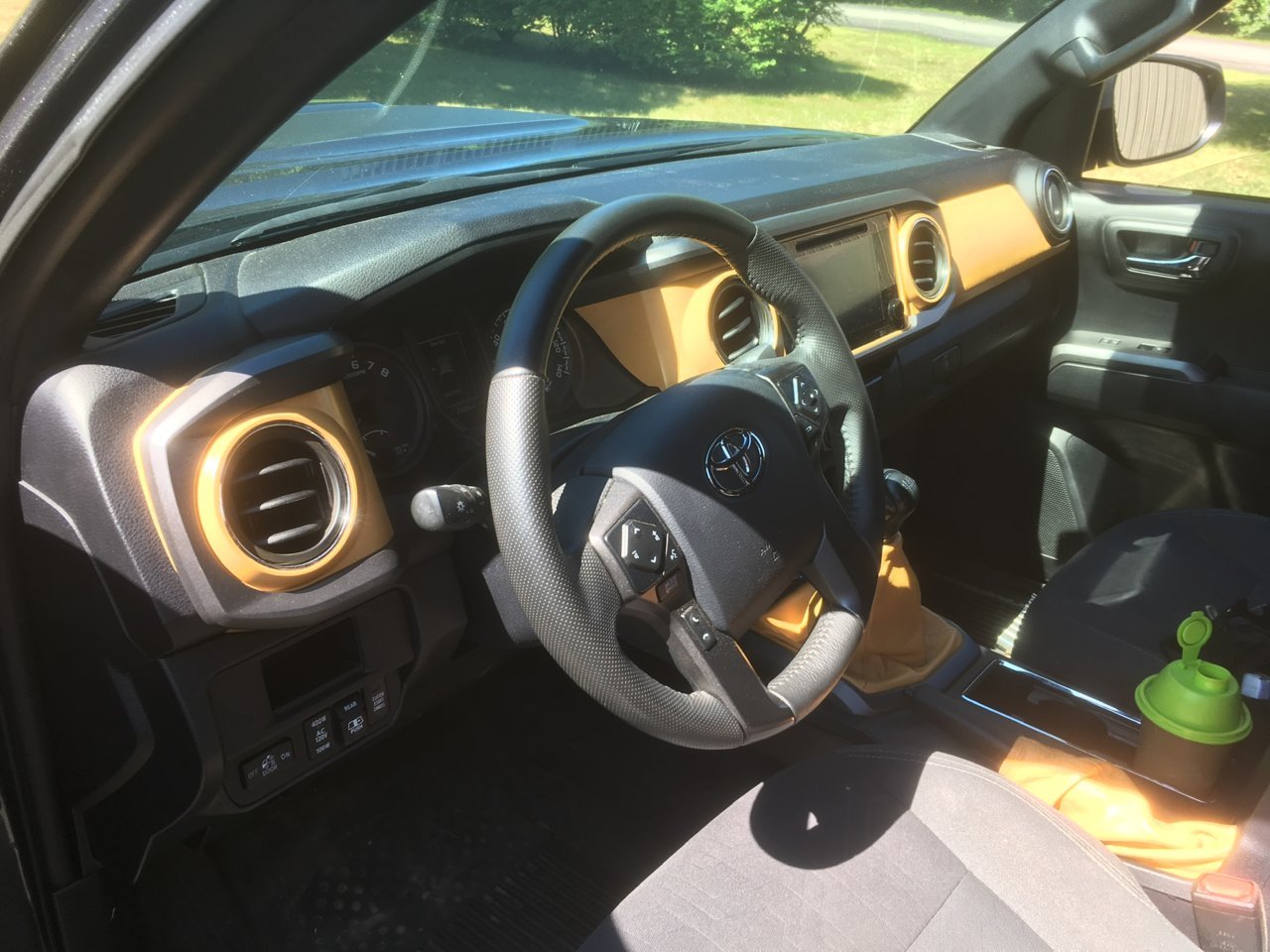

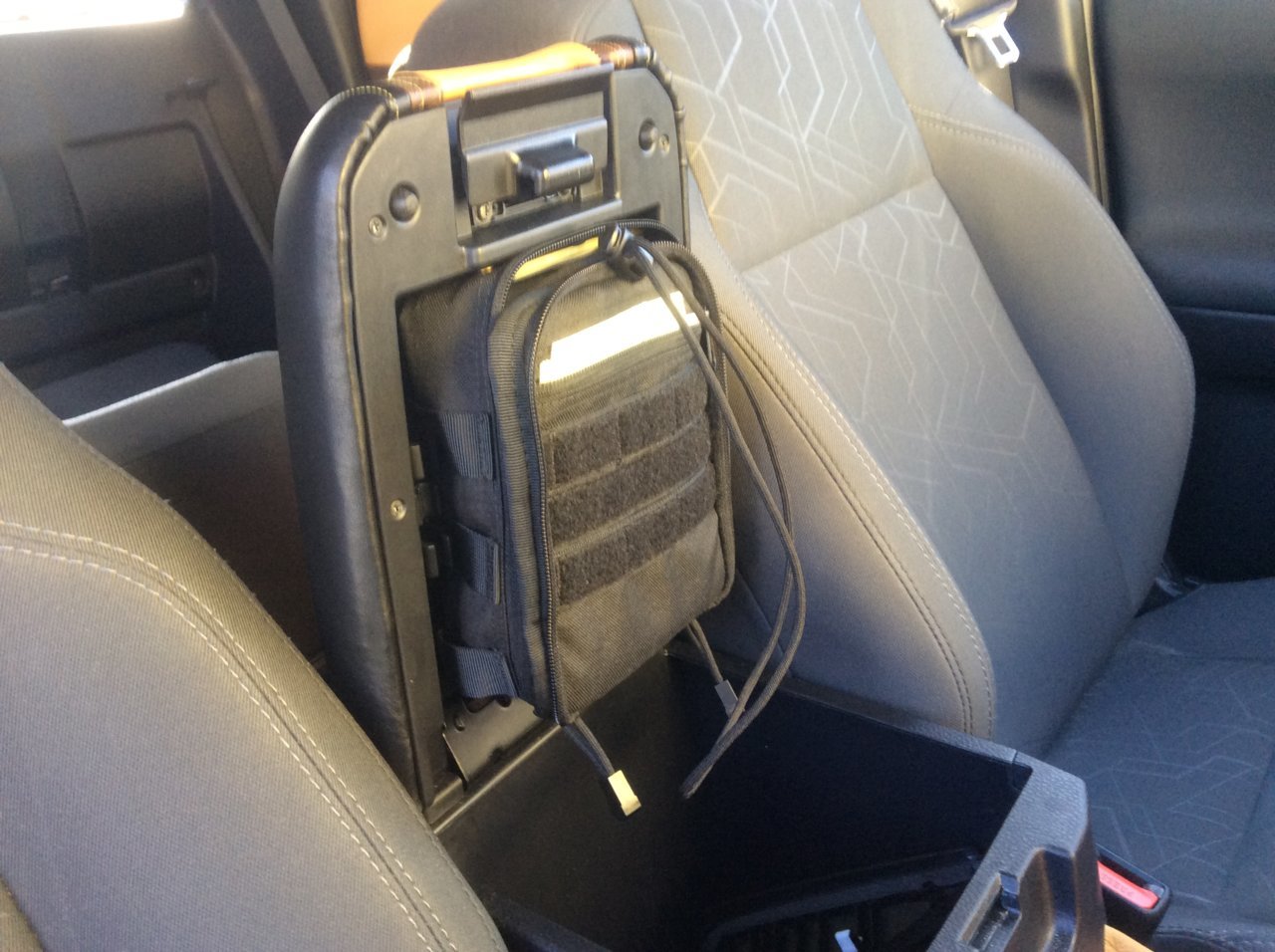

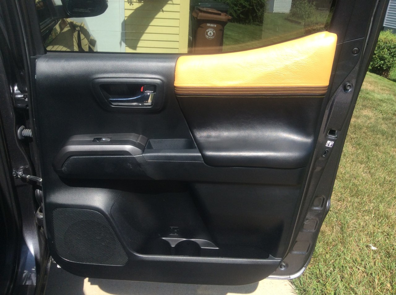

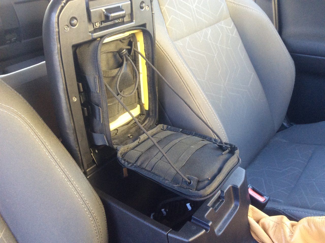

    here is mine. The all black is to little for me. I needed color. It is a love it or hate it color combo but you can do whatever colors you want.
    F7CA5E20-A02D-48D0-86CF-04F43ED7A613.jpg 4AA9CF23-24E8-4650-8328-7AF4F975A41C.jpg This always gets attention also.5CF33A45-72B6-4802-AF6B-19A0C7C3DD07.jpg 76F566F3-1653-4B9E-BEC8-7A9A9144B8F8.jpg

    Not to get too off topic from the main thread, but that all looks great! I'm curious about the door panels you did. How'd you go about that? I know they're plastic welded to the main door panel, but I hate the look and feel of the stock material and would like to redo it as well

    Those plastic posts were the biggest pain about the job. By the last door panel I used a soldering iron to melt them over and back onto themselves. They are hollow so open up the center first so you know where the middle is. To reattach either melt the plastic back over or use short course thread screws and washers. Be careful not to open the middle up to much or there will not be enough material to use to reattach the panels. Damn I should’ve done a video.

    Awesome, good to know! Appreciate the info

    Also, where did you find that little molle bag for the console?

    Army surplus store. It’s a Condor hip pouch. $20.00.

    No worries man thanks. This thread is getting off topic and I don’t want to keep going with it. I will be posting a video of how I did the panels soon. I just got a 1st gen door panel and a harbor freight plastic welder. I am going to remove a piece from it and reattach.
