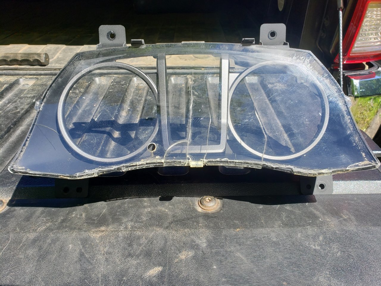

    Thanks for info on this thread. Just changed mine out. Cracked for no reason last summer. After I took it apart look what I found. I think this must have been smashed in during the trucks assembly. The upper bezel never looked right since the day I bought it. Makes sense.
    DSRamsey13 and TRDPro916 like this.
