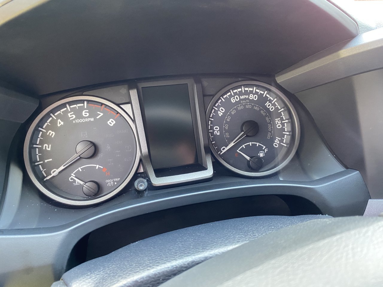

    Think I’m gonna end up ordering a screenprotech sooner than later. This bugs me every day. For you guys that have replaced the screen, did you just remove like the left side, bottom, and top of the trim panels? I read the first post and saw the pics but wasn’t sure still.
    I’ve taken off under the steering wheel and the one around the radio before but didn’t want to mess with extra stuff if not needed. I wanna get the bit of dust out from under the Trip meter spinner before I do anything else then will probably do the protector while everything is exposed

    Radio bezel comes off first. Lower steering wheel and put wiper and turn signals in down position. Pull cluster bezel off by gently pulling at left side
    (vent area). Maneuver bezel around steering column and it will be free. You don’t have to remove any other trim.

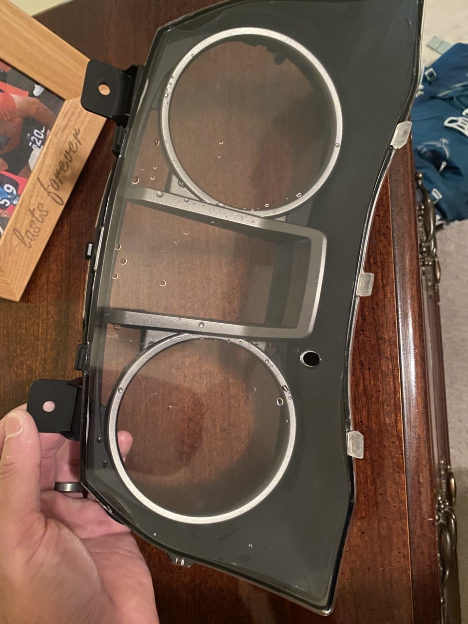

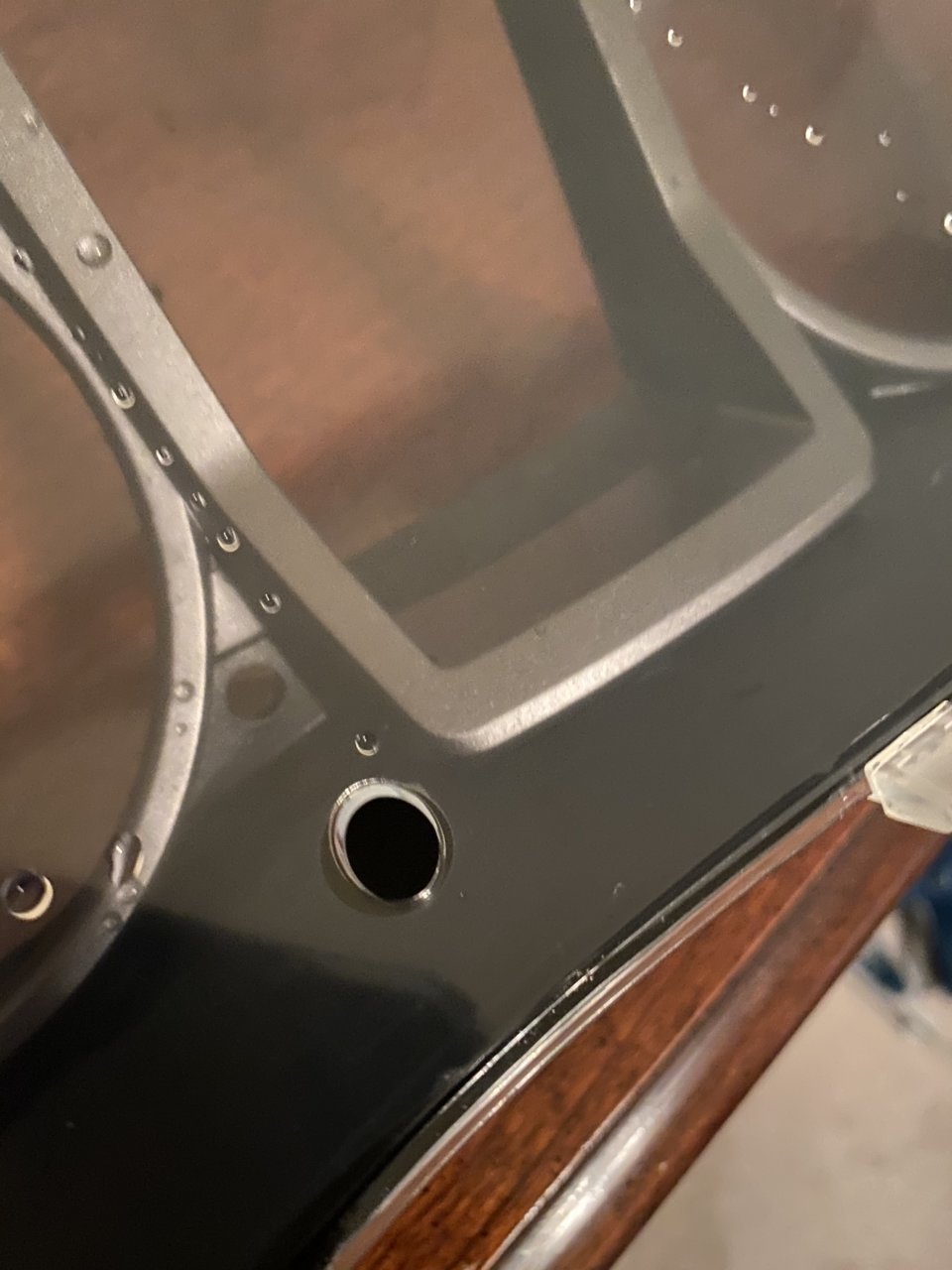

    The film that is used for the screen protector is very forgiving and can be placed a few times to get the adjustment right. The key is to have a clean environment and use the slip solution that is in the spray bottle very liberally. Lint and dust will get underneath the protector if you’re not careful so make sure the gauge is free and clear before you put the protector on.
    The water drops you see are on the inside of the gauge. I am very happy with the results and will update with another pic once the gauge is in the truck. I now have piece of mind that the gauge is protected from the get go.

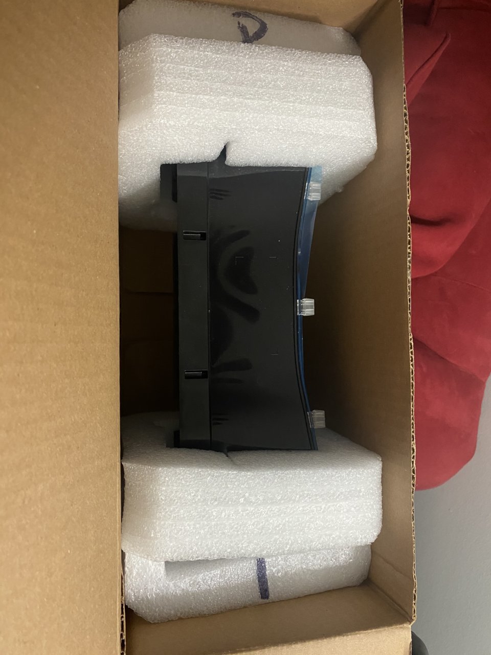

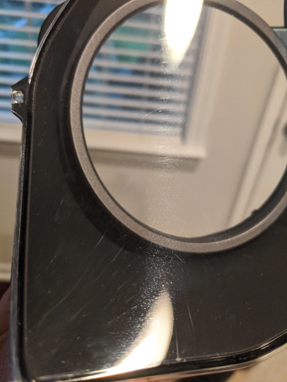

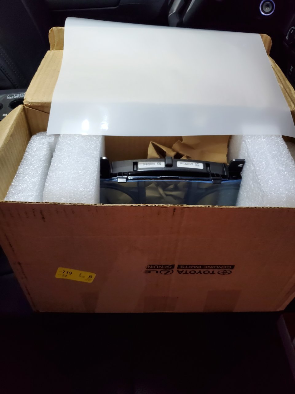

    Looks great! Did you clean the new cluster prior to installing the protector? Im wondering if the lint cloth and cleaning solution provided scratched the new cluster?
    Mine just got delivered, there's already dust and styrofoam pieces under the protective plastic sheet. No wonder this thing scratches so easy it definitely feels super cheap. It also comes pre-scratched straight from Toyota. This was sealed in a box, I peeled off the protective sticker and snapped these pics.
