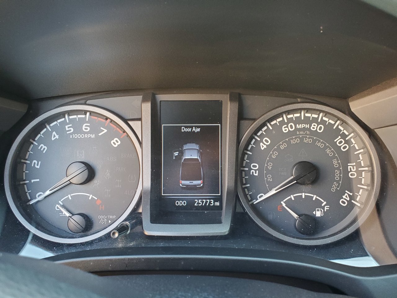

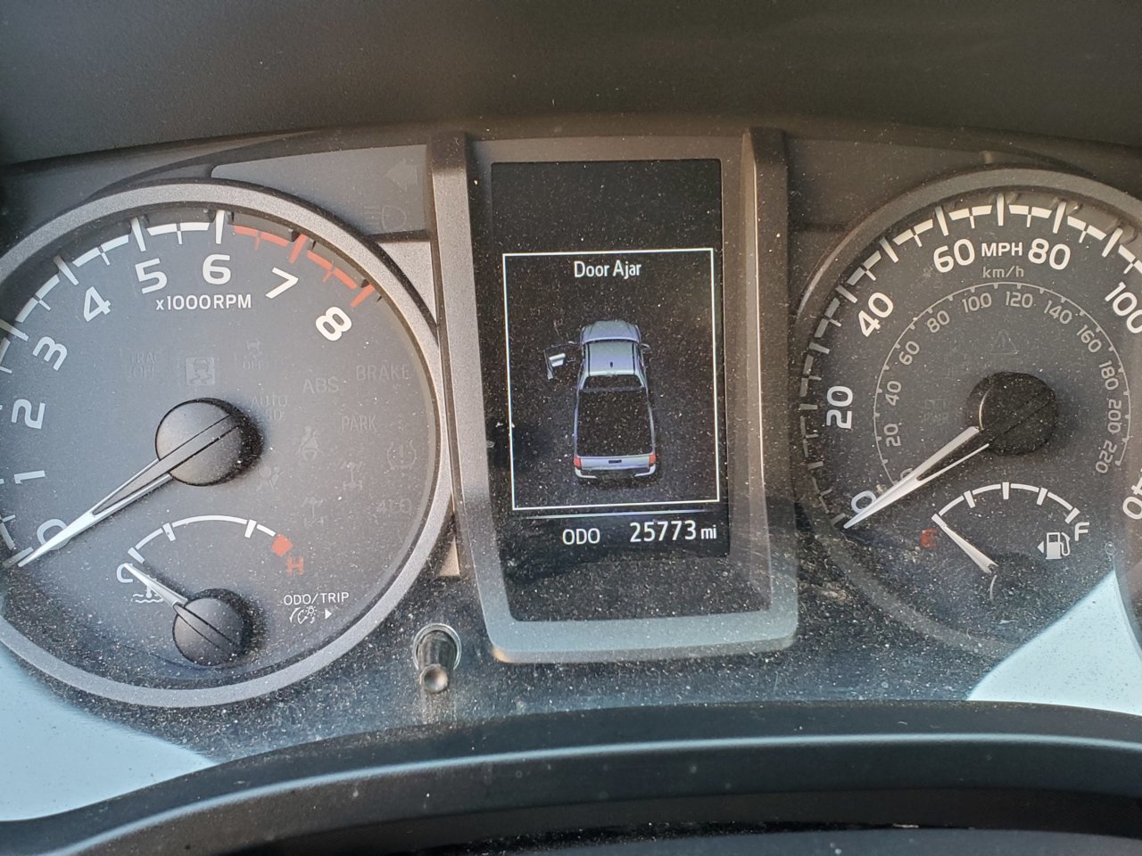

    Had my screen replaced under warranty over 4 years ago. It was scratched pretty bad. So for years I just used compressed air to mostly clear the new one. Spent $1 for some kid slime and tried it. Did a quickie job but very happy with 1st try results.

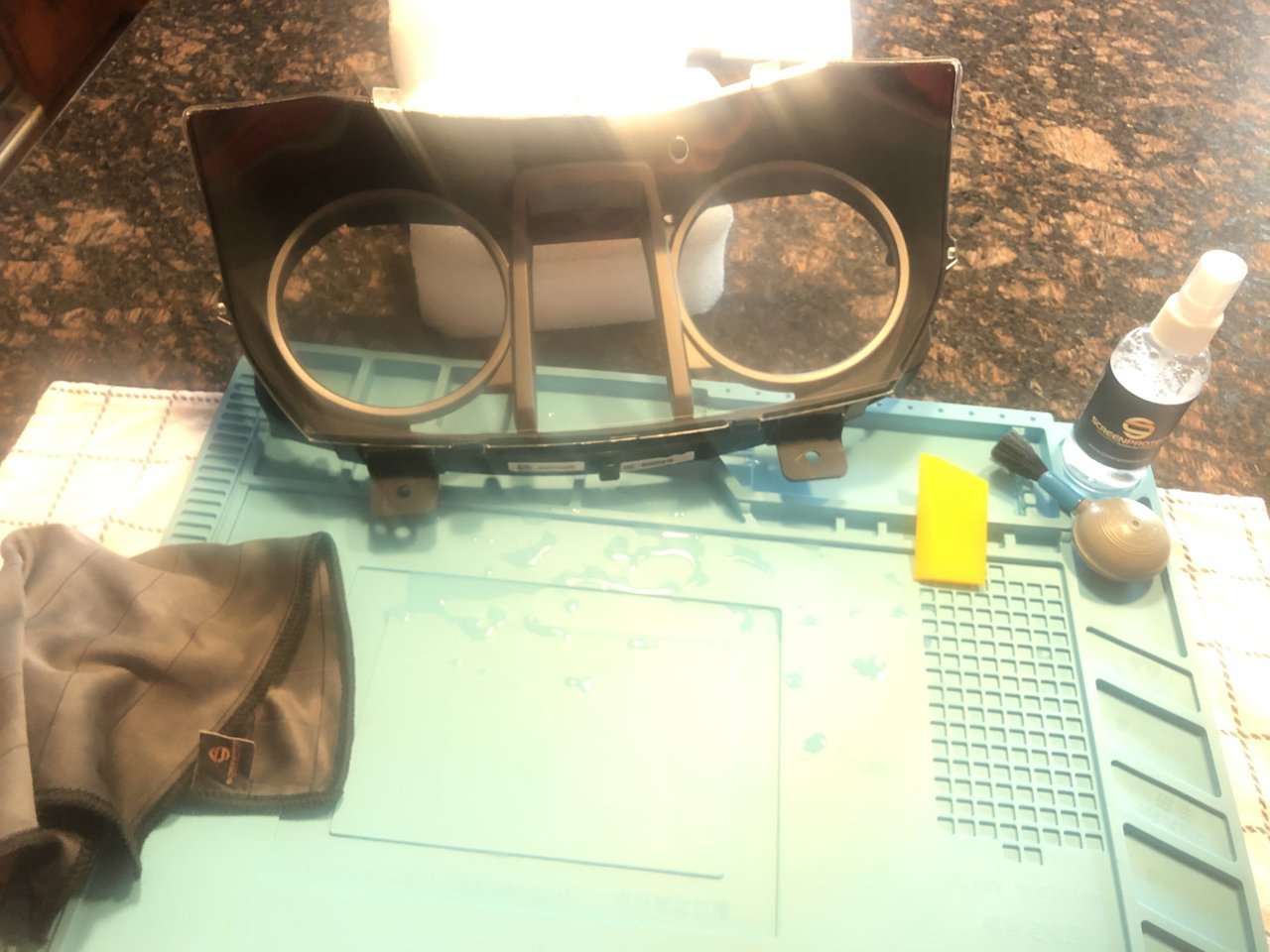

    Giving this another try with new glass, I’m going to let it sit for a couple days to see if any bubbles develop. So much easier when outside the truck, even then I had to pull it 3-4 times to remove some dust. If this one doesn’t turn out good I’m going to put my second new one on sans the protector and call it a day. Damn static just sucks dust against the plastic like nobody’s business.

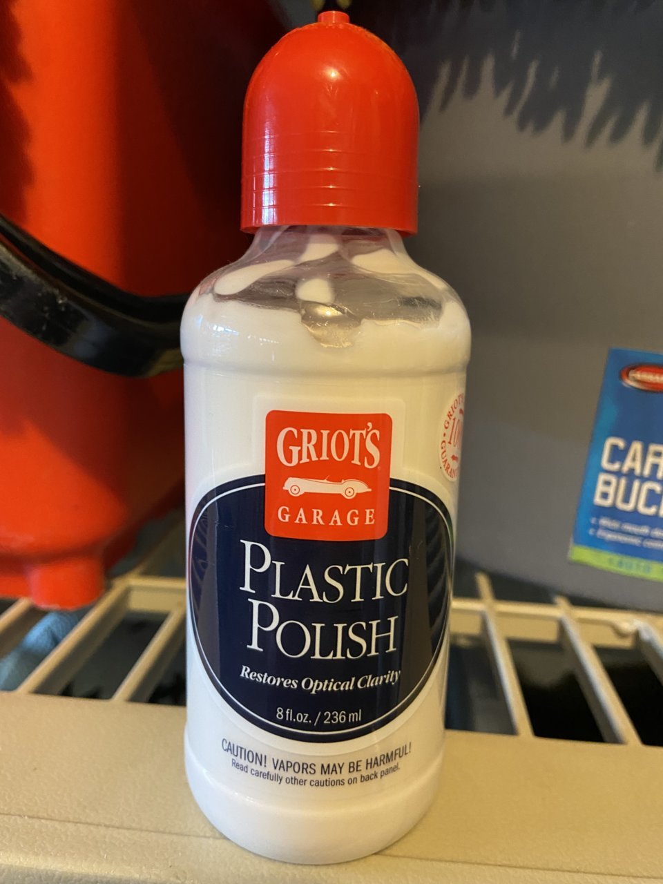

    What did you use to polish with?? I’m afraid whatever I use will scratch more. Thanks!
  17. Aug 8, 2021 at 7:52 PM
    #437
    rsimi72
    rsimi72 Well-Known Member
    Mar 31, 2017
    #214965
    590
    PNW
    2020 Tacoma SR5 Access Cab
  18. Aug 8, 2021 at 7:52 PM
    #438
    rsimi72
    Mar 31, 2017
    #214965
    590
    PNW
    This worked well for me.
  19. Aug 9, 2021 at 3:07 AM
    #439
    TheReal_JonWick
    TheReal_JonWick Well-Known Member
    May 30, 2021
    #367209
    65
    JR
    NY
    2021 TRD OR DCSB
    My apologies, what cloth or pad did you use? I should have been more specific in my question! Thanks!
