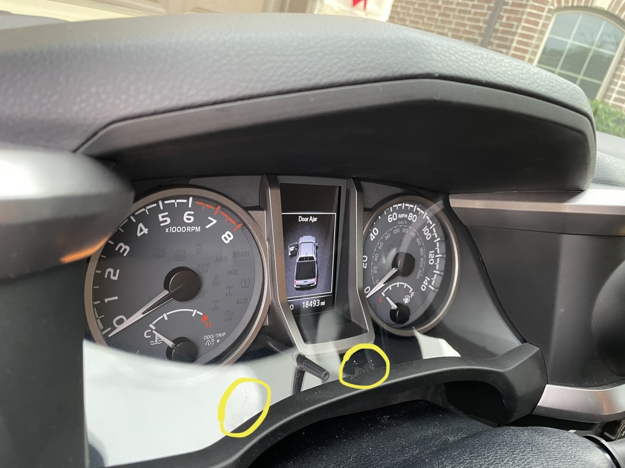

    Wish I would have seen this thread sooner to see how easily scratched the cluster is. I was cleaning my glasses with one of those alcohol wipes and I saw some water spots on the dash and well... scratched it up.

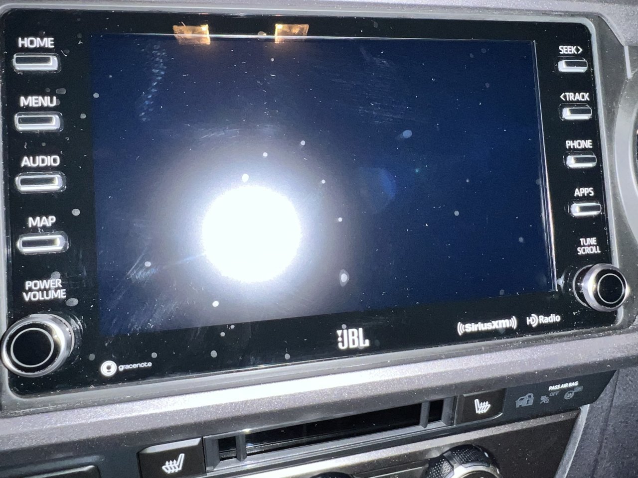

    Just making sure you all are aware, this product covers up or “heals” the micro scratches left by cleaning pretty darn well. Combined w/polish first, it will almost look new. Then after it’s applied, you can wipe the shit out of your cluster with anything afterwards and not worry about scratching. I haven’t seen it recommended in a while:notsure:
    Screen protech. TW won’t let me make a link for some reason

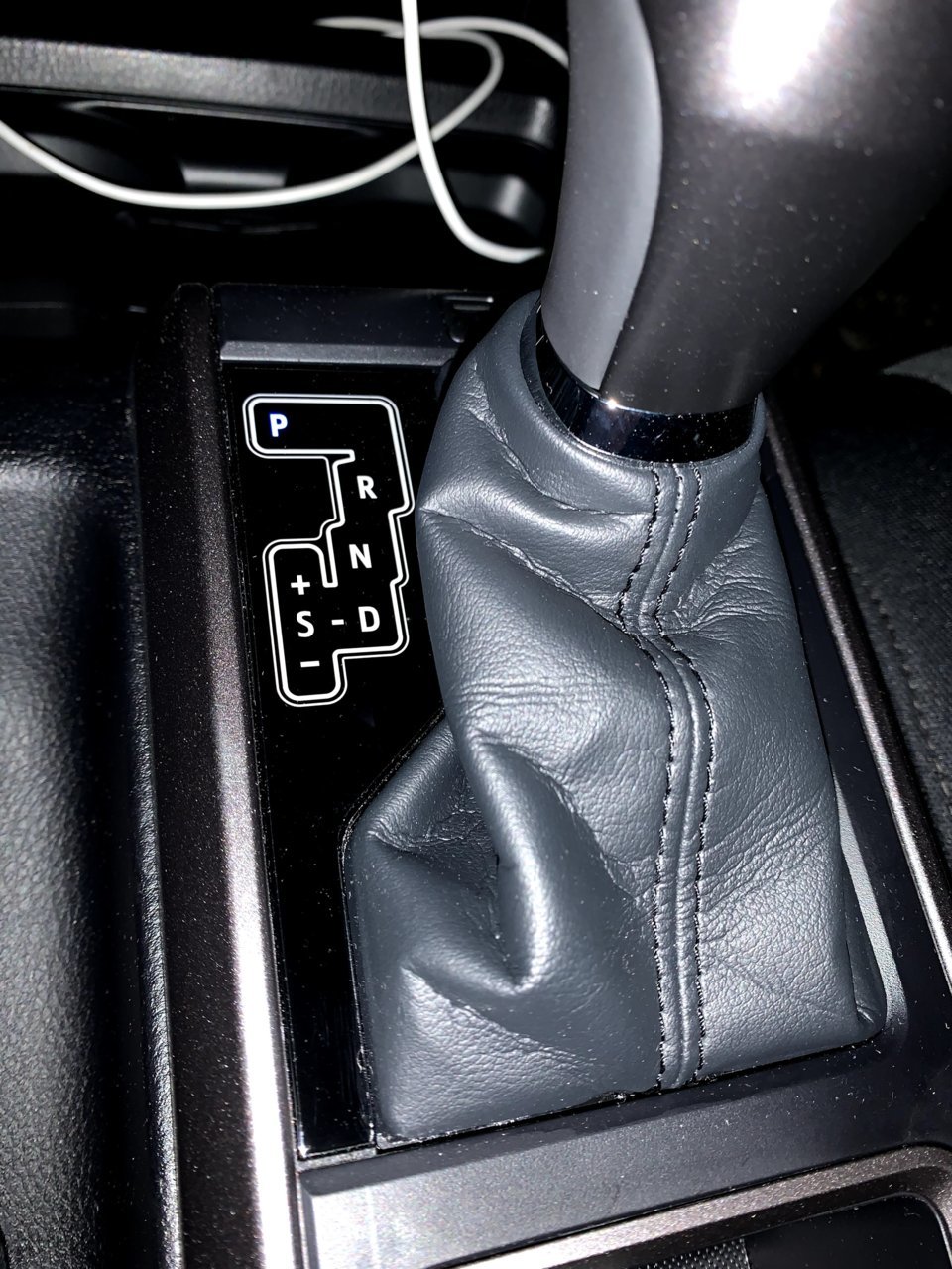

    So I ordered a new gauge cluster and the Screenprotech stuff. Came out great on the head unit, auto trans stuff I didn't. I have used plenty of Paint Protection Films etc. But for $50.00 I didn't think it was anything to write home about. Left it out in the sun for 2 days, and most of the bubbles went away but not all. So I ripped it off and put Blackfire Ceramic Pro Black on it and wowwwwwwwwwww. I have an extra gauge cluster that I ceramic coated as well and might just sell it on the forum.

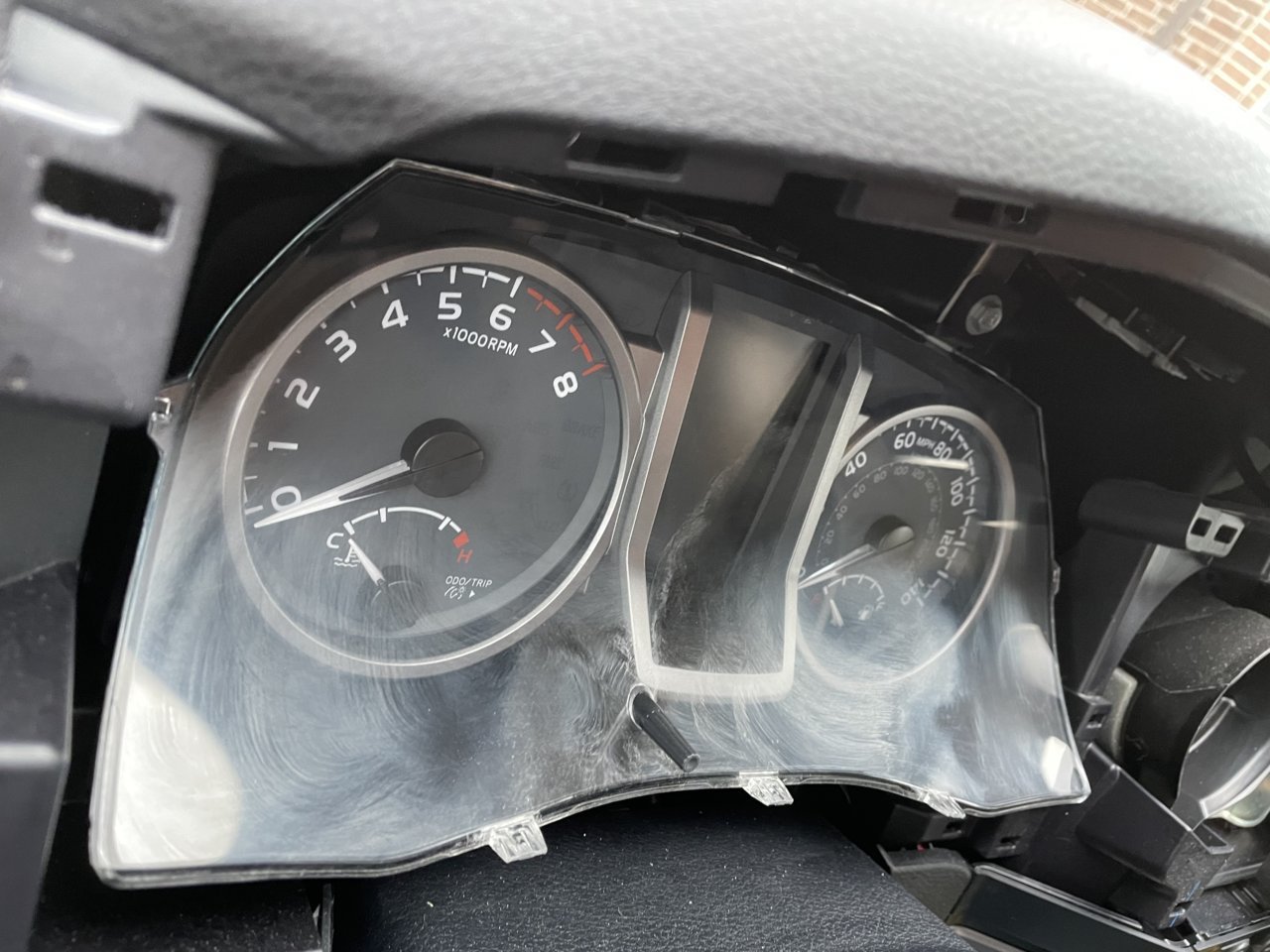

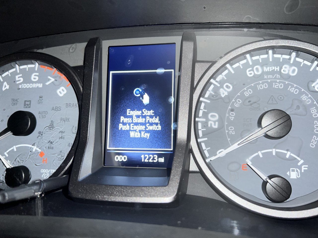

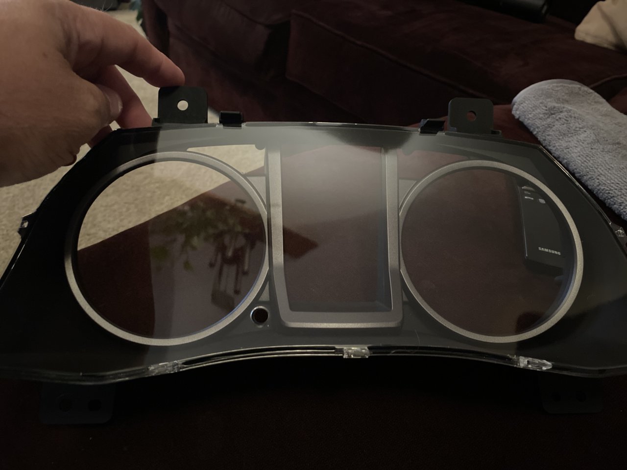

    Was about to order a new cluster film but decided to use an old bottle of 3m headlight restorer polish I’ve had luck with before.
    The 4 year old bottle took out the majority of surface scratches, but there were imperfections on the inside of the plastic that I wouldn’t be able to fix unless I completely removed the cover.
    4 simple steps, should take 15 minutes and 5 sore fingers:
    1. Remove plastic trim.
    2. Use a microfiber cloth to clean the surface, then rub a good amount of polish on the lens.
    3. Use the clean side of the cloth to really buff out the polish - fast, circular motions.
    4. Pop the plastic trim back on.
    See before, during and after below:
    JeffB, Canadian Caber and wahoobie like this.

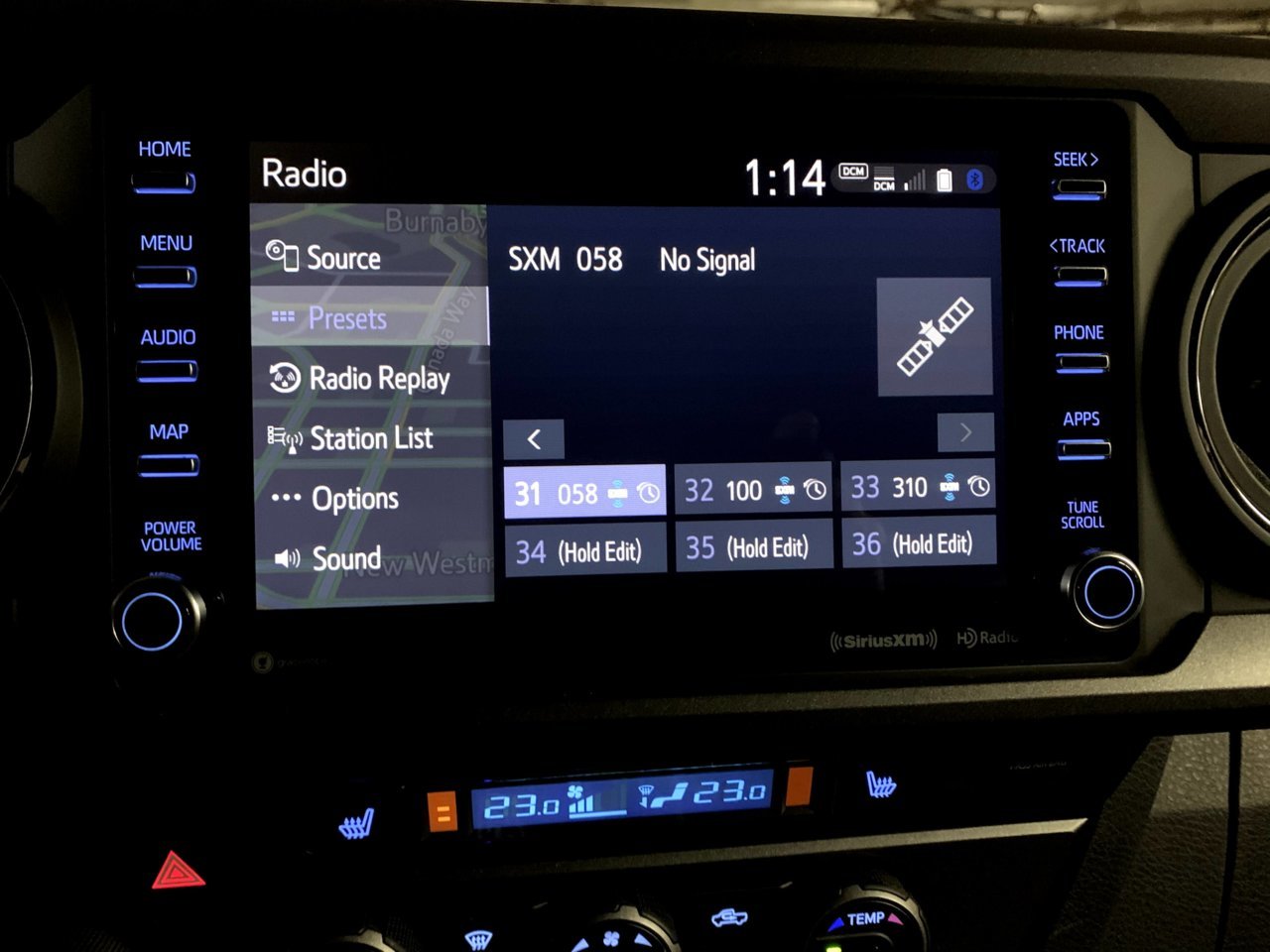

    One of the best cheap mods I did. I didn't have as many bubbles tho. The few ones I did have did went away on their own. I purchased 2 sets thinking if I messed up the first attempt I had a back-up. Never needed it. Still very satisfied over a year later. Great product so far.

    It's okay, as I was just lucky I seen the post showing how easy it was to scratch the dam clusters when I first joined Tacoma World after purchasing my truck. I was like WTF??? Folks were replacing them??? They scratch easy??? I quickly read through the thread and ordered right away. Didn't touch my cluster on my brand new truck until the film arrived. Got lucky. Especially with my kids in the truck.
