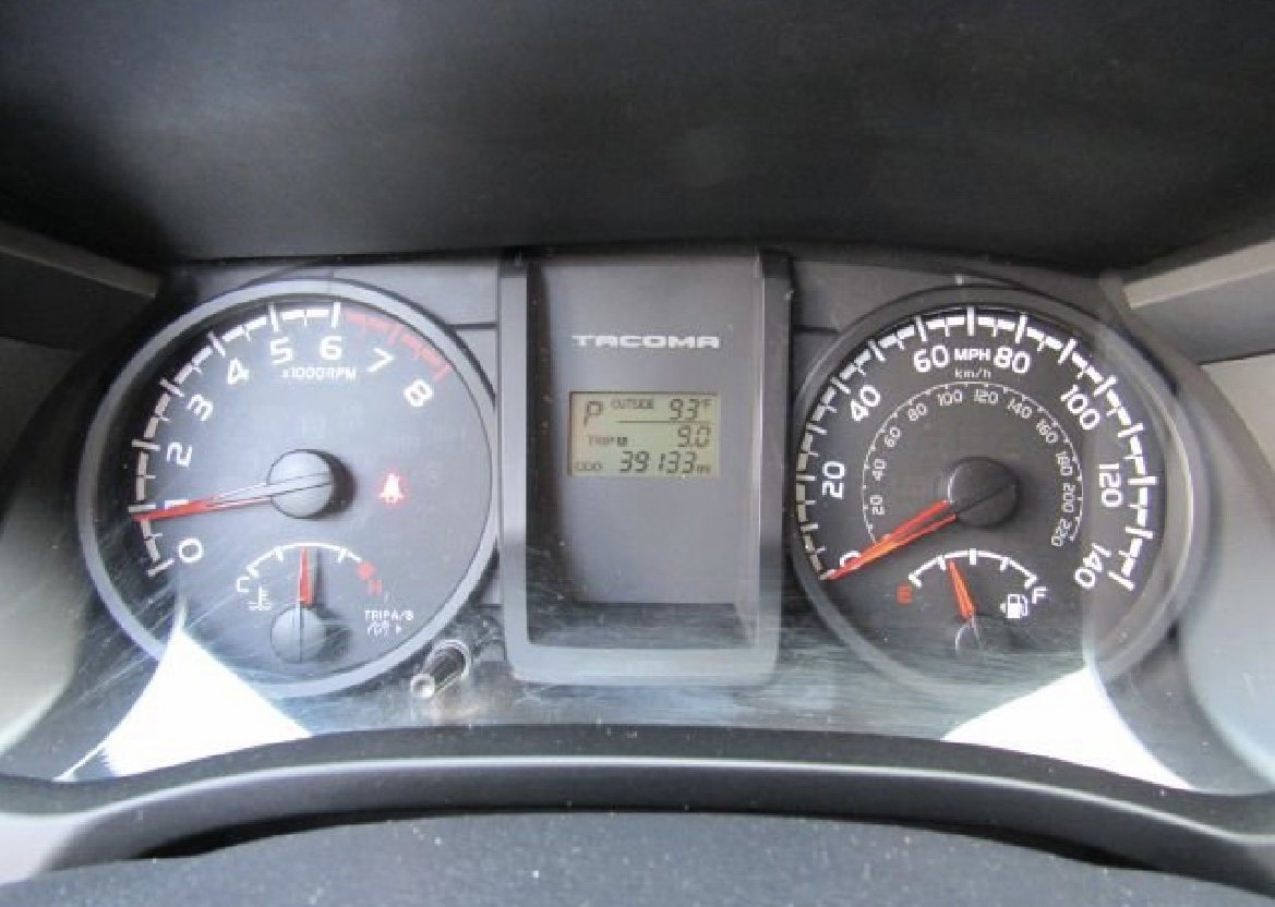

    I pulled it out a few weeks ago (took the lens off and all) and I did not find any Toyota part number. I’m pretty certain the 04F00 will be right, but the curiosity in me really wishes I had all three part numbers in my hands to directly compare.
    something interesting, I did find this pic on autotrader from a 2017 SR. Has the basic middle display, and looks like the lens creates that rectangle box. Wonder what part number that one is.

    I’d be willing to bet that’s 04F00 but can’t say for sure because of lighting. That’s what made me think the SR’s have the darker 04F00, I’ve seen pictures of SR clusters like that.

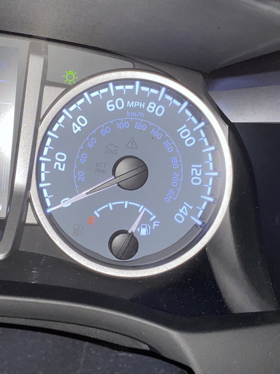

    May not be able to tell since it’s at night. But my sr5 has those grayish silver rings. same with my dads ‘19 SR.

    Yeah so far everything I’ve seen has the same gray. I think the “black” ones are just the way the light looks. Maybe not but I can not find a single truck that looks black. So strange and I would have thought tacomaworld would have it all sorted with pics by now comparing them.

    None of them are “black” per se, one is just a darker gray and one is a lighter gray, more of like a silver. It’s pretty noticeable in person but cameras don’t always do everything justice.

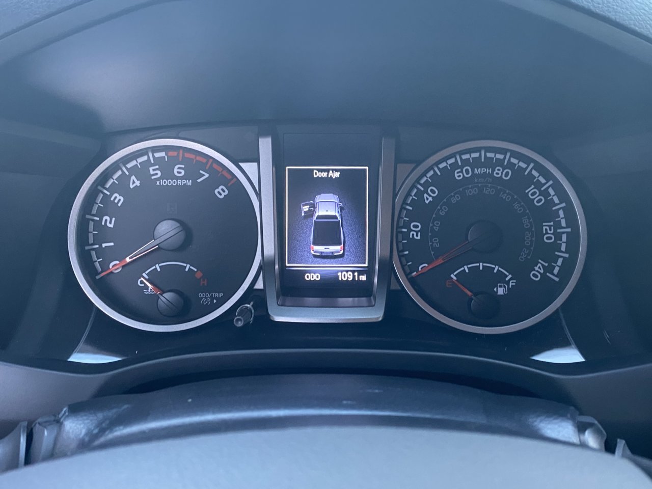

    Received the 04F00 today, definitely looks identical to the one on my 2021 TRD OR. The one I bought has the part number sticker on it. The original on my truck did not.
