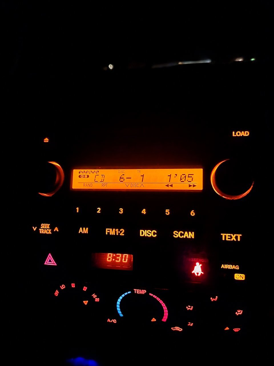

    1980 Toyota Truck MT "shifty" 1981 Toyota Truck "little orange" 1991 Toyota Pickup MT "Old Greg" 2021 4runner "Luna" 2023 Solar Octane MT "Solaris"
    3rd gen problem that I never hope to deal with. I have a new EML and will take your advise and wisdom to heart. Only use compressed air... For Toyota candy viewing. Here is my stock CD player console working in my 07.
    SH10151 and Kosta2009 like this.
