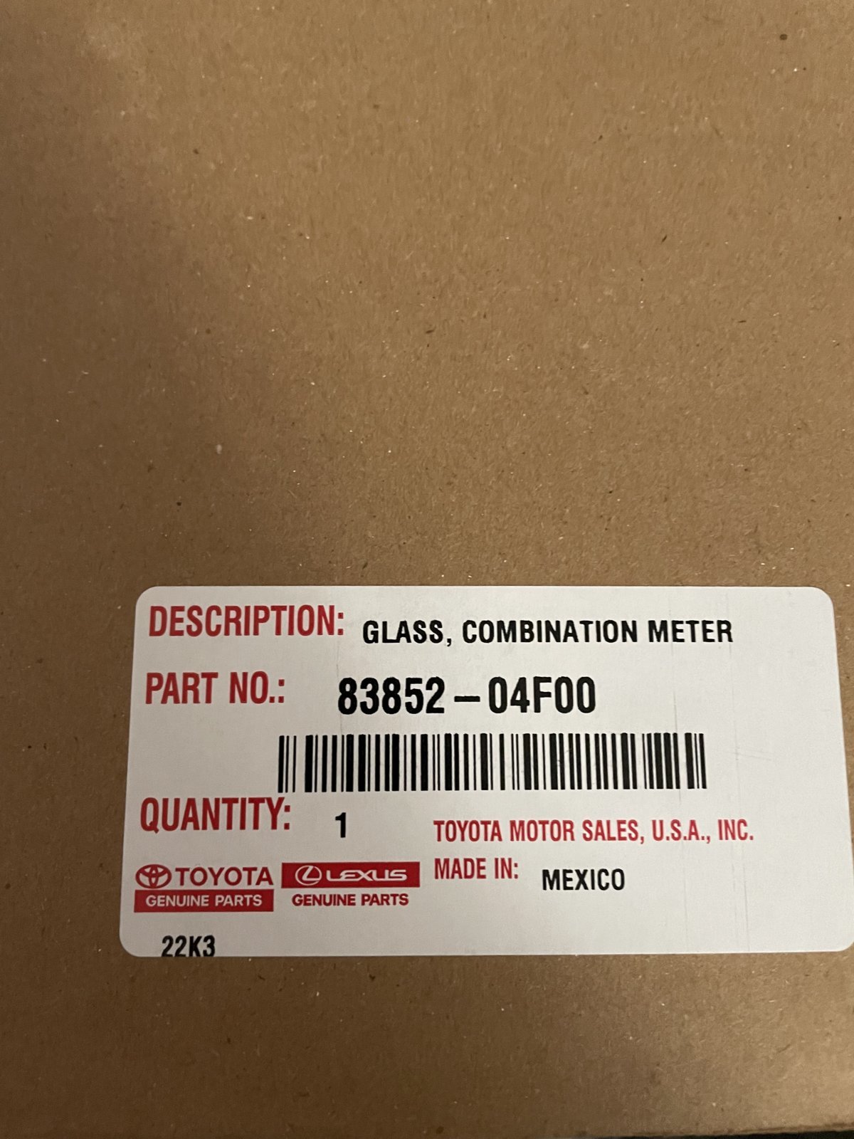

    Can you guys provide the part number

    10,662

    If you are taking about the replacement plexi, there are different part numbers depending on your trim. Some of them have chrome I believe. The first post on page 1 has a part number and the different parts and their appearance are discussed within the first 5 pages

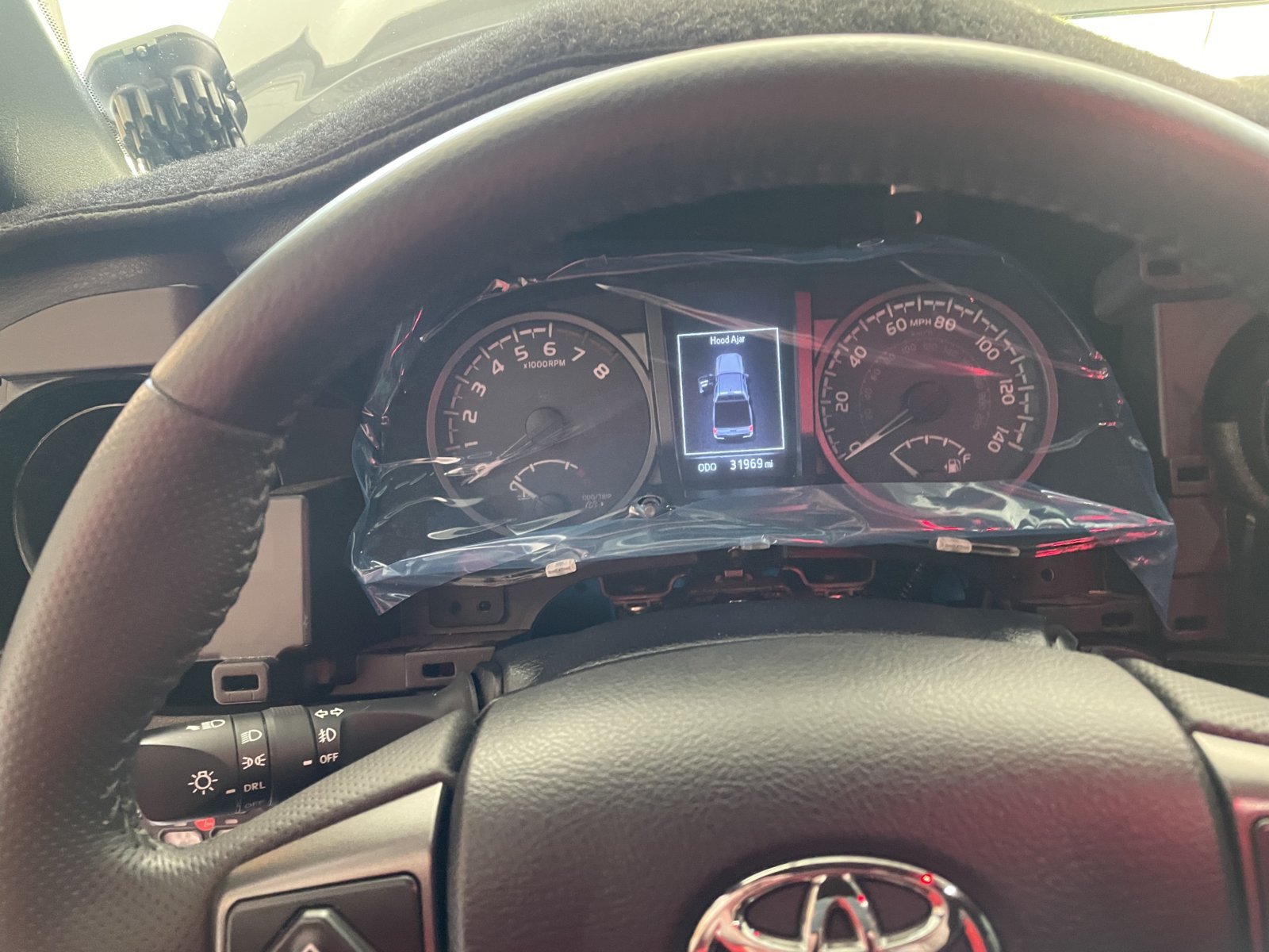

    Screen Protech kit will be here on Monday. Leaving it like this until then.
