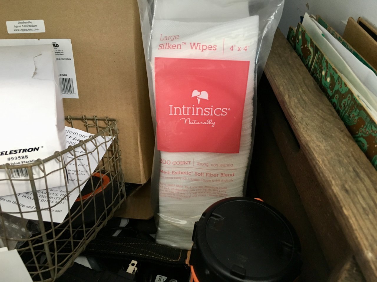

    These work very well, and they haven’t scratched yet. They are used to clean the expensive TeleVue eye glass pieces via CloudyNights. I thought I’d try it on the plastic panel and it worked very well to clean the dust and spots. 4”x4” ply.

    Where do you get those?

    I can’t find the thread on CloudyNights that leads to the kit. A pack of these 4x’s and 2 different liquids were recommended to clean the TeleVue glass eye pieces and the glass for the NexStar Evolution telescopes. I figured the ply was probably good enough for a soft plastic.
    https://www.amazon.com/Intrinsics-L..._rd_wg=w3xjV&refRID=CB1VC746ZSEKT9KYPSSN&th=1
