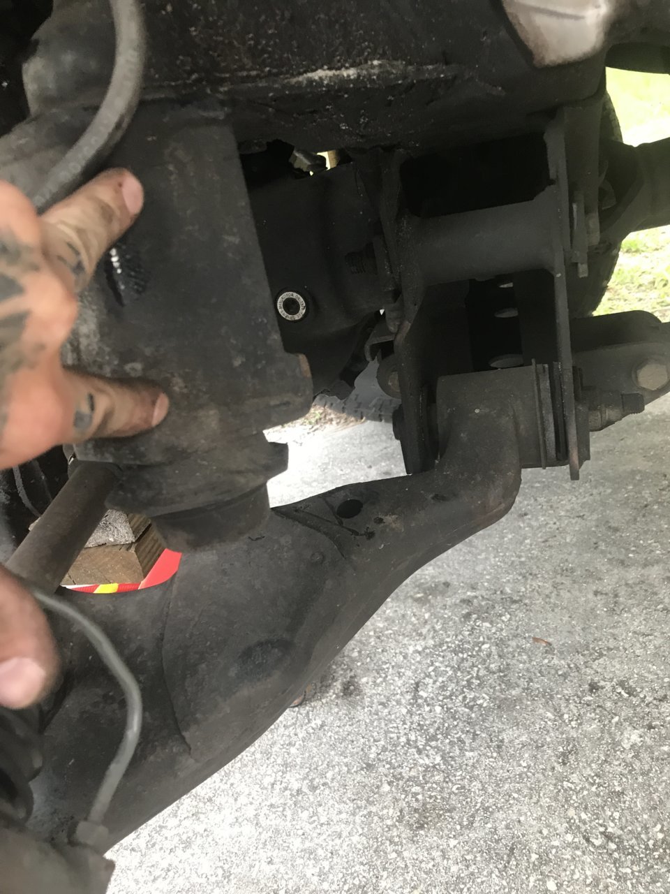

    Remove this or no? Just curious bought the truck lifted already. Seems like it limits travel

    You have a drop bracket lift. That bracket you're pointing at moves the bump stop down the same amount the drop bracket moved the control arm down.

    The bump stop? I wouldn’t remove it because you would break a shock.

    I believe part of the frame is cut and removed on a 6” lift. To remove that would require welding the removed section back in.

    The question is... did whoever installed the lift cut the frame in anyway?
