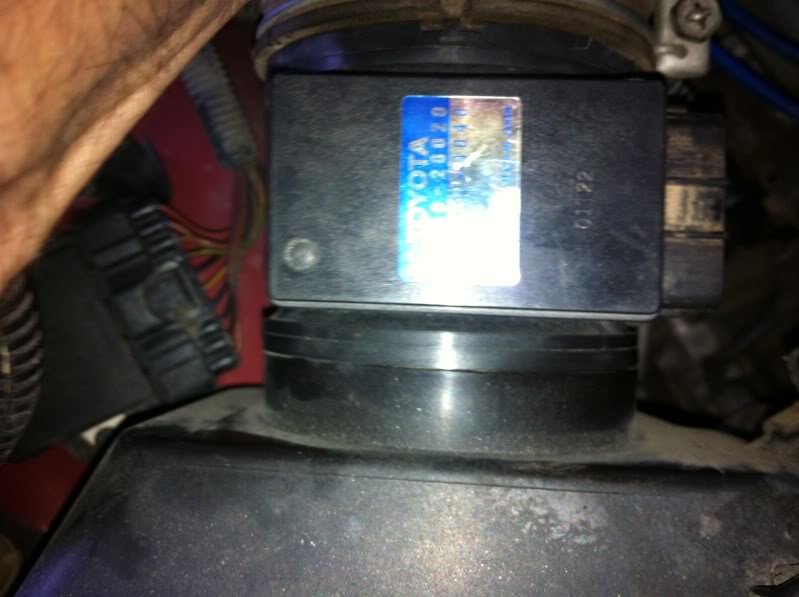

    Took everything apart to clean the MAF, throttle body, change spark plugs and spark plug wires.
    Put everything back together, I mean there's only one way for it to go back together... and I noticed a tiny gap between the air box and the MAF sensor. 1/16th of an inch at most. Is this going to be a problem? Obviously the MAF sits inside the rear port of the air box far more than a 1/16th of an inch. Just wondering still if this may be a problem. See pics below.
    First pic is the gap.

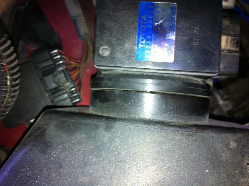

    Second pic is me slightly pushing it together removing that gap. When I let go the gap appears again.

    Mine has that. shouldnt be a problem

    Total engine failure. Maybe throw a big ziptie around it while pressing in so it seals a lil better? Or a giant hose clamp.

    Does the air leak out of the gap?

    Partial trolling...partial honest response...obviously that isn't going to cause an entire engine to sieze, but i would definitely throw something around that to try to get it to line up better with no gap.

    I'de loosen every clamp on the intake hoses that I messed with, finesse the hoses and see if the gap does closes. My guess is the hoses are kinked.

    on the MAF mine did the same thing I think I loosened the 2 10mm bolt a bit and squeezed it together tight.. and then tightened.
