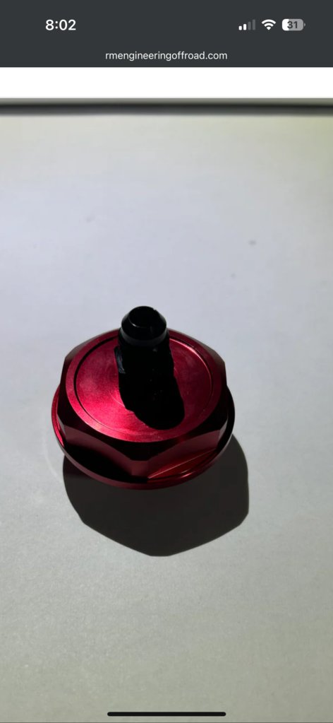

  9. Apr 5, 2025 at 5:04 PM
    #49
    Josephray70
    Josephray70 [OP] Well-Known Member
    Jun 1, 2024
    #450775
    602
    Joseph
    Grand Rapids, MI
    2017 Toyota Tacoma limited
    Bilstein 6112/5100 at 2” (6/8 circlip, 3/8” top spacer, sway bar drop bracket, YotaWerx Black Hawk 2.0 tune, Borla exhaust, Freedom Off-Road UCA’s, Alphrex Luxx Series smoked taillights, Westin bull bar, 265/65r18 Cooper Rugged Trek tires, 18x9 Anthem Off-Road wheels -12 offset, 4.5 backspace.
    Looks to me that the pcv valve is in the oil cap…from this pic:IMG_2375.png
  10. Apr 5, 2025 at 5:06 PM
    #50
    4x4junkie
    4x4junkie Well-Known Member
    Dec 19, 2018
    #276335
    645
    So Calif. (SFV)
    2018 TRD Sport ACLB MT
    I think that's just an AN fitting, but confirm with RM.

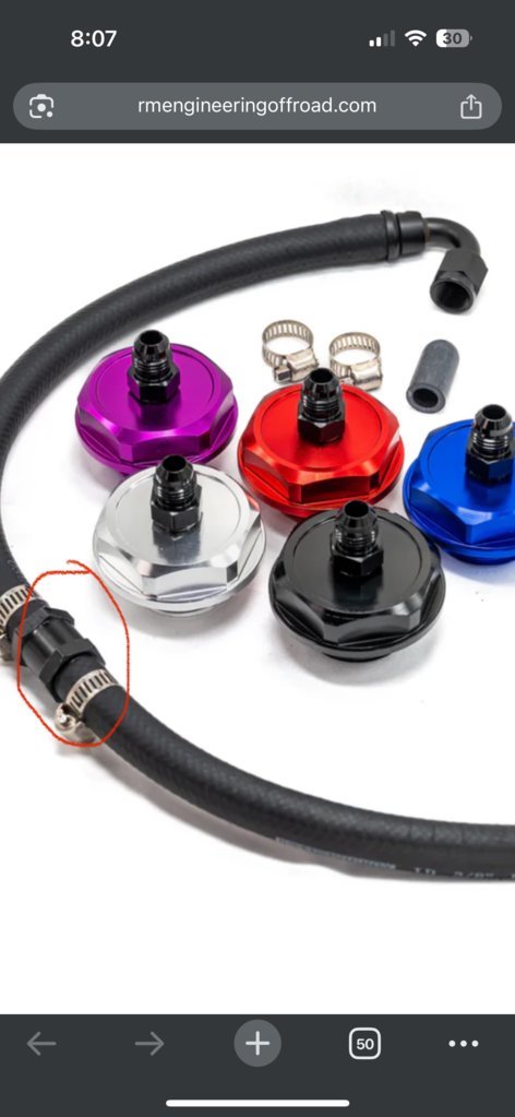

  11. Apr 5, 2025 at 5:09 PM
    #51
    Josephray70
    Jun 1, 2024
    #450775
    602
    Joseph
    Grand Rapids, MI
  12. Apr 5, 2025 at 5:13 PM
    #52
    4x4junkie
    Dec 19, 2018
    #276335
    645
    So Calif. (SFV)
    Their page is lacking info, but maybe there are some different options available? (page has on it: "-120 degree fitting and PCV capped option shown in pictures"), again I don' know.

  17. Apr 5, 2025 at 6:48 PM
    #57
    4x4junkie
    Dec 19, 2018
    #276335
    645
    So Calif. (SFV)
    Had to watch his Moab video afterward, Moab is still one of my "bucket list" destinations (can't help but comment at 11:06: "Needs moar lift"!! lol)
    https://www.youtube.com/watch?v=BPsCeaXshgk
    So it sortof mentions what the thing spliced in the hose is... Does sounds like a valve of some sort.
    Again you'll have to find out from RM for sure what it is.
    I think you're failing to understand that the engine is not being left without any PCV at all with this kit, all this kit does is REROUTE it (the OEM valve might be capped off, but as long as another new valve is installed to take its place, then the system function is unchanged from before (other than when the oil pools at the back of the head while pointed uphill, you're no longer sucking it into your intake). Even if there was no new valve, the system is still not "plugged" (as was the demonstrated concern in that last vid), the engine simply just wouldn't have the protection against fuel vapors and other gasses entering the crank case during, say, a backfire event that a PCV one-way valve provides (how often does that happen on modern EFI engines anyway? It's not unheardof, but very rare).
    Again, call RM, and see what they have to say. At this point, I really think you are overthinking this PCV valve (in it's worthless location) being capped off.
