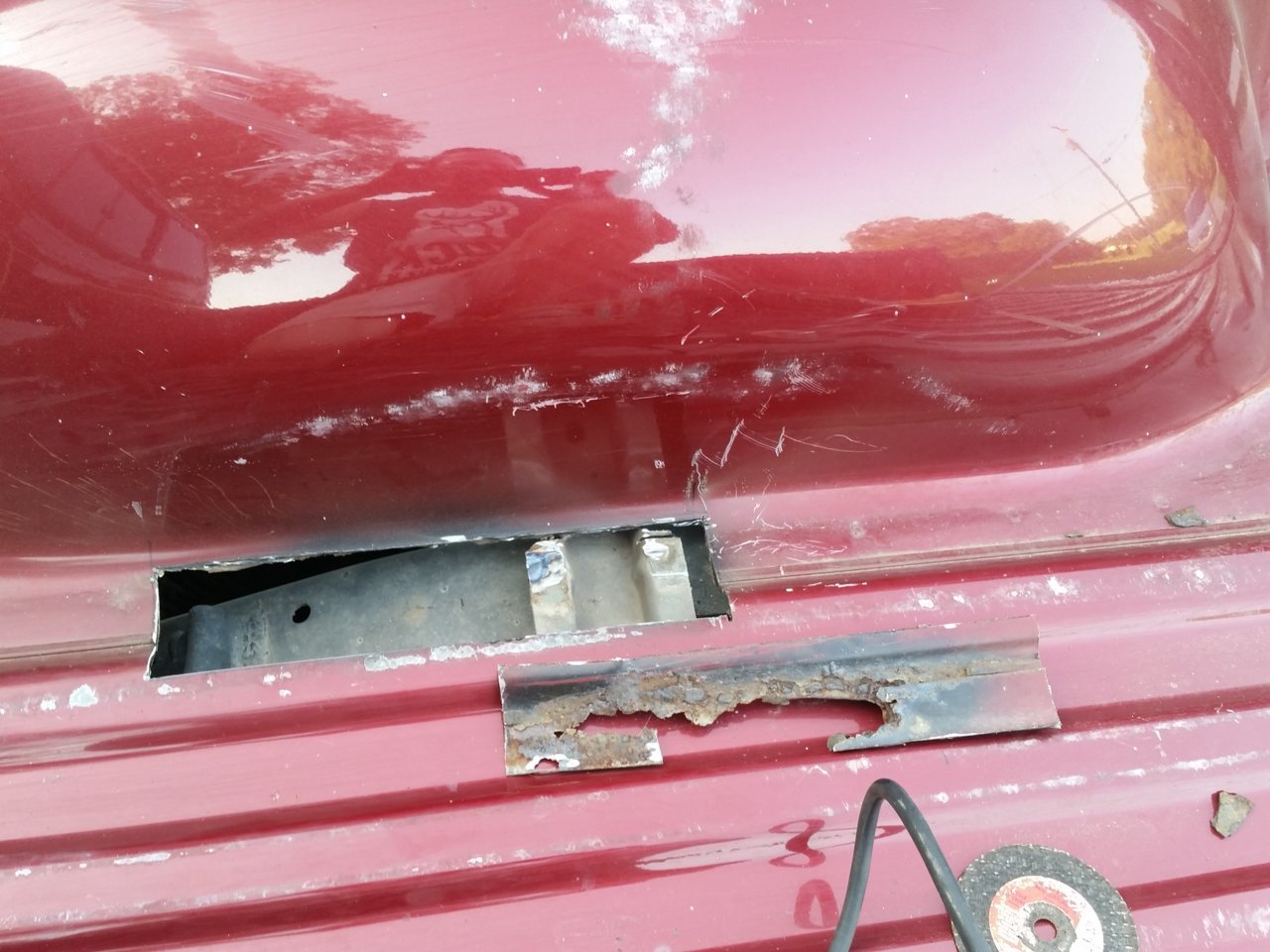

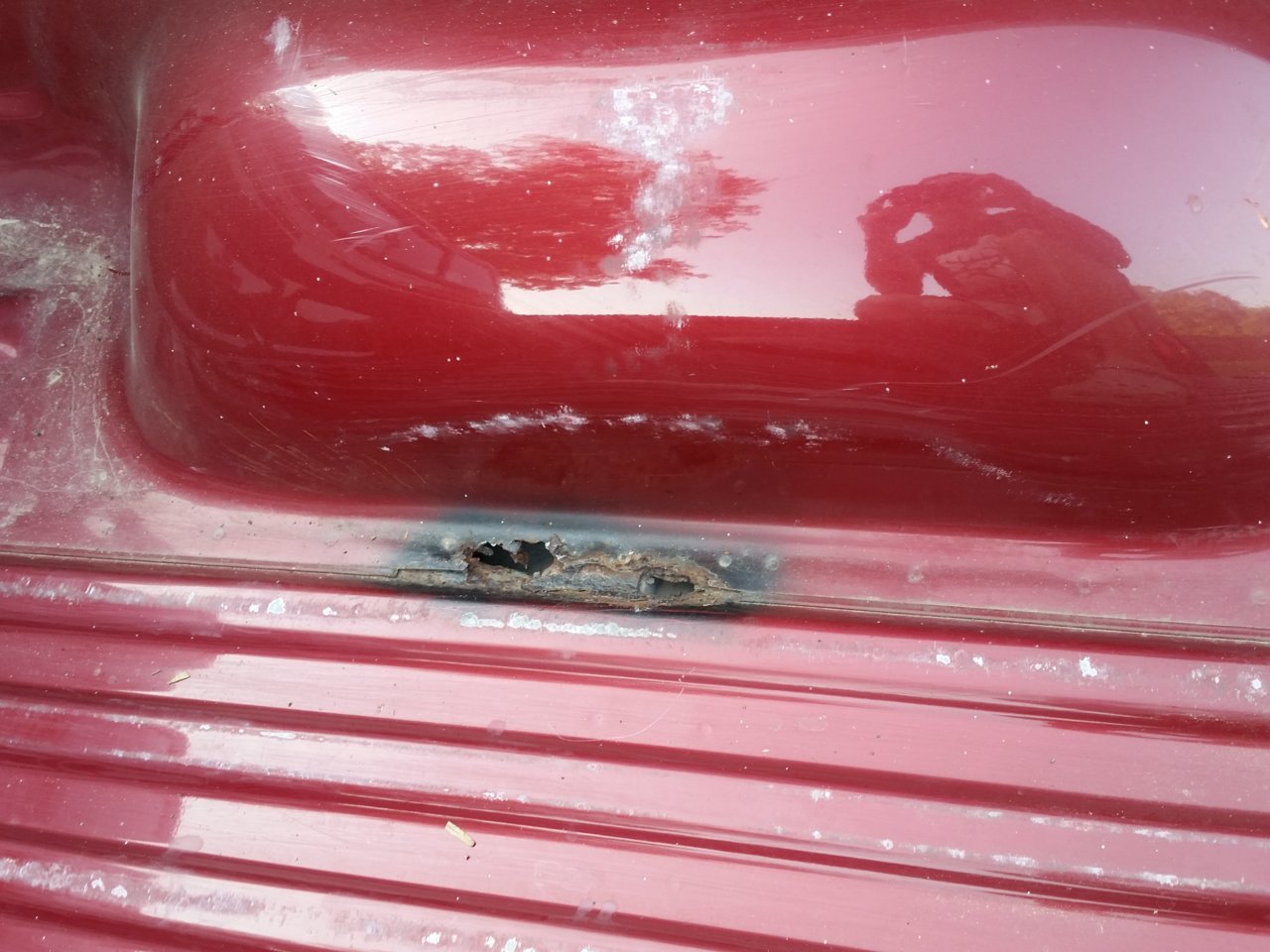

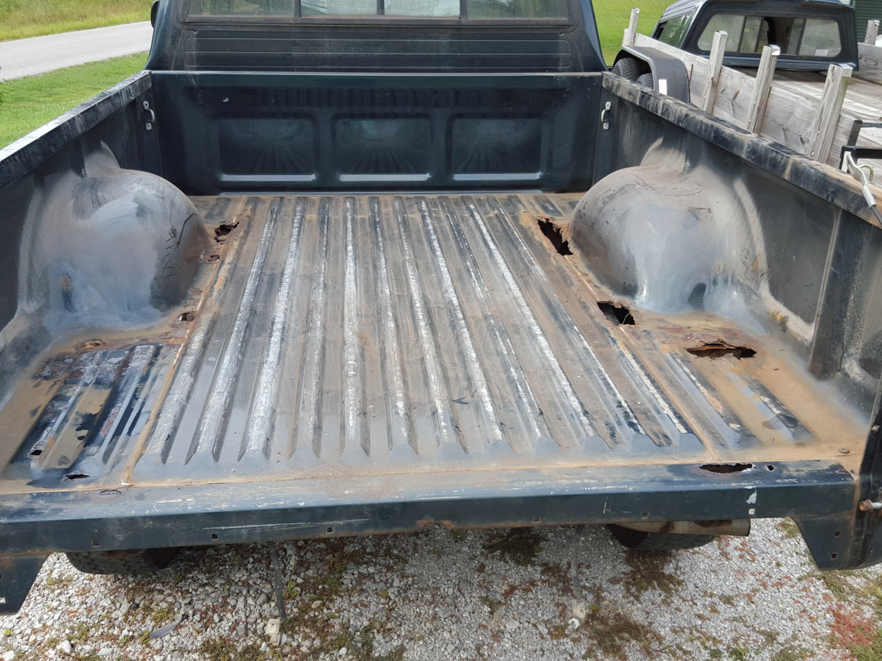

    I noticed this spot under the bed liner a year ago. I thought about cutting it out then but I sprayed some rust control on it and put the bedliner back in and hoped for the best. Well, I pulled the bed liner the other day and discovered that the cancer had worsned. I decided to remove it today. I used an angle grinder with a cut off wheel and an oscillating tool to make the cuts. I plan to fab a piece of sheet metal and weld it back in. Looks like 19 or 20ga steel. This is a very clean 2000 Tacoma that's been in TN and AL it's whole live. Frame appears rust free.

    Nice job. Got it before it metastasized. Gonna weld another piece on?

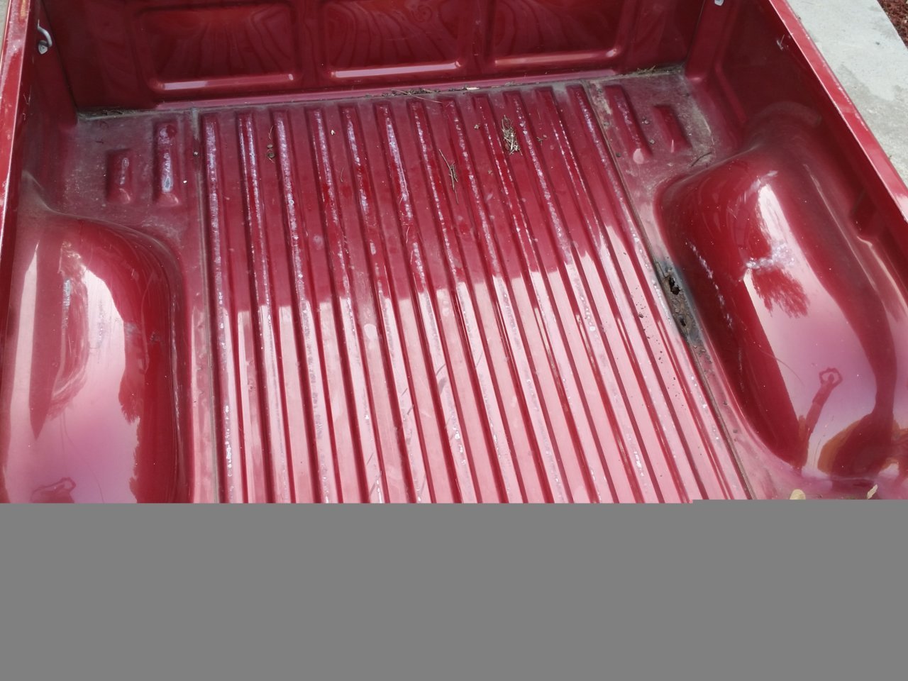

    Yep, gonna fab a piece and weld it in. I've been wanting to do a spray in bed liner but couldn't make peace with this rust location and kept putting it off.
    My wife had basil cell and squamous cancer above her eye 4 years ago and I used the same mentality the surgeon did....remove past the cancer.

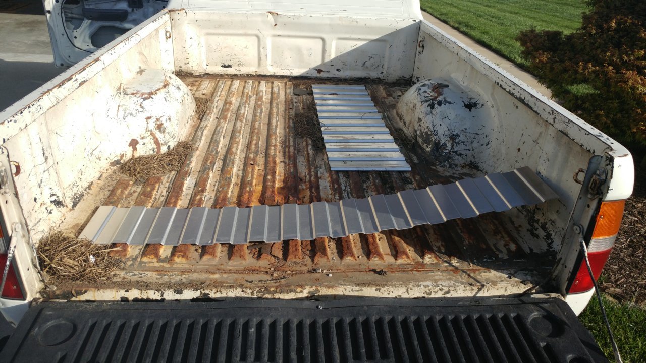

    I think I can agree from what was under the bedliner when I bought my 95...you mean like this

    Yea, plastic drop in bed liners are not a smart idea.

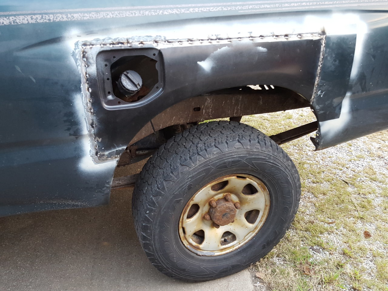

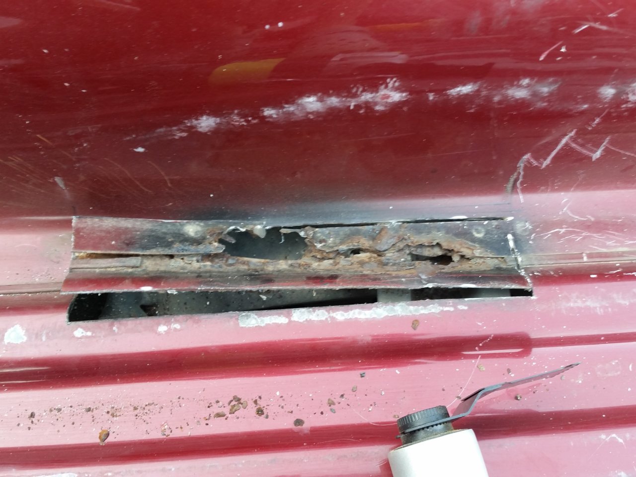

    did patch my bed too. It did rust in the exact same spot
    it also had a smaller hole towards the cab (see it on the pic), I did turn it into a drain hole :p
    anyway, the thing with plastic bedliners is that you have to regularly remove it to clean underneath it (and do some paint touch-ups), otherwise the bed floor will rust

    @onakat that turned out real nice.
    I repaired mine by attaching some thin aluminum coil stock material from the underside then using a fiberglass compound. I just rough finished and painted it since I had planned on running a bedliner again anyway. If I hadn't planned on covering mine with the liner, I'd have went with metal as you did.
    I used metal on both sides of the outer part of the bed. I'm an ama20161005_130739.jpg tuer on body work, but Harbor Freight sells a crimping tool that makes a small step down "ledge" to insert new panels on and it reduces the amt of body filler to cover the tack welding.

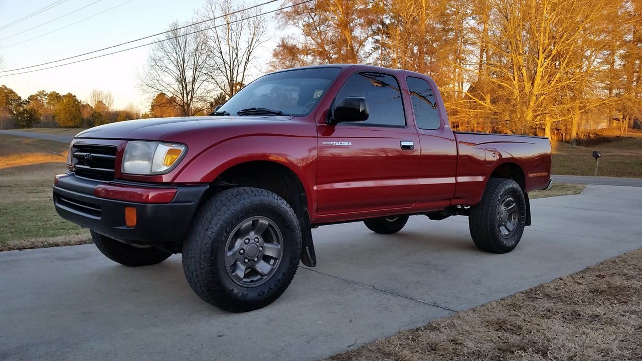

    Thank you. Paint is original(except front bumper and grill). There are plenty of paint chips on the hood that I keep touched up. Paint was a bit tired when I bought the truck a year and a half ago. Here you can see truck before I did anything. https://www.tacomaworld.com/threads/2000-4wd-ex-cab.519490/

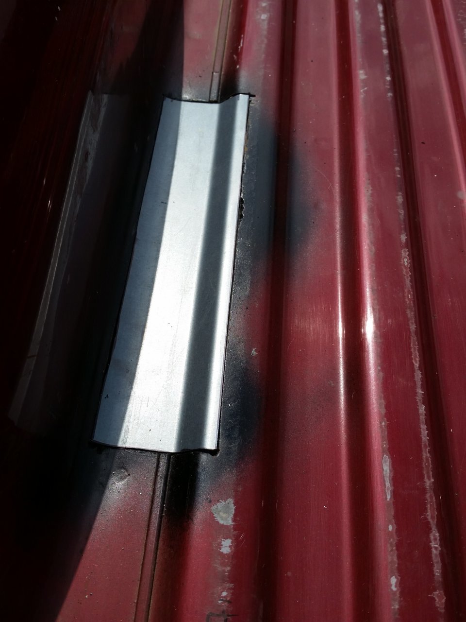

    Bought a piece of 19ga metal from McMaster Carr. Cut it a little oversized and started bending. First try was decent but the rib height was off too much. Here's the 2nd attempt after I trimmed it to fit. Gotta weld it in next, and try not to burn a hole through it. LOL.
