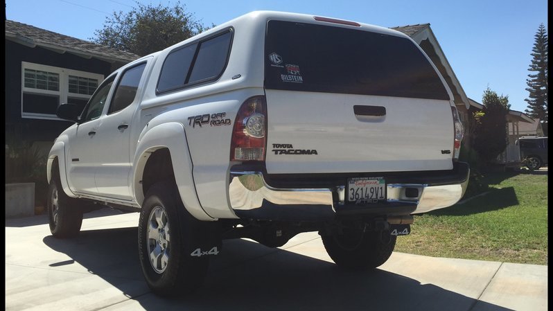

    FJ to Taco
    FJ to Taco Well-Known Member
    Mar 10, 2015
    #150578
    504
    Tony
    Lacey, Wa
    2015 DCSB 4x4 TRD Off Road,Snugtop Rebel
    Bilstein 5100's all around, OME 885's and OME Dakar CS047R Leaf Packs. Snugtop Rebel, pet screens,front slider drop down window. WeatherTech mats. Interior LEDS
    I would leave it as is. My truck rides great. not harsh at allTaco2.jpg Taco5.jpg
