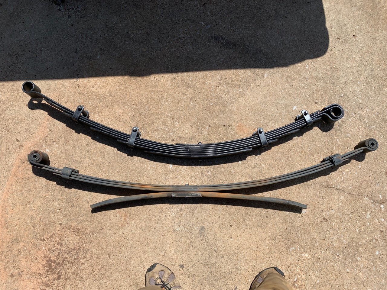

    I installed All Pro Expedition leaf packs back in May with the plans of loading out my truck. Then 2020 got into full swing and I've not built out my truck. Needless to say it raised my truck a good 3-4 inches in the back.
    I called Wheeler's, since I purchased from them, and asked about removing a leaf. They hadn't had anyone remove a leaf from these springs yet. He said on Dakars they remove 3rd leaf from the top.
    My question is, does anyone have any experience in removing a leaf from All Pro Expedition Springs?
    Attached is a photo of the stock spring and the expedition spring when I installed them.

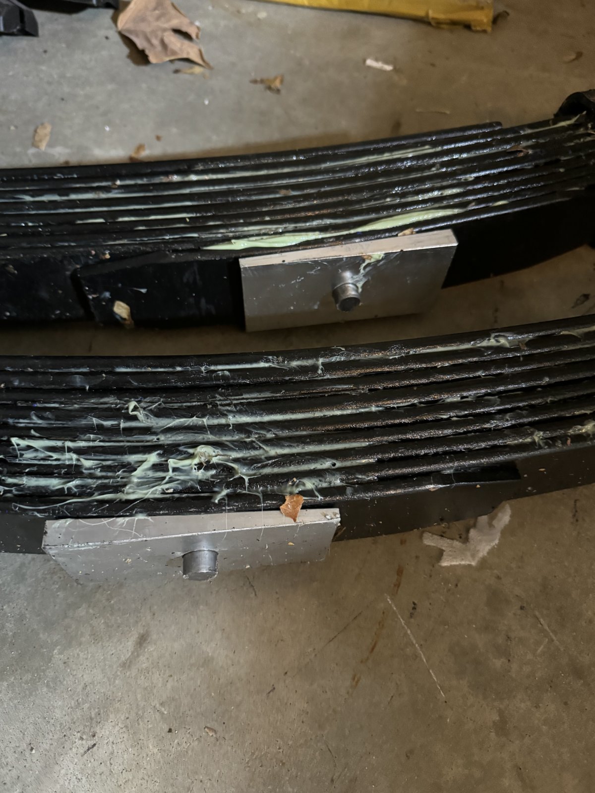

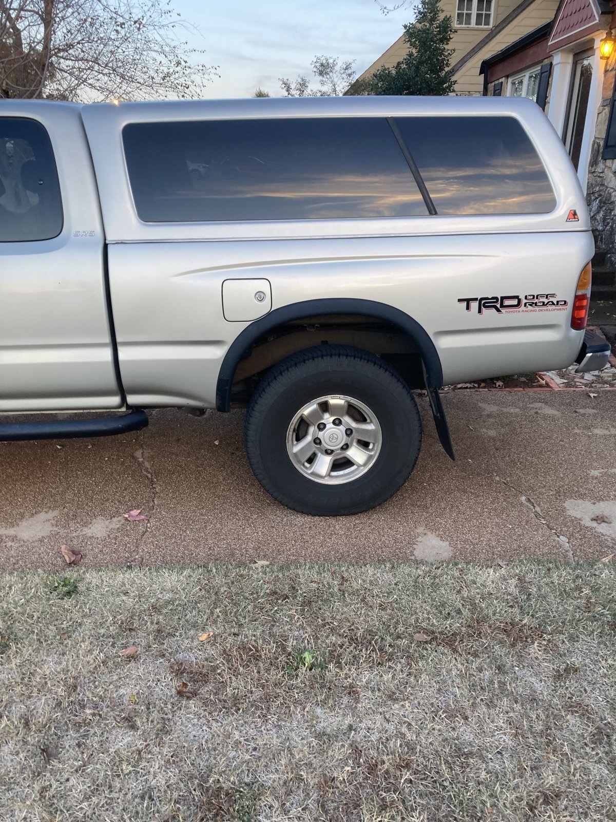

    Welp, I went to give this a shot today. I don't think it can be done, at least not with the AP Exp springs I have (bought Jan 2021). I ended up with 4.5" of lift off of these springs (Leer 180 topper is only weight I normally carry), passenger side settled to 4". Driver side to 4.2". I want to drop back down to 2-2.5" lift to get a 1" rake, my plan had been to remove the second from the bottom and third from the top.

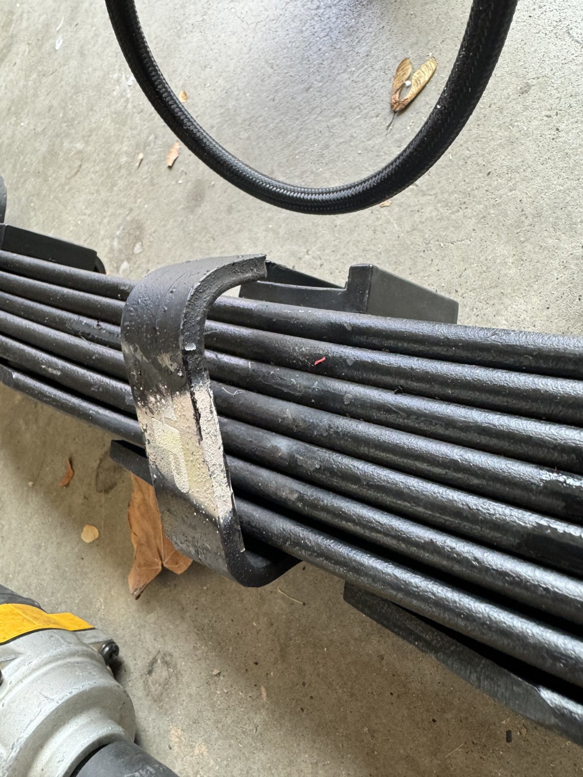

    First problem is that you cannot release all tension from the spring pack. Forward of the axle, there are two metal sleeves wrapping the leaf pack (different from the first pic in the current thread, but visible in first pic on this thread). They look to be machined in place and would require cutting or bending the metal to get it to release.
    Second problem, second leaf from the top connects to the forward bolt and bushing. It cannot be removed. Third leaf from the top wraps the rear bolt and bushing and cannot be removed. First from the top is only a half leaf (axle forward). Maybe 4th from top could be removed if you could release leaf pack tension. So Wheelers/AP suggestion don't seem functional.
    Bottom leaf would be easier to remove, only held on by through bolt. But doubt you lose more than 0.25" of lift with that.
    Sadly, I'll be buying a new leaf pack. Probably Dakar or Icon.

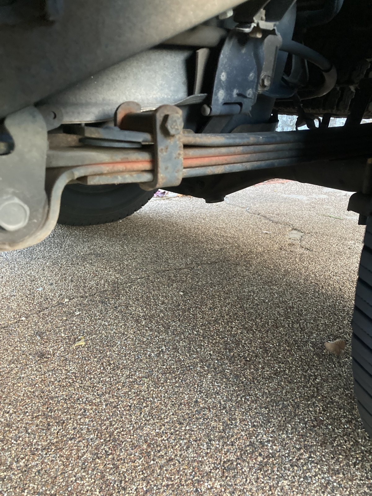

    Mine didn’t have clips like yours. They had U clips with nuts/bolts. If you scroll up to top of feed you can see my pic of what I’m talking about.
    if I had it to do over I’d probably have gone with OME and been done with it cause it was a PITA putting them on and getting a spacer for the carrier bearing. Having vibration. It was just not worth it for a gen one truck. I even toyed with the idea of deleting the carrier bearing altogether and going with a custom single drive shaft.
