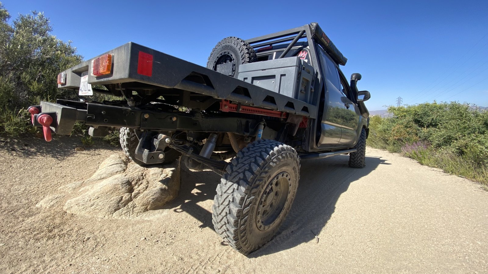

    My tray is a lot lighter than my last setup steel swing out bumper shell decked drawers and it was nice but now I have significant less weight also 5125 Billie’s perhaps it’s the shock that need to be swapped with something different? I am making drop down side and tailgates about 50lbs each (x3) I don’t carry anything in the bed around town for daily driving and the rebound is horrendous

    if you aren't carrying weight on a regular basis that pack is overkill.

    Yes I’m figuring that out I thought the tray I built would be heavier but it turned out to be lighter than stock lol and trying to work with the pack I have vs purchasing new ones

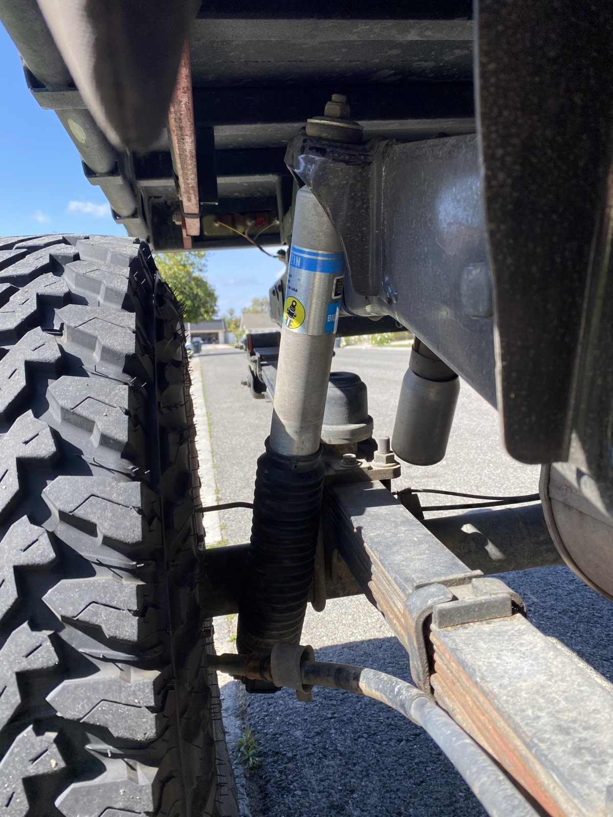

    2014 Tacoma V6 4.0L 4x4 AC FLATBED UTE

    yikes the pinch type, I hate those, they always make the suspension stiffer. Also limit movement, or articulation.
