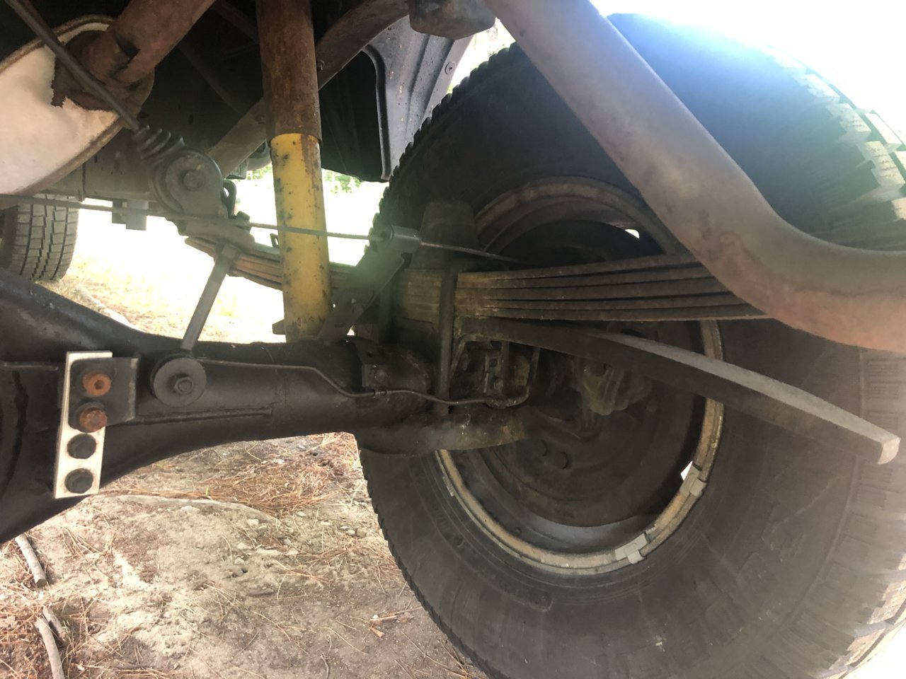

    I will take a pic, its got a monstrous overload leaf.... nothing like above

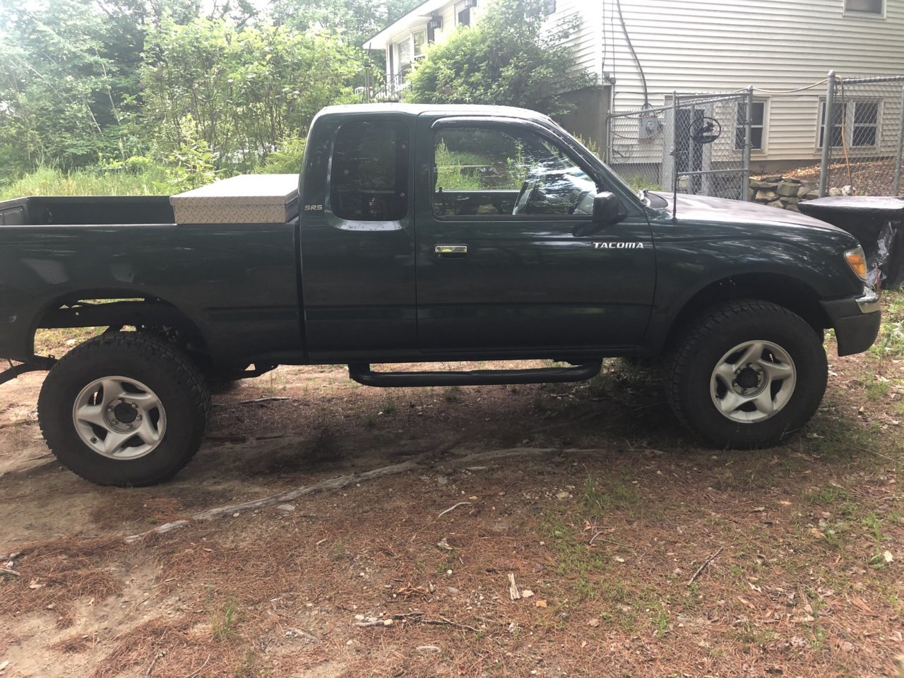

    This is why I want to drop the rear someD3F8D7C0-759F-4CBF-AEB4-6FEBB34A8F1F.jpg946CBBDE-DD9A-44C1-8536-3B764593ED25.jpg

    I imagine if I got rid of the 2x4 of a spring it will land where I need it.
