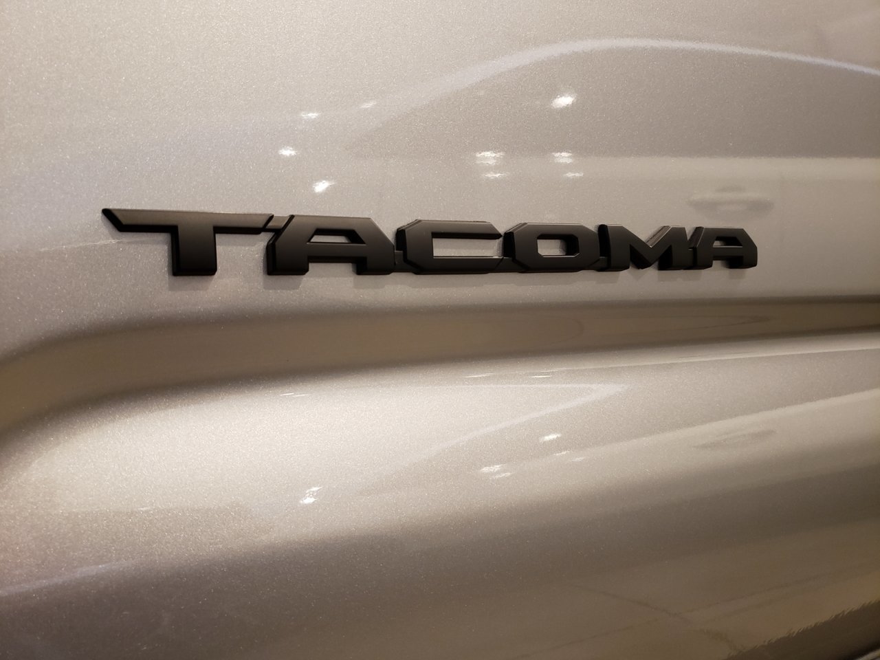

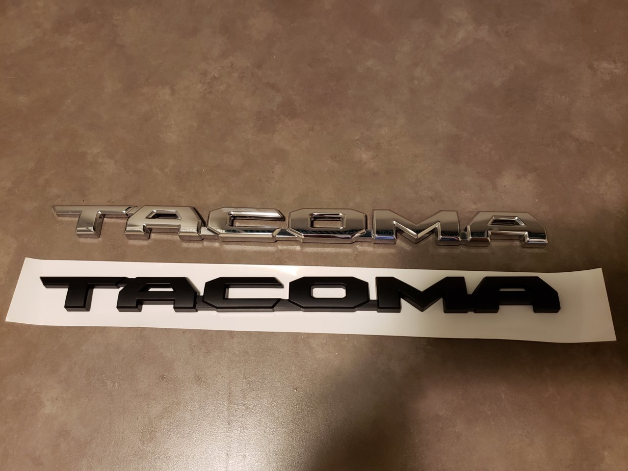

    I ordered the black emblems off eBay, just installed them. Really good quality. The two sided tape was installed perfectly so attaching was very simple. Seller was shipshop101 if anyone is interested. Took me a while to locate the exact same font in black.
