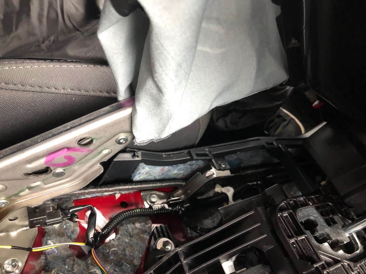

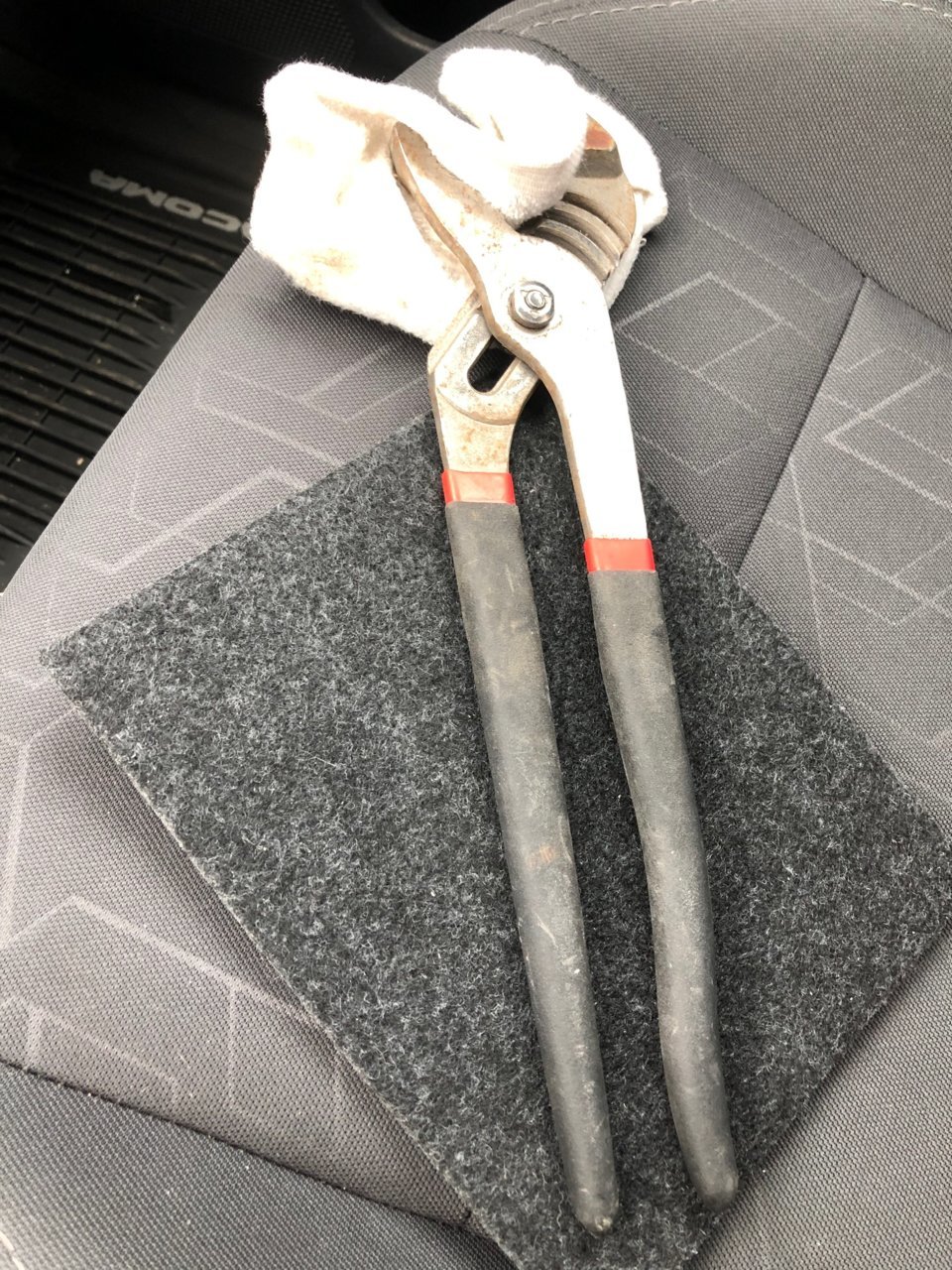

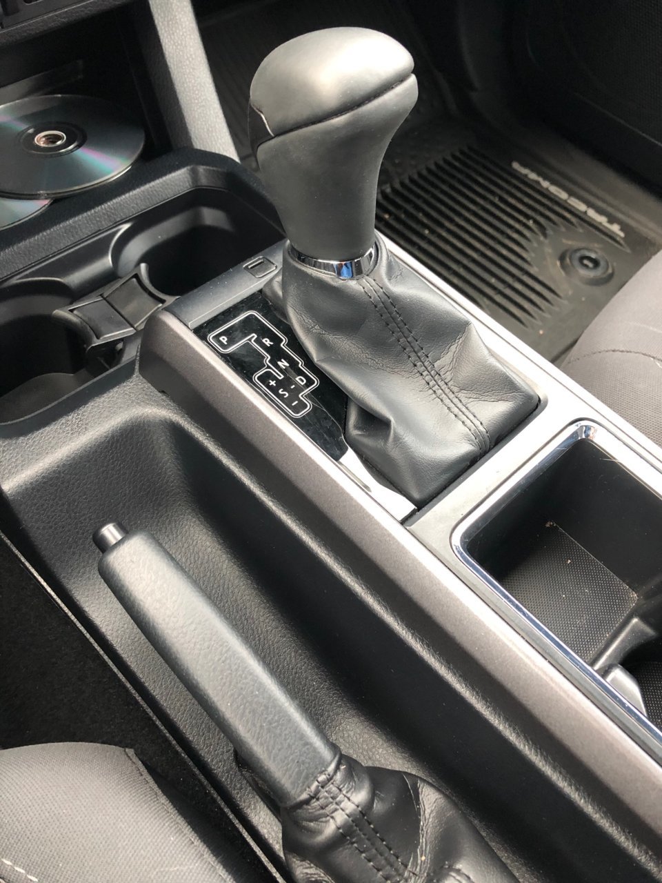

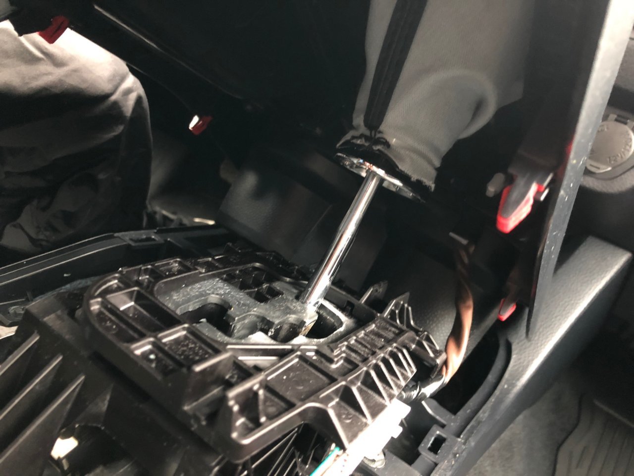

    I'm removing the center console so I can use my newly acquired (as of today) truck on my rural mail route. I'm having difficulty twisting the gear shift knob off so I can remove the console as well as I don't know how to take the emergency brake handle off. Both have to separate from the sock, so the console the levers can slip through the console as it's raised off from the floor and out of the truck.

    Pull the chrome ring down from the shift knob, the knob can then be unthreaded.

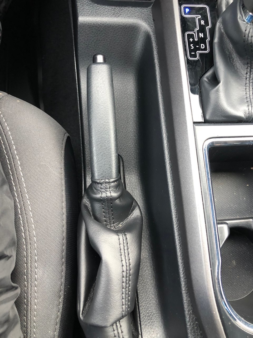

    This was incredibly helpful yesterday. I got that part done. Any idea how to do it for the emergency brake lever and its sock? Do I need to get a knife and cut the sock off?

    I hope you haven't cut the brake handle boot yet. It is just tightly wrapped around a small groove in the end of the handle. Some wiggling and pulling was all I needed to remove mine. You could try a little silicon spray too.
