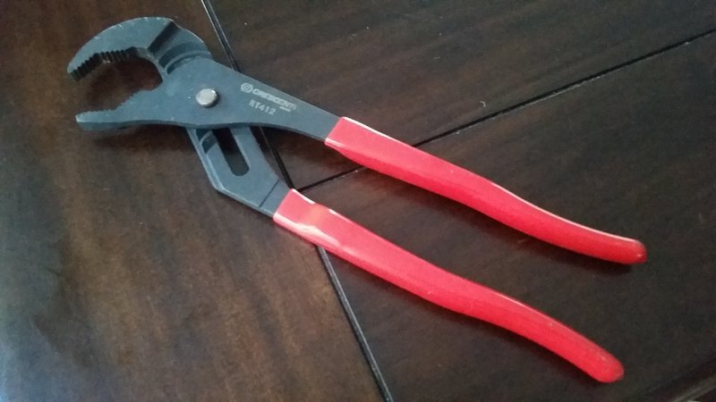

    How do you guys remove the stock front bumper stops? I borrowed a 45 mm wrench from work and even that was too small.

    big pair of channel locks. They should come off easy.

    Yep. Break free with channel locks, then unscrew by hand.

    Oil filter wrench

    I used a strap wrench.

    Channel locks and craploads of pb blaster. If you break the bolt, loke so many of us have, you will have to drill it out. PITA.

    What size channel locks lol

    Big enough to open up to four inchs.

    where do you even find those haha my home depot doesn't have em

    Harbor freight.

    They Would have a pipe wrench

    ok i'll look for a pipe wrench

    Got some channel locks and sprayed PB blaster 3 hours before and they came off with ease

    took 5 minutes to do both
