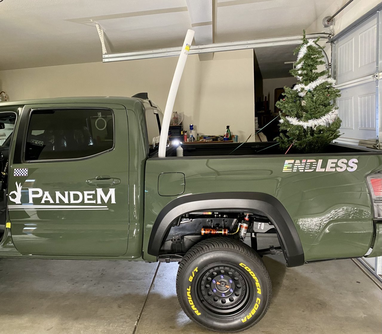

    hey guys long time car/truck guy here. currently daily-ing 3rd gen taco stick shift (trd o/r). modded for old school 2wd prerunner feel from 90s.
    goal is to get rear locked in 2wd mode. im aware of the "gray wire" mod for 2nd gen and some complex schemes for 3rd gen.
    looked under truck and front driveshaft (the skinny one between the front end and transfer case) looks easy to unbolt and remove.
    if disconnected, would that effectively disable 4wd by preventing the front axles from being engaged such that i could put truck into 4lo with rear locker on and drive (fast) and drift like having a 2wd with a locked rear diff?
