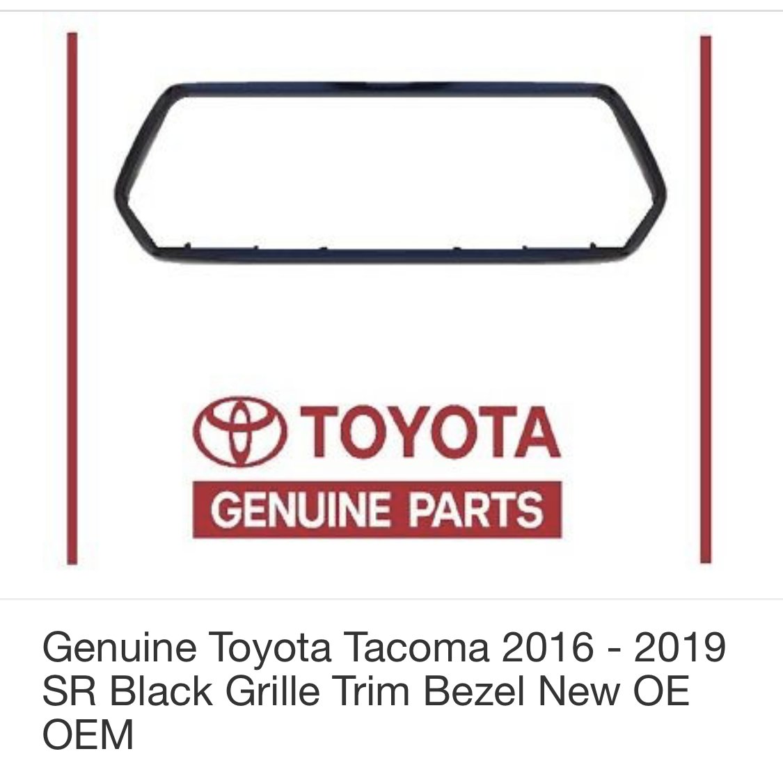

    So, is it necessary to pull the whole grille to swap just the bezel trim??? I will like to get the black one.

    Holly Crap?! There's a search thingy that does this?
    Man? What will they think of next???
    All this time I've been wasting my time randomly looking for sites that people post up questions on asking other people for help?:anonymous:
