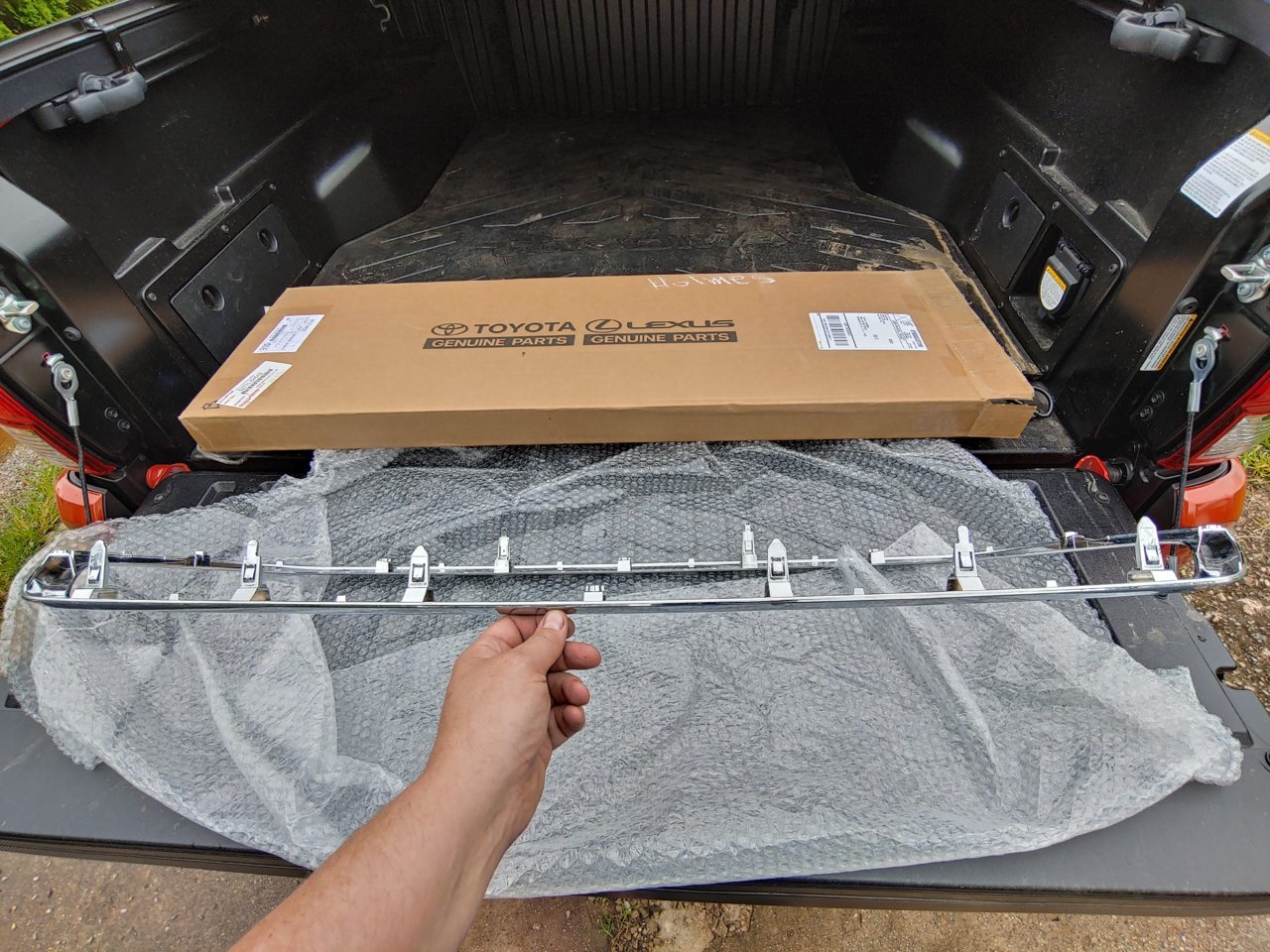

    You will ned to remove the whole grille. Its really just two 10mm head bolts and two plastic rivets. Pull the inner portion of the plastic rivet up with a knife or flat screwdriver. Then a good tug. Lay the whole thing on a blanket or bubble wrap.
    The reason you need to remove the whole thing is those screws are short and you can not get to them with the assembly still in place. You would spend more time fussing and cussing and still end up removing it.
    As said before, just the chrome tabs and a lot of screws and its done.
    This will give you an idea of the tabs and screw placement
    Parma, Simon's Mom and mhowe441 like this.

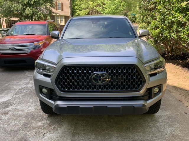

    Just found this video today and just ordered an OEM black bezel off Amazon.
    Not the best video but @2:20 and on it can give you a good idea

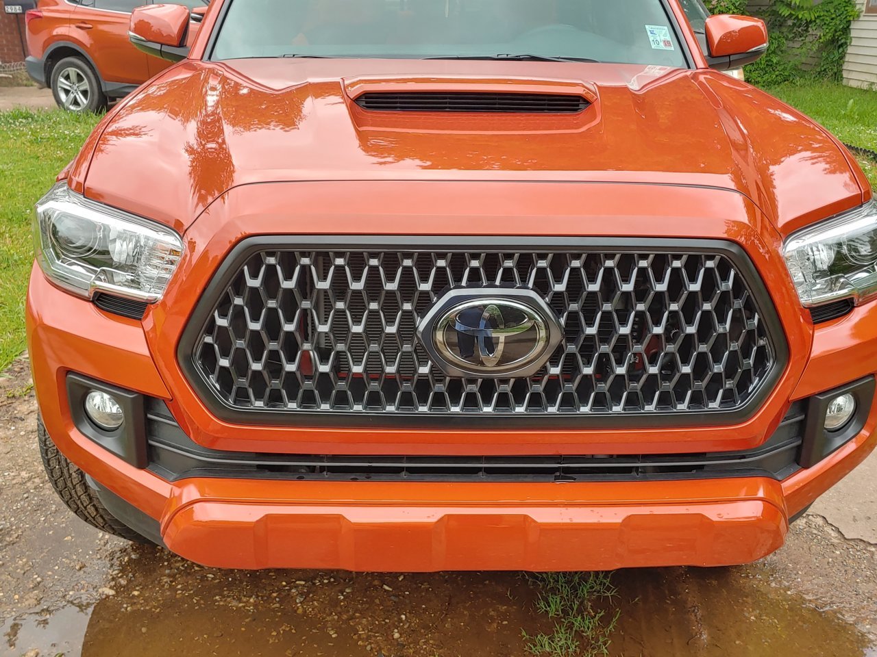

    7A1F97E1-CF0F-46B1-A0F1-C0A80697A1BC.jpg Just finished mine. Probably took about 35-40 min just being extra careful. I couldn’t be happier! That chrome was bugging me to no end. So much better now.
  20. Apr 28, 2020 at 1:07 PM
