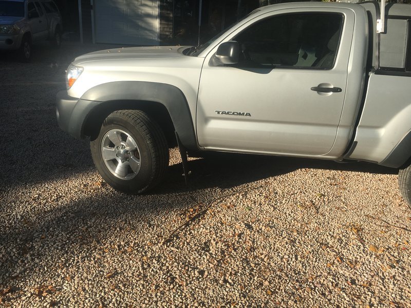

    Short version: I want to take my tinted windows out of my doors, put clear ones in and go get a state inspection sticker on it, then put the dark windows back.
    Door panel removal is not a problem, just can't find a video or write-up on removing/installing window glass itself.
    Anyone know how?
    Heading out to run some errands now then I'm taking the door panel off when I get back, maybe I will be able to see for myself how to do it but any help is appreciated.
    (2006 Regular cab, manual crank windows)
    Thanks!

    They're not even that dark! D-bag I bought it from was adamant that it was inspectable with the tint but he was full of it. I have just grown to like the look and I am now determined to circumvent yet another law I don't feel like obeying.

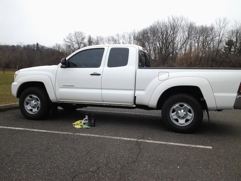

    im concerned about mine passing inspection too I purchased it with tinted windows too from a dealer used, I got a sticker till 2018 I hope it will pass when the time comes, I don't know what the alternative is if it doesn't.

    Front windows are your only concern in most areas, my reasoning is that since the sliding glass windows are on tracks and not permanently fixed I can DIY a swap for only the cost of new glass. I will not get pulled over for the tint, but I will get stopped for having no sticker lol.
    Edit: yours looks pretty dark tho

    it came this way from Virginia, when I bought it, took quite awhile before my eyes adjusted to it, I haven't had problems with the law about it

    Can't say I'm surprized you haven't been bothered, it looks totally unassuming to passerby and police alike, just an incovience if you're suddenly told it is out of line, good luck in 2018!
