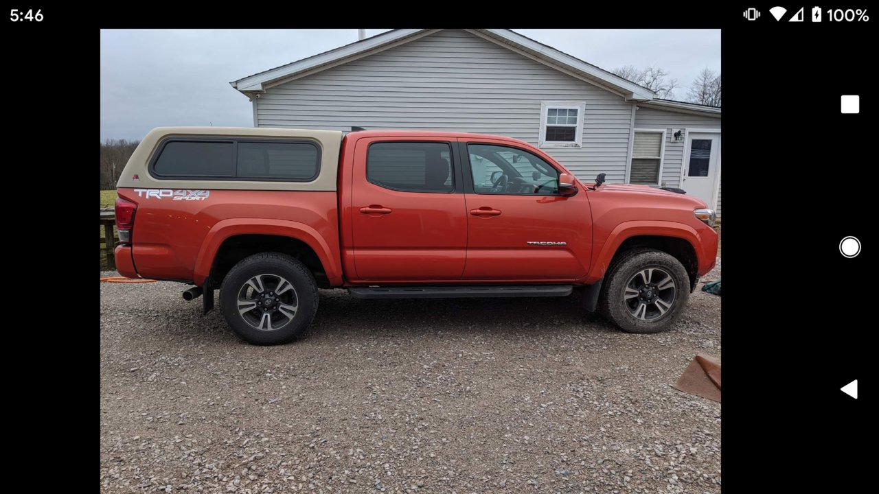

    Do the sumo springs, i love mine i did the 1000# kit made for the 2nd gen you get a bit of a lift and it cures the taco lean, i also have a shell its a leer mx i have the trd sport suspention

    2018 Tacoma TRD Sport Quicksand DCLB (SOLD), 2004 4Runner Sport Edition 4x4
    Hmm that looks really interesting I’ve never seen that before
    When you get around to it, would you mind taking a few pics of yours installed?
