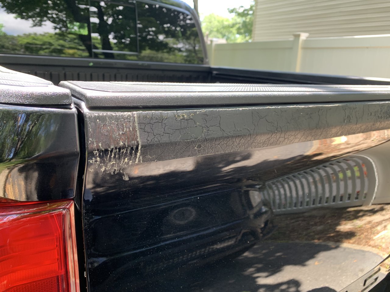

    Before I go for the old razor blade and goof off removal approach. Has anyone gone through this without damaging or changing the paint surface?
    Currently it is very easy to pull away the old adhesive with a fingernail.
    Any recommendations would be a lot of help.

    Anyone familiar with this type of adhesive from an old bed cover?

    Typically heat and rub and goo gone to remove adhesive. Definitely leave the razor behind.

    WD-40

    Try Goo Off. I used it on old 10 year old sticker residue on my tailgate. Works wonders.

    I don't know if this will work but it it is practically free with a low chance of damage. Get a rag, lay it across the goo then pour rubbing alcohol on it and let it sit for a couple minutes then see if you can wipe it off...

    I have no idea what nail polisher remover would do to paint, but I used my wifes bottle to remove sticky tape residue from my convex stick on side mirrors. Tried a bunch of other products, and the nail polish remover took the glue residue off in seconds. I just dabbed it onto a soft cloth and started to wipe and it came off very quickly. I guess you could test on a small portion of your tailgate. The stuff is really hazardous though, use rubber gloves and in a well ventilated spot. Plus wash the vehicle right away to remove any residue that might affect the paint.

    The strongest isopropyl alcohol you can find. I use 99.998% at work and its phenomenal for removing adhesive. It will also remove all of the moisture from your skin so gloves or lotion afterward will be the right move. High-test like that is hard to find though.

    It doesn't usually dissolve the adhesive like a solvent thins oil, it often makes the glue almost dry up and roll off in little globs. It's also the best thing prep solvent you could hope for when it comes to applying an adhesive tape. It's a fantastic solvent and dries super fast. A perfect example is the ol' standby red 3m double sided tape; a swipe of this with a lint free rag and you're good to go. It's also used for surface prep for window urethane and getting the urethane off of you afterwards. Urethane and butyl, man... while they are incredibly useful and flexible, they are also like car herpes... it gets everywhere and you'll never find the source :laugh:
    Before you go at it with the alcohol, if the glue has any tack left to it, try more tape to pull it off. It's an oddball old school trick. Good for stickers on stuff you just bought like laptops or appliances.

    Don't!!! Nail polish remover is diluted ACETONE. This stuff will strip the paint before you can wash it off.
    Try hair dryer or an oil base solvent. An old credit card can function as scraper.
