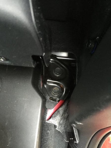

    Then I pulled out the covers on the back panel and removed those bolts.
    Yanked off the headrest cover plate
    and the child restraint covers (at the bottom of the panel:
    Big tank and voila:
    Here is a picture of the rear panel from the back so you can see the different clips and snaps:

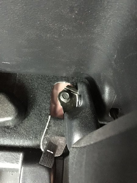

    I removed the buckles.
    Now this was the only part that was tricky. I couldn't remove the panels on the side easily. I would recommend removing the bolt under the rear SRS hatch. I mangled this guy getting access to the bolt.
    Then I pulled off the panels and removed the bottom seatbelt roller first.

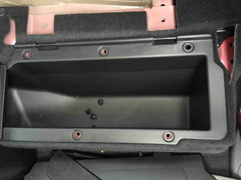

    I removed the child restraints at the bottom
    I removed the console in between the seats.
    I removed the underlying cubbyholes as well.
