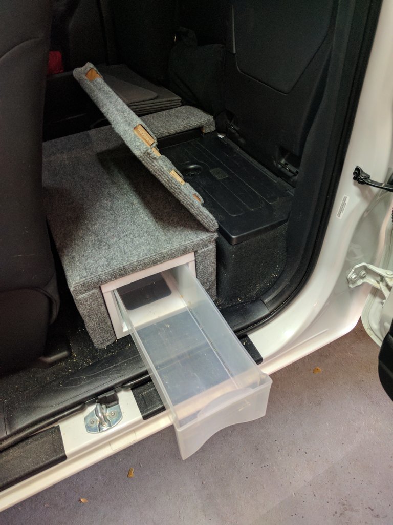

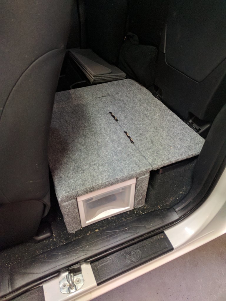

  20. Sep 29, 2017 at 10:41 PM
    #40
    Efus1687
    Efus1687 Well-Known Member
    Dec 31, 2016
    #206194
    86
    17 Taco SR5
    Some inspiration
