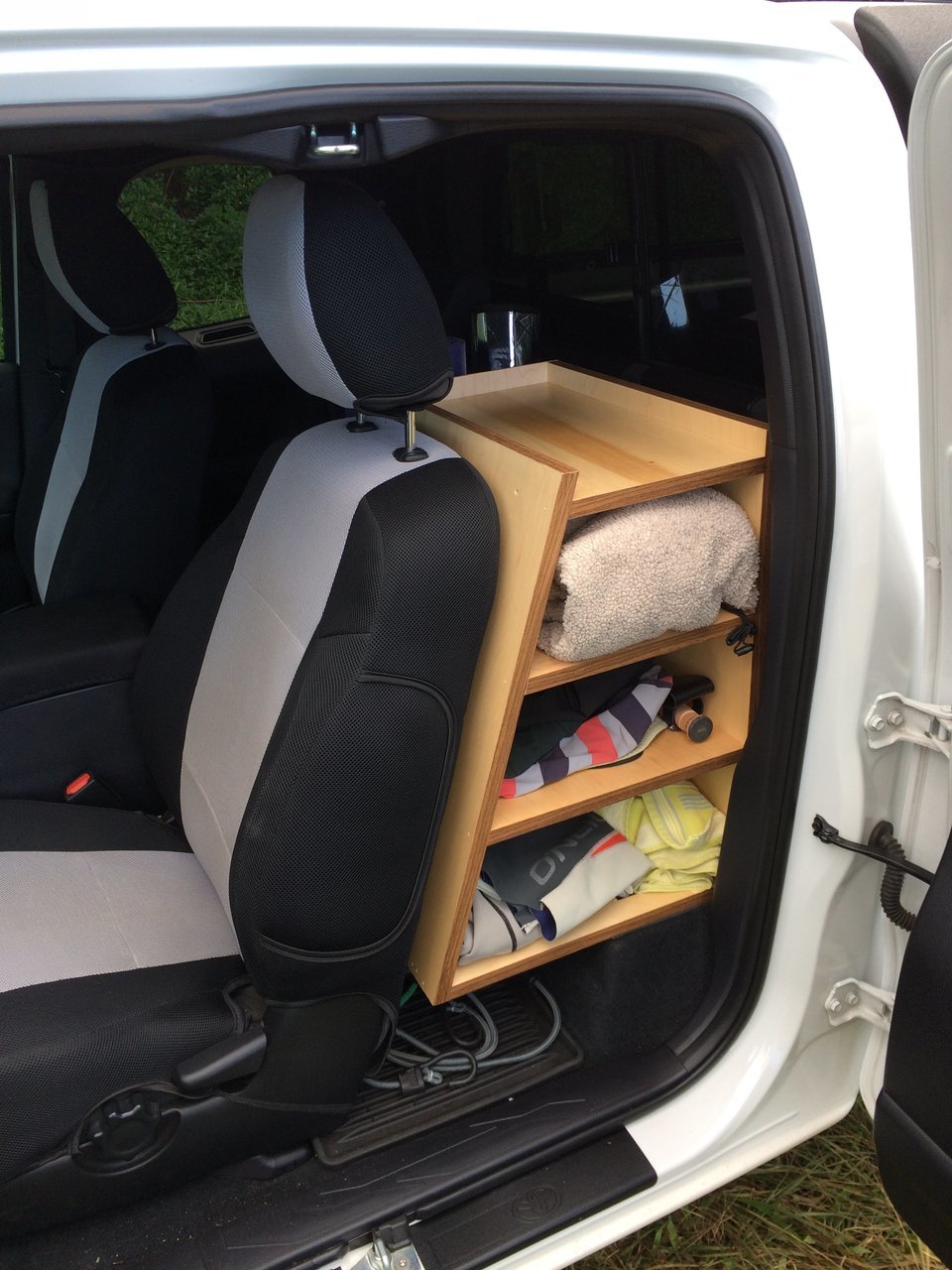

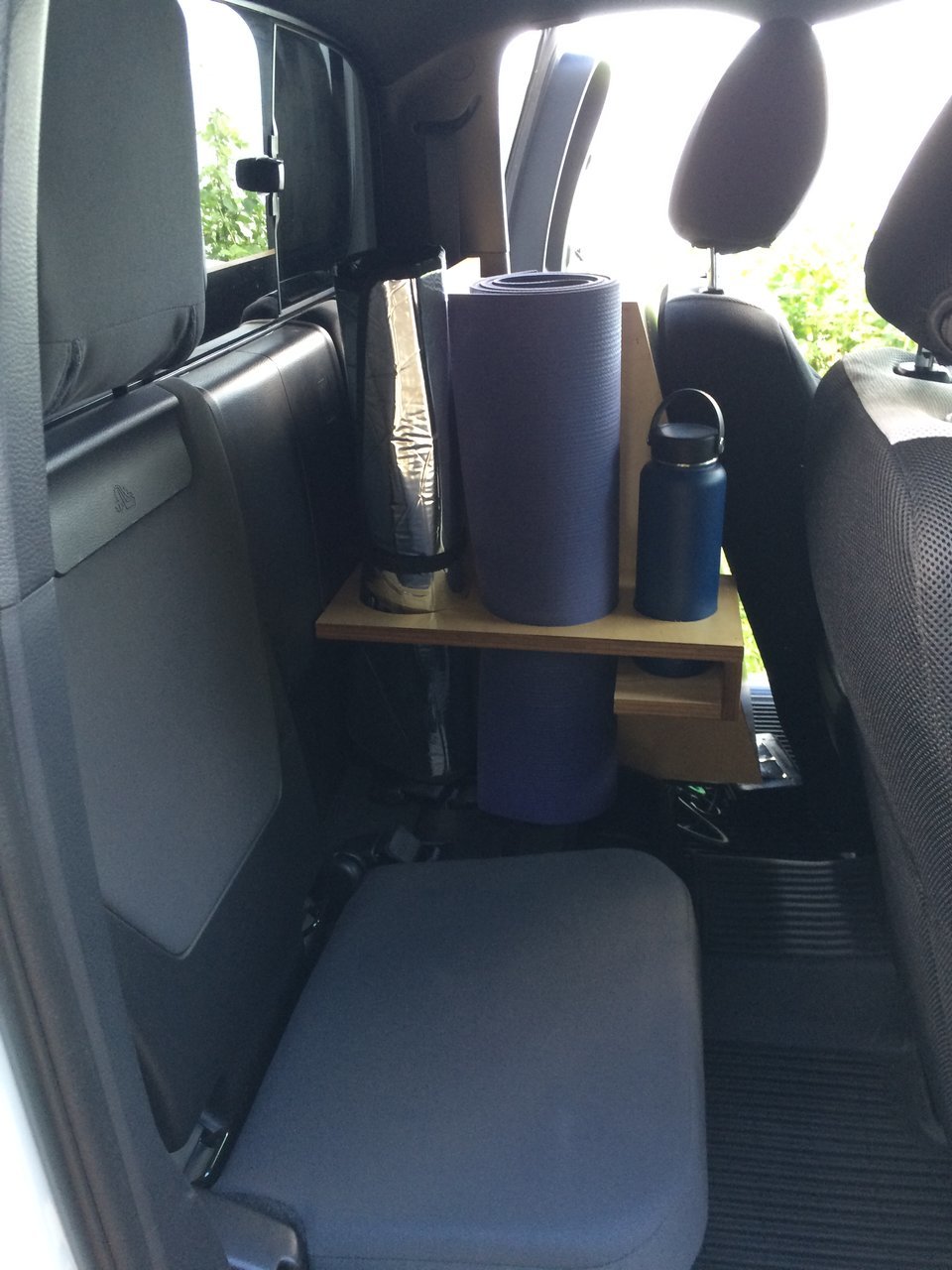

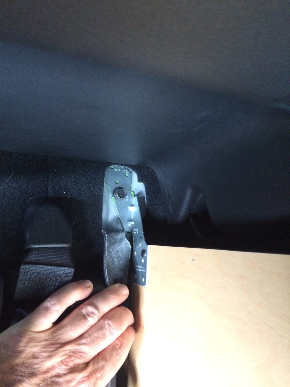

    Thank you OP for your detailed description for taking the back seat and headrest out.Great information that I put to use IMG_1567.jpgIMG_1559.jpg IMG_1540.jpg

    thanks for posting the pics. I’m hoping that you won’t mind me shamelessly copying your design.

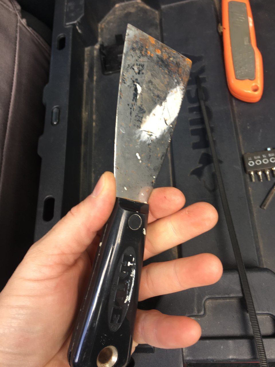

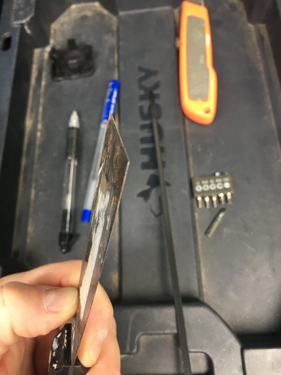

    C4B1C200-6B1C-457F-AF6D-5CF3CD157243.jpg Removed the driver side seat, both headrests and center cup holder from the back of my access cab 2019 TRD OR.
    My 2 contributions to this forum:
    1- I found a putty knife to be the best tool to pop the plastic tabs. NO Damage for me! After the first tab, note where the clips are and use the knife in between clips. See images.
    2- I weighed the pieces I removed- total savings 20 lbs!!!
    It was fairly easy, I only broke 3 red clips, and that’s because I was trying not to remove the back panel and just reach the headrest bolts from above. Worked for passenger side, but on doing the drivers I inadvertently popped the whole panel off and broke the bottom 3 clips. I spread out the remaining good ones between all three locations and upon reassemble I can’t even tell the difference between passenger and driver side.
